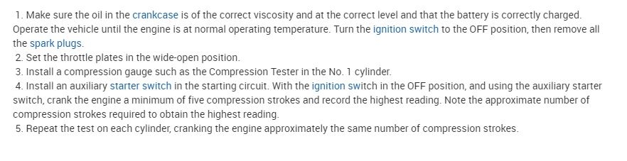

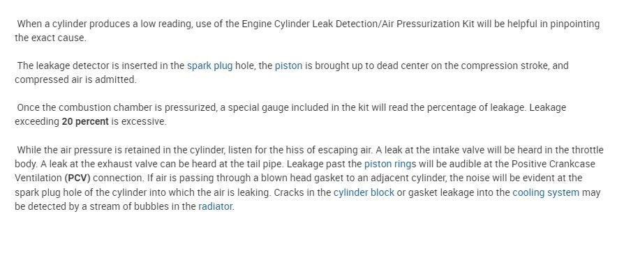

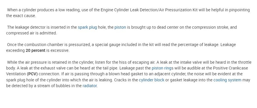

Did a leak down test via Ford scan app, which passed, will do actual compression test this week. 2 weeks ago it started rough, I changed the oil used Castrol edge high mileage.
Ran smooth, Did a 350 mile road trip ran great, 3 days later missing on cold star again smooths out when it comes off cold idle. Actual miles on vehicle 11,045. I'm thinking weak valve spring.
May 10, 2021 at 11:03 AM (Merged)
Valve spring would do it all the time. If you want to double check, do a running compression test. That will tell you if you have a bad valve spring.

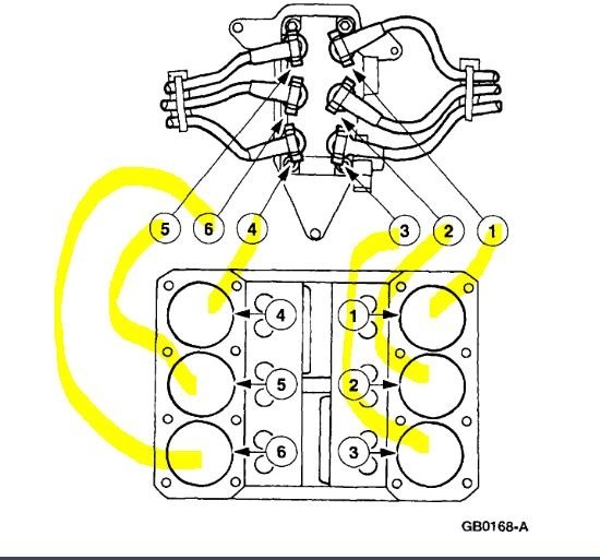

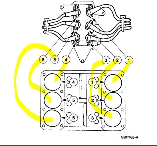

LISA B BUMPASS
Truck skipping and popping after plugs and wires changed.
May 10, 2021 at 11:15 AM (Merged)
Hi:
Either the wires were put on in the wrong order, or the plug gap was closed when installed.
check out these guides
https://www.2carpros.com/articles/engine-misfires-or-runs-rough
You will have to scan it for codes to see if anything like a sensor has gone out.
I would do a full tune up with coils this guide should help and check out the video below it.
https://youtu.be/e68QXyBAiZo
I attached a picture below. It shows the firing order and where each plug wire starts at the coil pack and which cylinder it goes to. Confirm they are correct.
Next, if that doesn't help, pull diagnostic trouble codes to see which cylinders are misfiring. If the wires are correct, then pull the plugs on the affected cylinders and check them.
One other thought, make sure the plug wires are properly routed. They can melt if against the exhaust manifold and that will cause a misfire as well.
Let me know if this helps and what you find.
