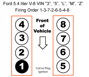

OBD says cylinders 7 and 8 are misfiring. I first need to switch 8 and 6 to determine if it's the plugs or the coils?
Apr 1, 2020 at 7:56 AM

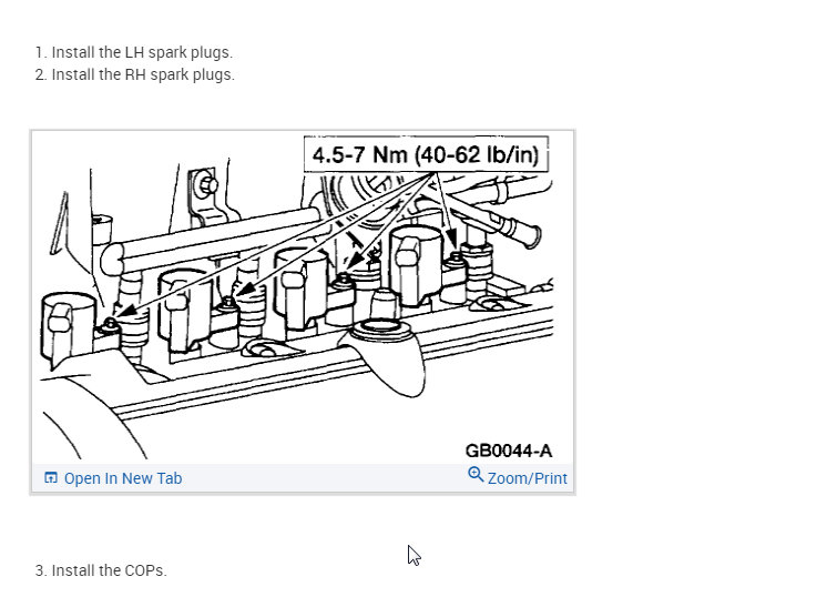

I would suggest switching the coils and plugs one at a time with a cylinder on the opposite bank just to make sure they swap sides. Due to these two cylinders being next to each other we cannot rule out a head gasket issue so we may need to do a compression check if the plugs, coils, or injectors are not the issue.
Here are guides on how to do these tests:
Let me know if you have questions or what you find and we can go from there. Thanks

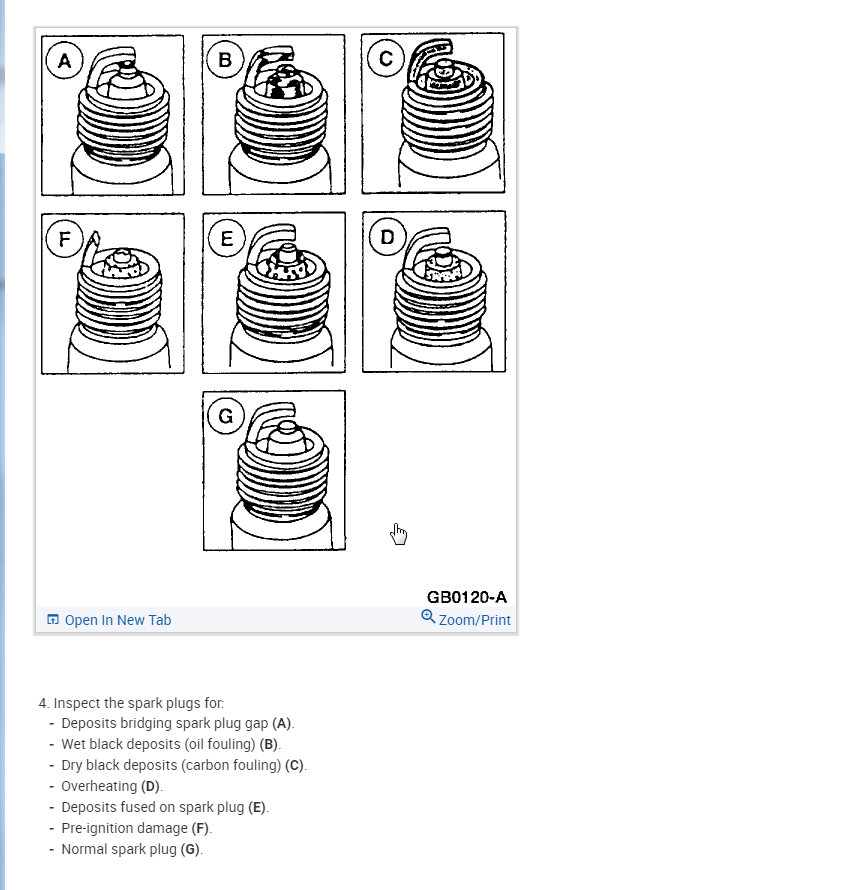

When you changed the plug and coil, did you replace the boot? And was the plug fouled?
Nov 12, 2020 at 8:55 AM (Merged)
GEOR2683
what do u mean by fouled plug? And the boot do u mean the piston?
MERLIN2021
  • 17,250 POSTS
By fouled, is the plug black? Wet? Melted electrode? Anything abnormal about it? Did you change all plugs or just #8? . Is it a single coil pack, or coil on plug system? Were the plug wires if coil pack all changed? Coil on plug, where the Boots under the coils changed? And can you feel the injector clicking with the engine running? You may need a fuel pressure and injector leakdown test.

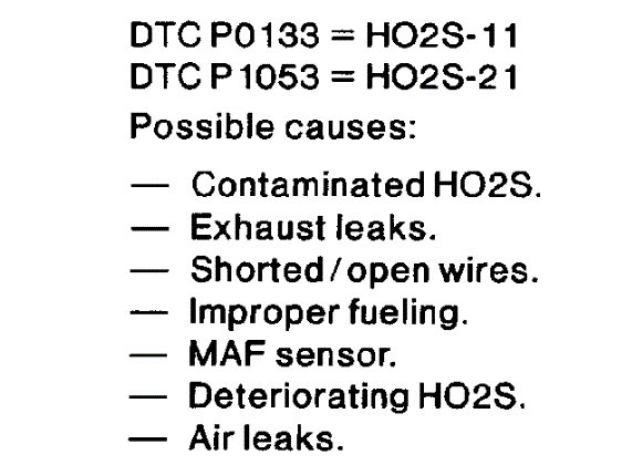

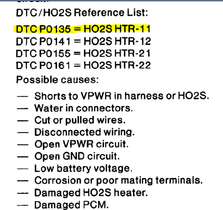

See pic 1 for P0133 possible causes. You are very possibly right with the exhaust leak. If you look at pic 2, it indicates possible causes of the P0135. That is different and not related to a power issue. I believe the two are related for the same reason, a lack of power. Check the connector for corrosion, damage, skinned wires, disconnected or pushed in pins or anything out of the ordinary.
Let me know what you find.
