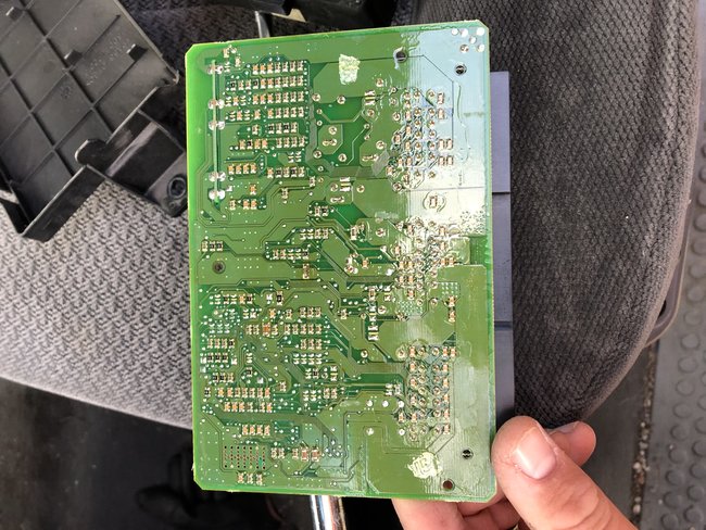

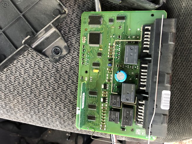

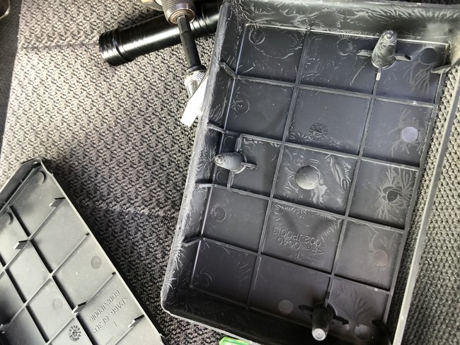

Okay, got the VSM out. What am I looking for with water damage? Seems to be some sort of discoloration on the cover.
Apr 11, 2020 at 4:35 PM
Okay, it does not look water damaged but that does not mean it is not good. You need special equipment to check it to see if it has failed.
Apr 11, 2020 at 4:44 PM
