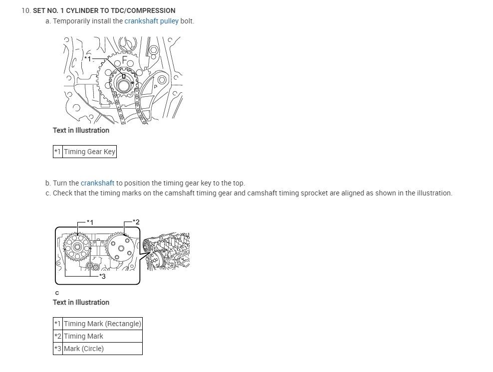

Valves are super clean. I checked the bores and also found no issues. Timing usually has some indications such as continuous rough idle not just morning or random misfires.

I attached the mark location for you to view.
I would check your marks to be sure and not assume they are correct.

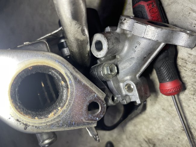

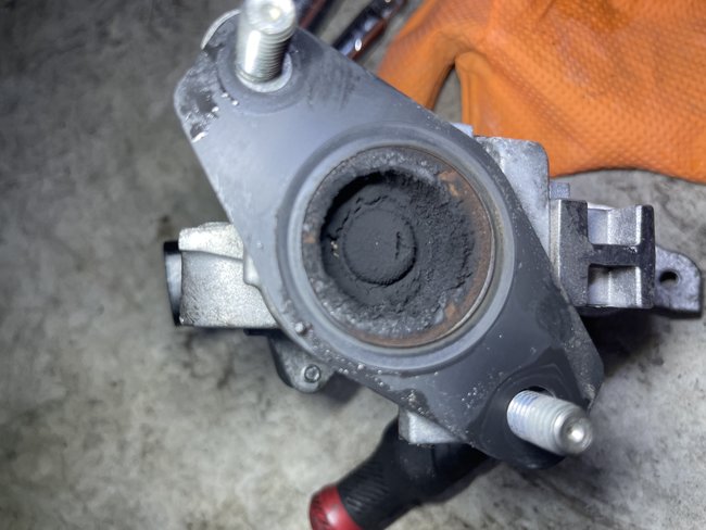

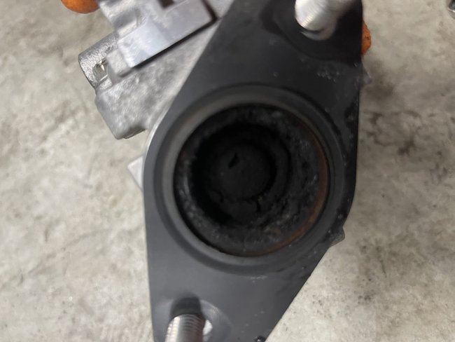

We checked the timing and it's perfect. We just removed the cooler and erg. Here are pictures of inside the erg and inside cooler, both have lots of build up.
Apr 6, 2022 at 10:39 AM
Wow, that is loaded with carbon. I would replace that valve and start with new.
