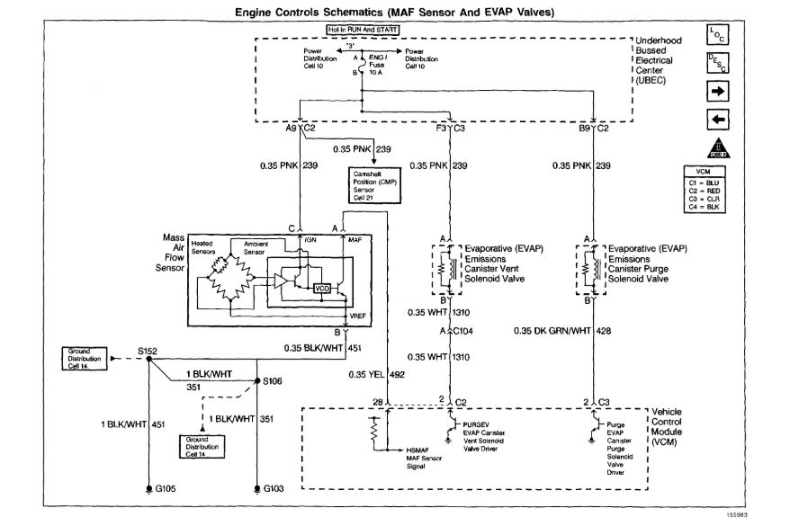

Does the pink wire have 12 volts as in the diagram I sent you?
Nov 8, 2018 at 1:45 PM
No, never had. All the book says is to check pin b and c for ignition voltage and if that is the 12 volts you were talking about, then it only shows 2 volts. Now the PCM on wire A and ground shows the 5 volts it is suppose to show but the other showed 2 volts and that was from the start of all of this.
Nov 8, 2018 at 2:07 PM
Ignition voltage is 12 volts.

Well I found out that I blew a 10a fuse and I am hoping that was the reason the scanner cannot pick up the MAF. Is there any way to test the MAF by itself?
Nov 8, 2018 at 2:47 PM
No, not without it hooked and the engine running.
You did not even have a problem with this sensor until you messed around and caused the fuse to blow.
