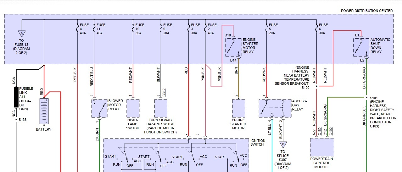

Check fuse no.2 40amp if okay disconnect clutch switch -jumper the clutch switch on top of the brake pedal and see what happens. See circuitry below

Battery has a full charge, both battery cables, good? Did you track the positive battery connections to follow the voltage. I haven't looked at your wiring, yet? There is always the wiring--fusible links--whatever.
Sep 26, 2020 at 12:33 PM (Merged)
SHEILAZ
  • 7 POSTS
battery good. battery terminal good. power good under the hood. no power going to interior fuse box and no fusible link
JDL
  • 16,098 POSTS

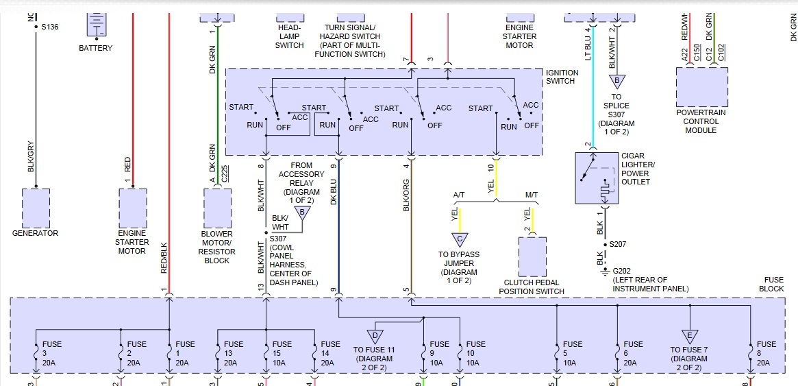

Just to add, you mentioned ignition switch, note the wiring. The wires going into ignition switch at the top are hot all the time. One wire is red, the other is pink with a black tracer, check for voltage.
The wires coming off the bottom of switch in the diagram go hot with the ignition switch in various positions, start--run--acc--whatever. Note the wire colors, check for voltage.

I disconnected plug from ignition switch, pink wire with black stripe is the only one that has power
JDL
  • 16,098 POSTS
The info I looked at was for jeep wrangler sport. for voltage on red wire, check fuse 3--30amp, underhood power distribution center. Not only check the fuse, check for voltage on the fuse circuit.
