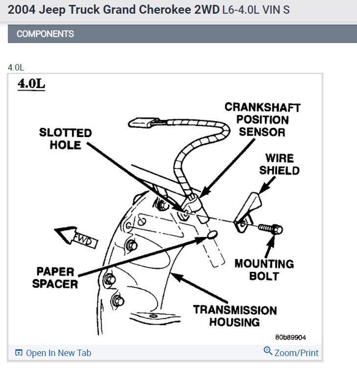

this sounds like he same thing that happened to my car i had to replace the crankshaft angle sensor here is show in the diagrams below also this guide can help others
https://www.2carpros.com/articles/engine-stalls
Check out the diagrams (Below). Please let us know what happens.
