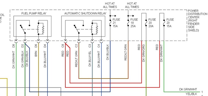

Started and stopped running within a few seconds. Can't hear the fuel pump run when I turn the key before attempting to start it. Is there a fuel pump relay? Could that be the problem? Or should I try replacing the fuel pump? I have had crank position sensor problems on my previous 2 Jeeps, but I don't remember if the fuel pump ran when I had the crank sensor problems. Any Ideas?
Sep 26, 2009 at 8:10 PM
RASMATAZ
  • 75,992 POSTS

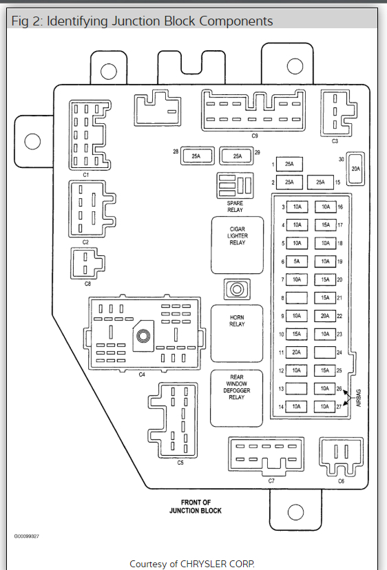

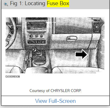

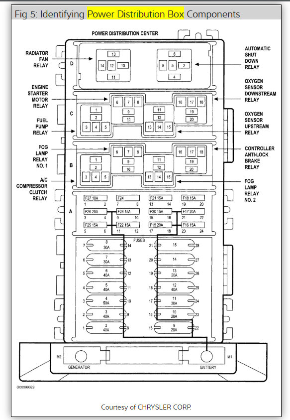

The relay is located under the hood here is a guide to help you test it and the location in the diagrams below.
Check and test the fuse no.22 15 amp and fuel pump relay.
Sep 26, 2009 at 8:27 PM

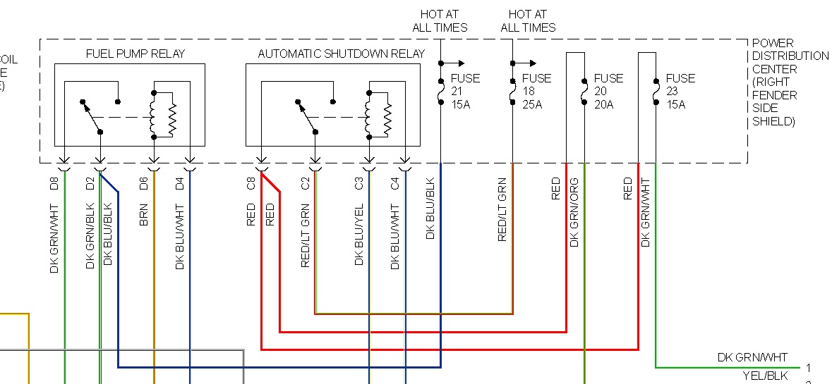

There would be two voltage circuits at the fuel pump relay. One for the circuit/load side of relay, one for the coil/control side of relay. Both circuits are fuse protected. Voltage for the control side of relay, goes hot with key on. Voltage to circuit side of relay, is hot all the time. But, unless the relay is energized, that voltage on the circuit side doesn't go anywhere. When the relay is energized, that line with the arrowhead on it, moves to the other terminal.
Engine cranking, do you have any spark at the plugs. If the computer doesn't see the proper cam and crank signal during cranking, you may not have fuel pump action or spark at the plugs or injector pulse. Any applicable trouble codes?
