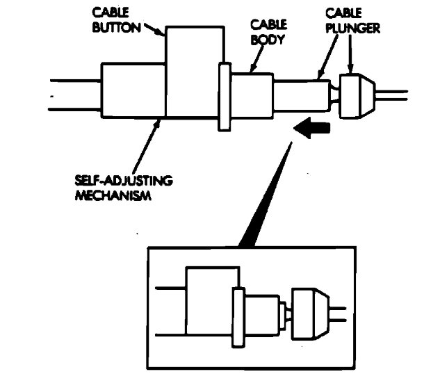

Good morning,
There is a cable on the throttle body that controls shift points.
It is attached to the throttle valve in the valve body. it is adjustable. I would check to be sure it is not disconnected first. if it is connected, try adjusting the cable back and forth to see if it shifts.

5. Install drain plug and fill transmission with fluid to appropriate level, then adjust cable as follows:
a. Turn ignition switch to Off position and fully retract cable plunger, then press cable button all the way down and cable plunger inward, Fig. 18.
b. Rotate primary throttle lever to wide open throttle position and hold while allowing cable plunger extend. Release lever when plunger is fully extended.
