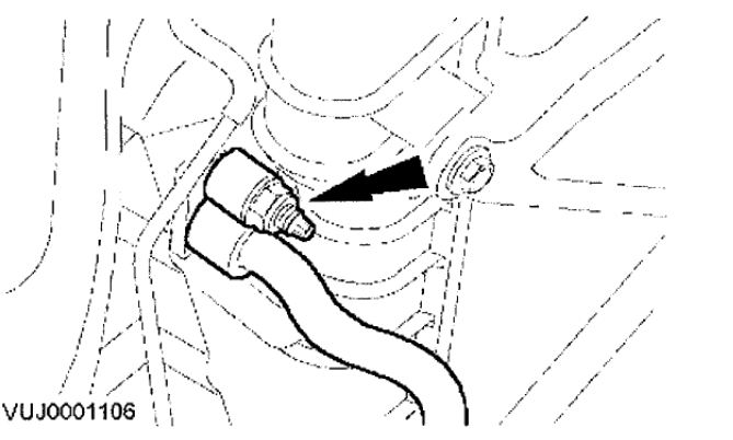

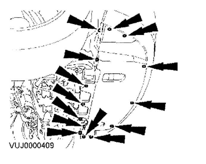

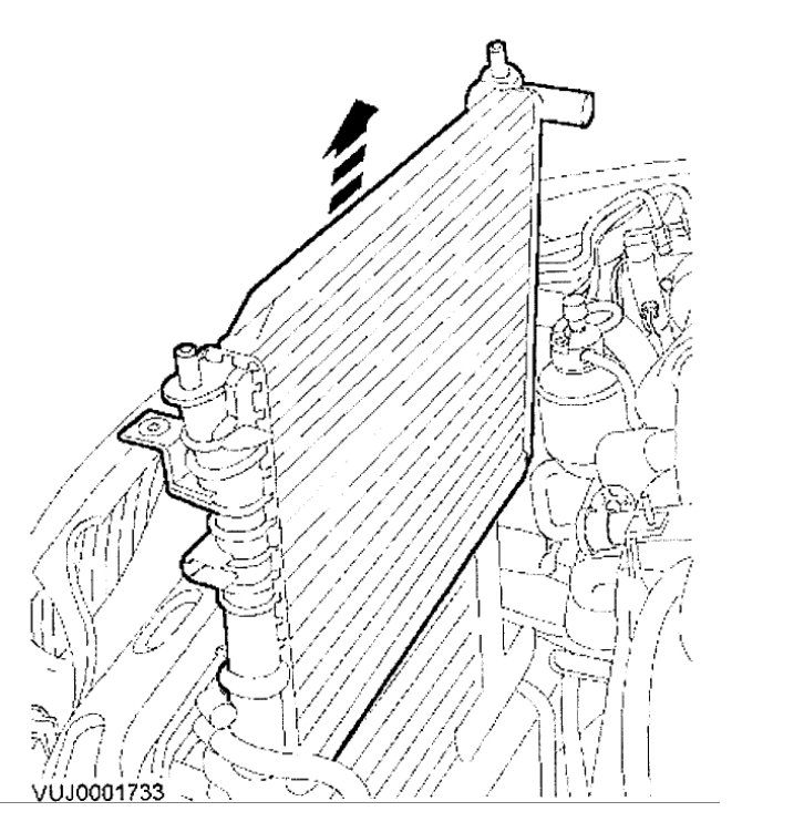

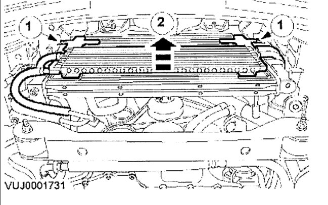

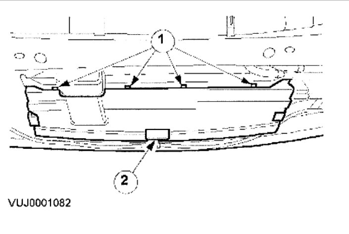

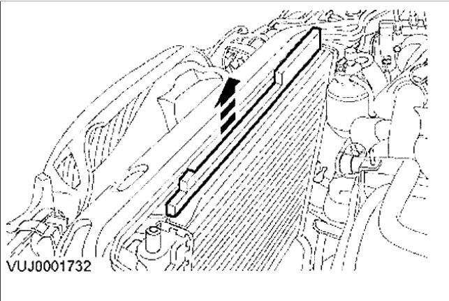

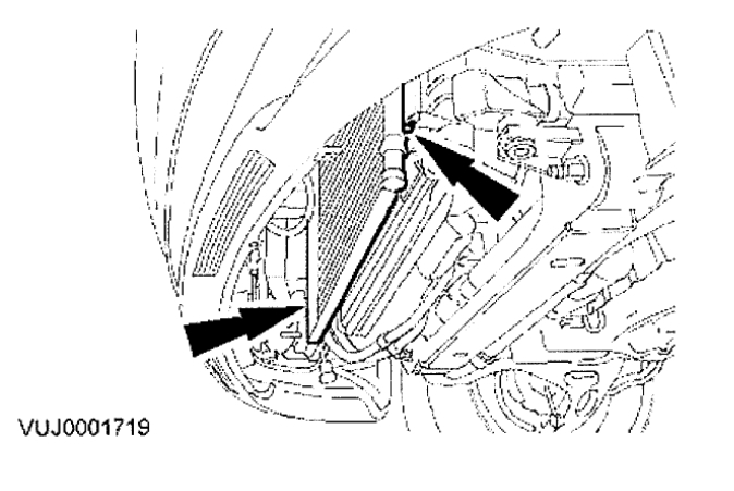

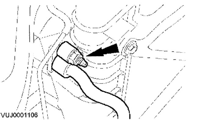

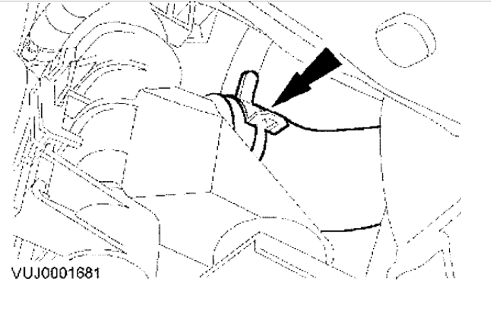

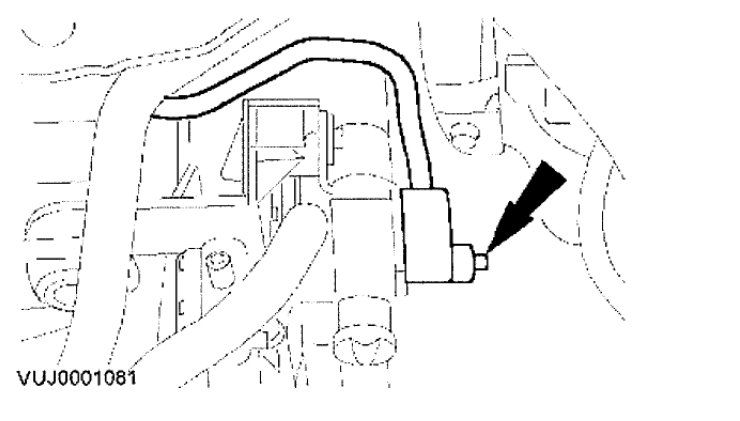

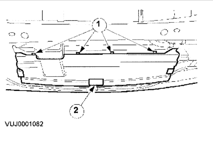

Yep it looks like you will need to drain the air conditioner and recharge it when completed. Here are some guides for that.
Coolant has a stronger smell when it is hotter, that is probably why you smell it.
Here are the diagrams you need to get going on the repair (below)
Let us know
