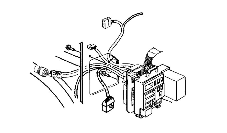

So I’ve got power on the orange wire from A7 on the fuse block all the way to D3 on the front of the convenience center. Does the convenience center come out? Is it difficult? I assume C is where the orange comes out of the back and goes to the door harness?
Correct.
Yes, it does. This might be the one that is held in by clips or tabs.
You would need a thin flat blade screw driver to depress the tabs. They should be on the corners.

Started to try and pull out the convenience center but even after lifting the tabs, it felt like I was going to break it pulling it out. I seriously used some force and it just pulled on the firewall. So I decided not to risk it and I run a jumper wire from D3 orange wire on the front plug of the CC to where the orange wire is behind the hood latch handle, before it goes into the door. This not only made the locks work again, but also the electric seats too! I couldn’t have done any of it without your help Roy. The schematic/diagrams were absolutely invaluable!!! Thank you!
