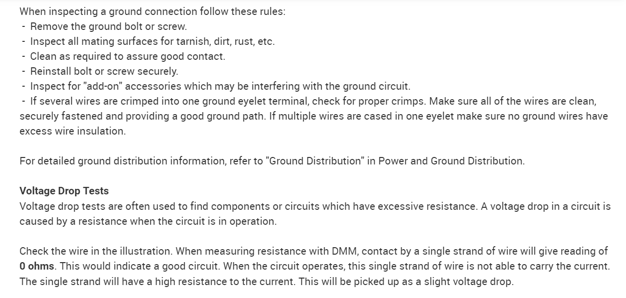

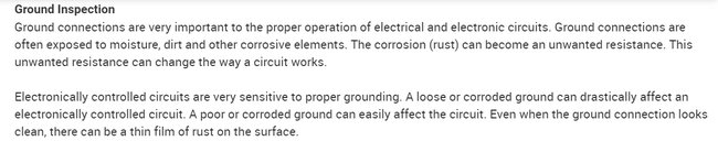

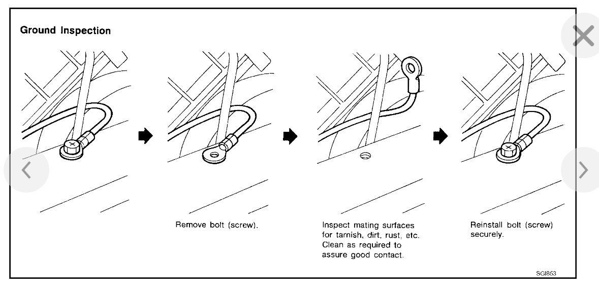

Hello again,

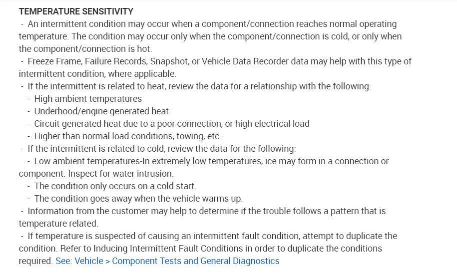

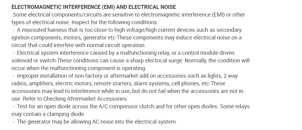

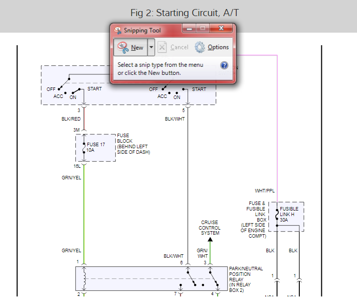

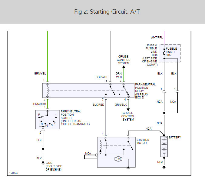

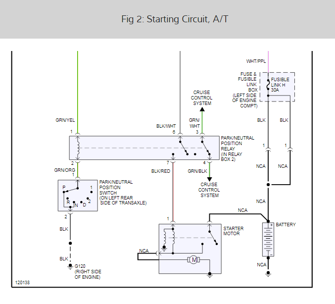

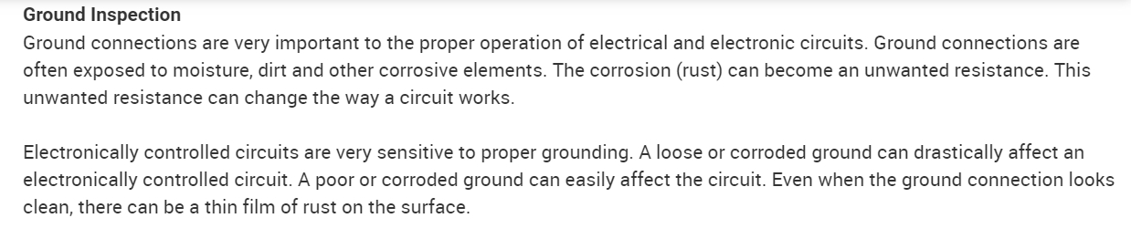

In the diagrams down below I have included a wiring diagram for your vehicle's starting system. I have also included guides on how to find intermittent electrical faults and how to inspect grounds. If you could could you please inspect Ground #120, which is located on the right side of the engine. Please get back to us with what you are able to find out.
Thanks,
Alex
2CarPros
Thanks,
Alex
2CarPros
Oct 18, 2019 at 3:42 PM
(Merged)
Thank you for the diagrams. Yes, I have checked all wiring and connections the last time the car stopped and I checked everything again yesterday. Still nothing. All the dash lights come on but that's it. I just don't understand why the car does this. There has to be a way to fix this. Do you have any more suggestions I might try out? Thank you

Hello again,
Did you check Ground #120 on the right side of the engine yet? This ground is responsible for grounding the neutral safety switch, which if not working, will not allow your vehicle to start. Please get back to us with what you are able to find out and we can go from there.
Thanks,
Alex
2Carpros
Thanks,
Alex
2Carpros
(Merged)
Yes no corrosion good connection.

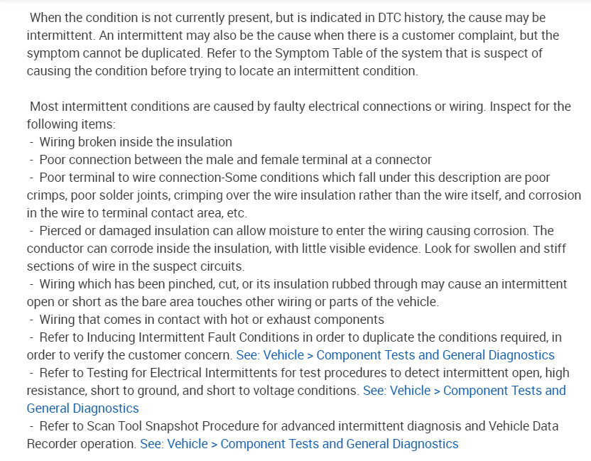

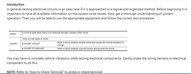

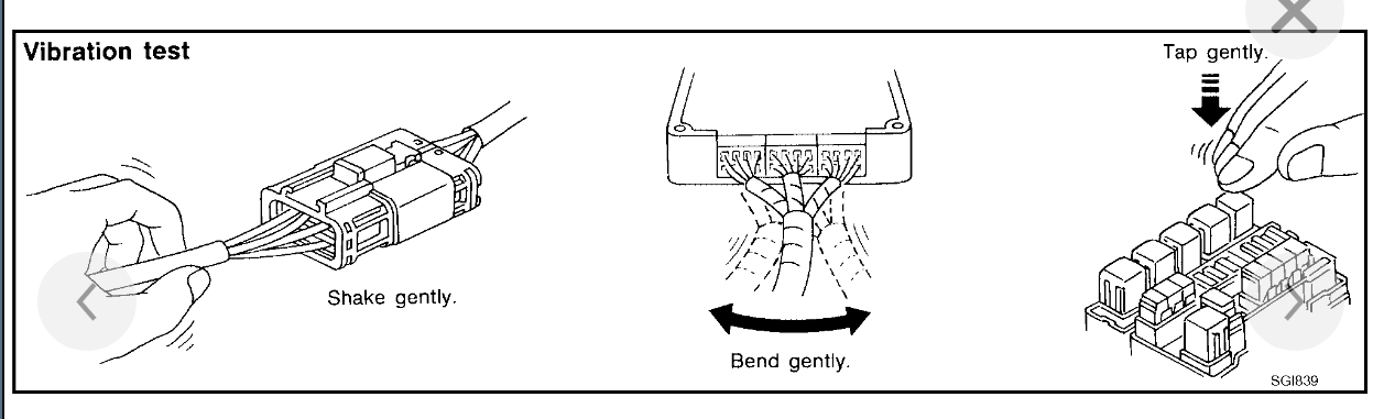

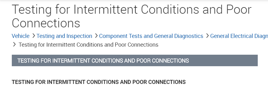

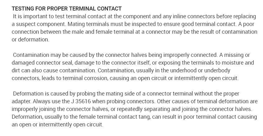

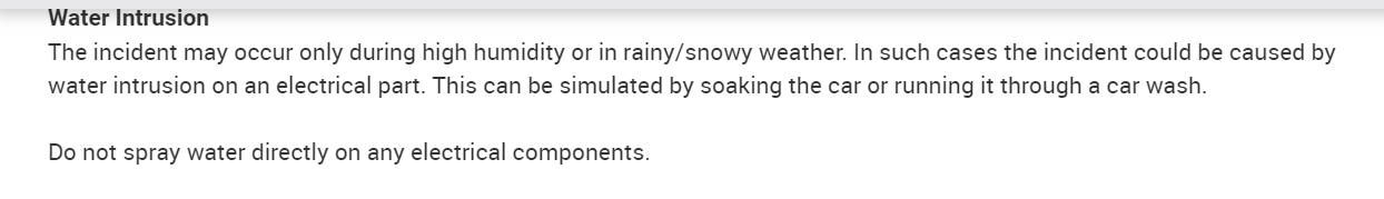

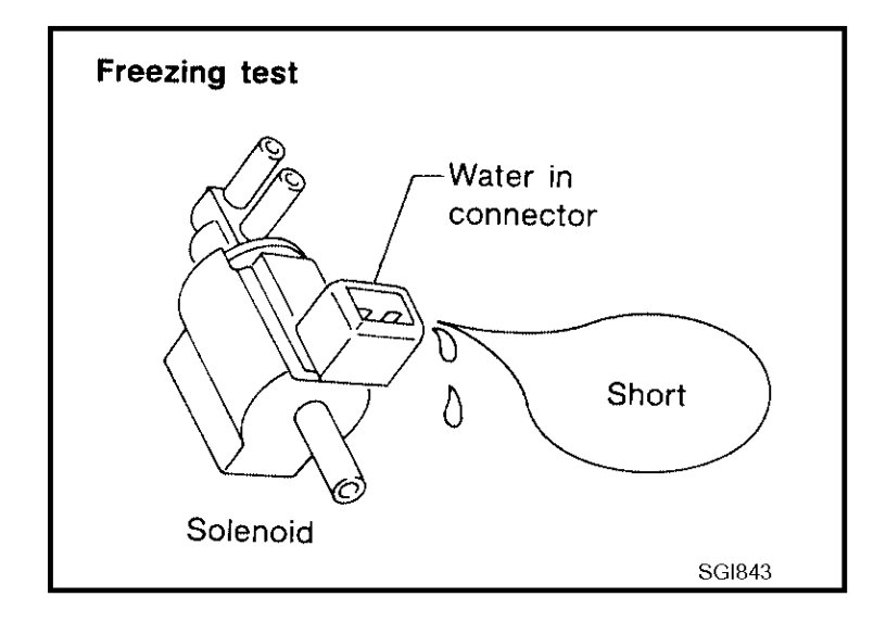

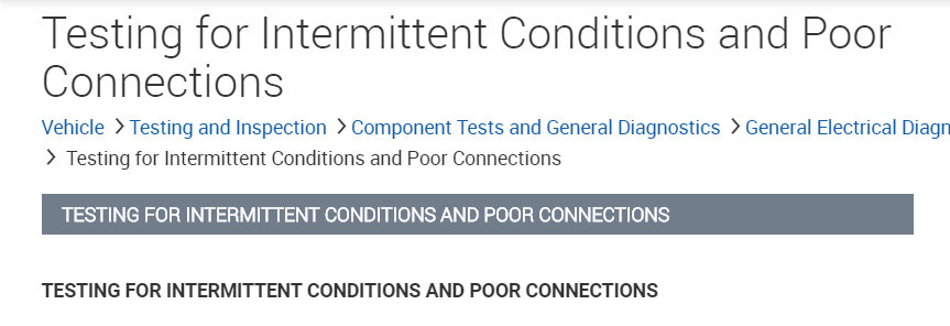

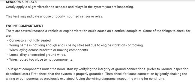

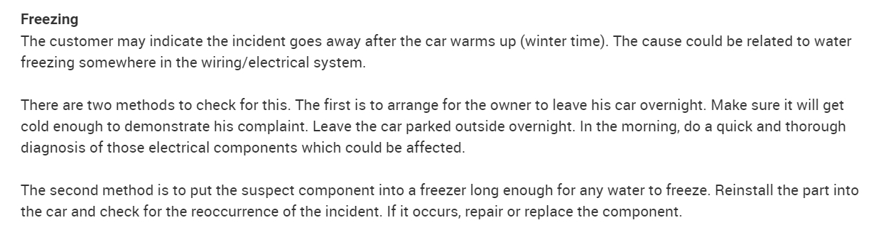

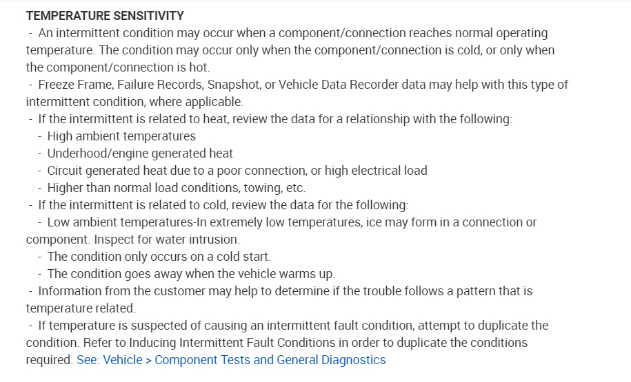

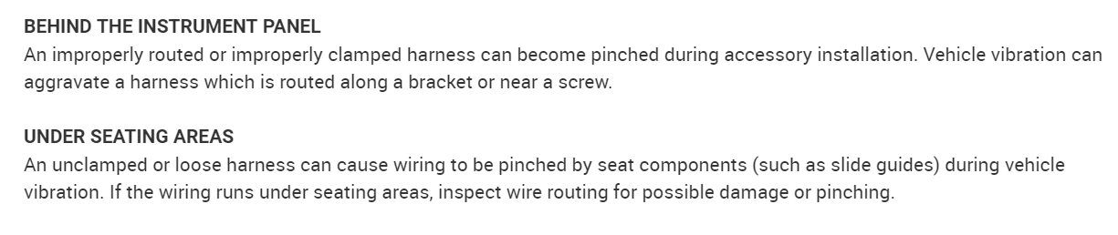

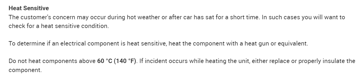

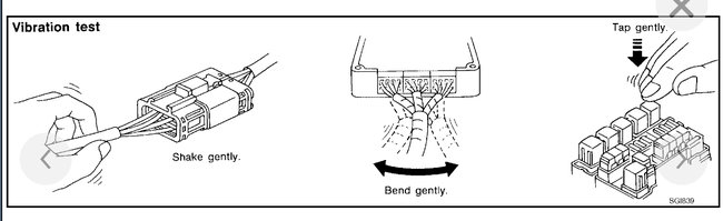

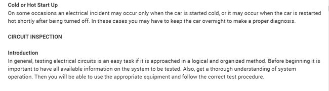

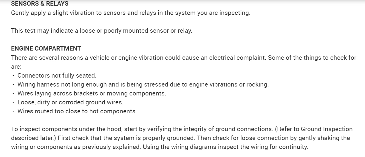

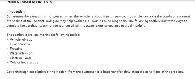

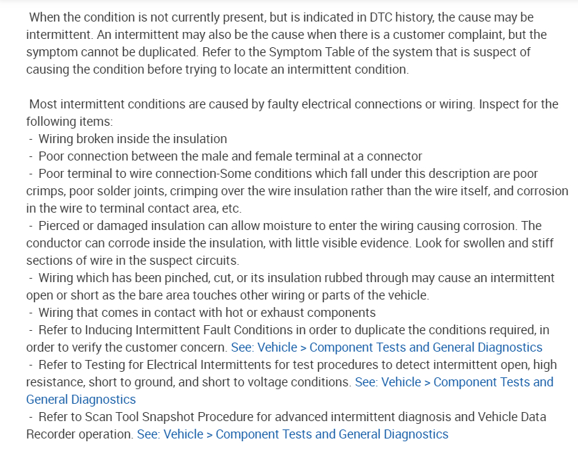

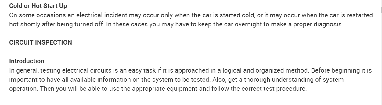

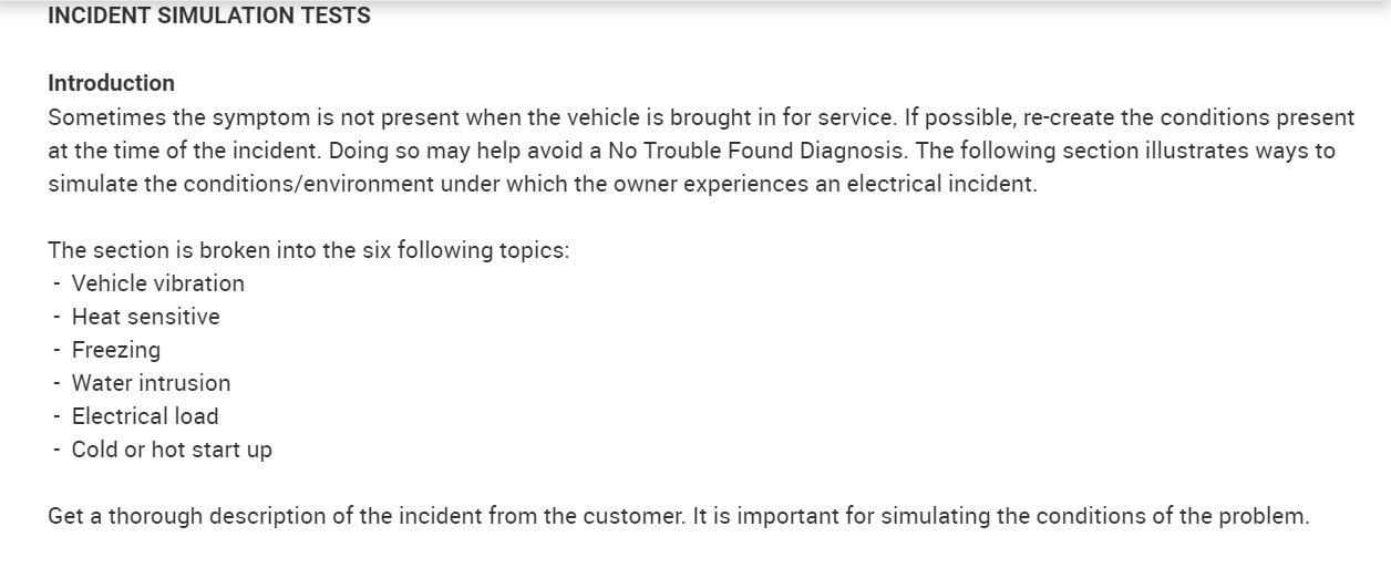

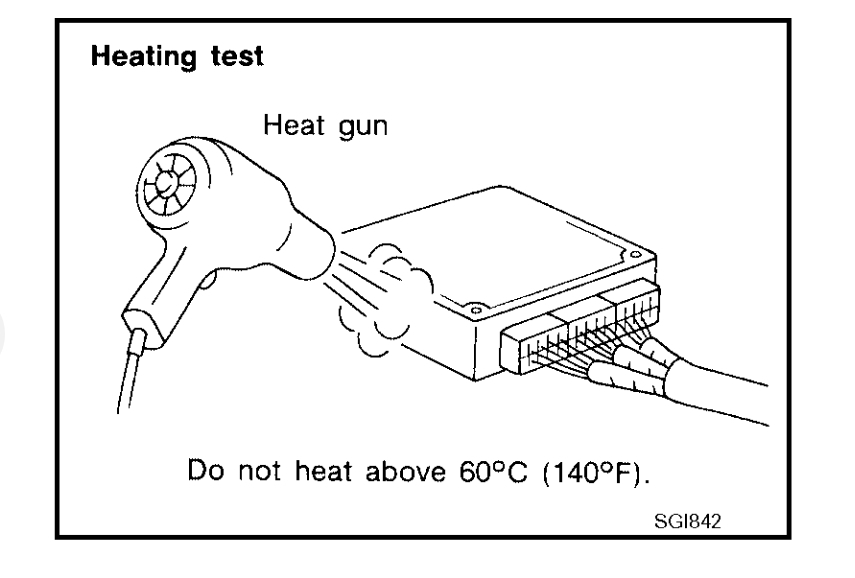

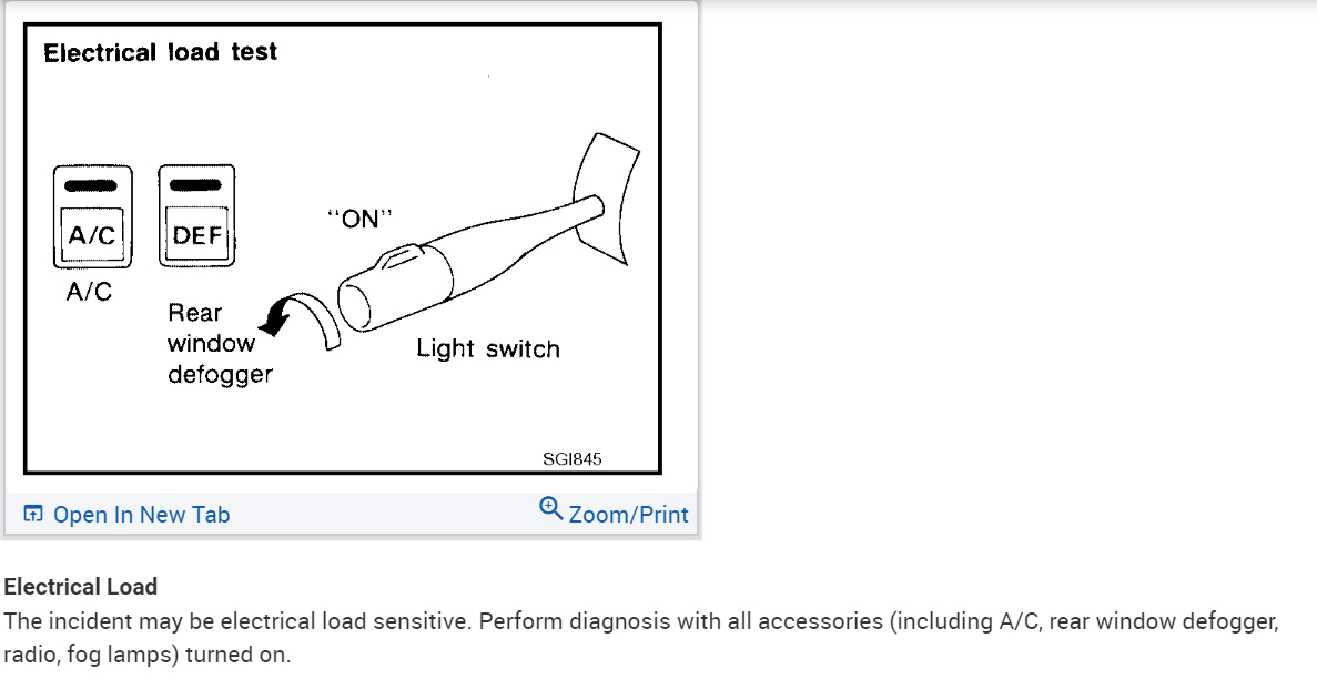

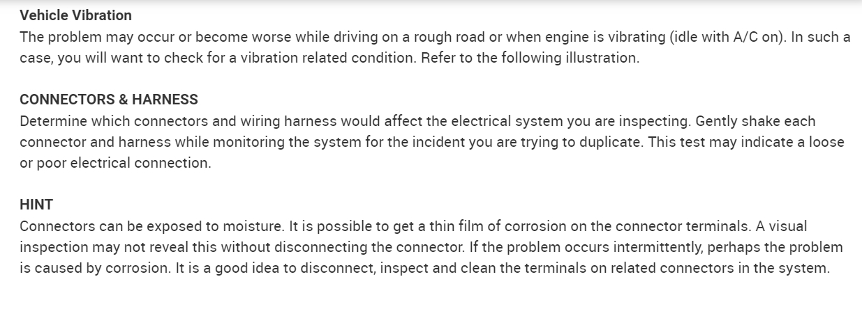

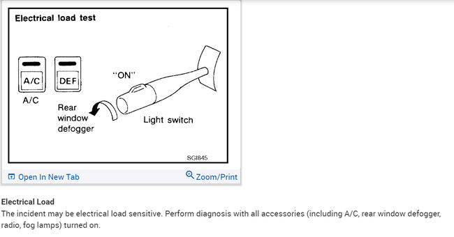

Hello again,
Intermittent electrical issues are probably the most frustrating thing you will have to deal with with a vehicle. The problem is that the problem never rears it's head when someone is doing diagnostics on it. Okay, you have the complete starting circuit for your vehicle in the two wiring diagrams I sent you earlier. In the diagrams down below I have sent you a guide with how to track down an intermittent condition in an electrical circuit. Please go through the guide and apply it to your vehicle's starting circuit and get back to us with what you are able to find out.
Thanks,
Alex
2CarPros
Thanks,
Alex
2CarPros
(Merged)
Thank you for the diagrams. I checked everything possible with no luck. I hope one of these days the car will start like it did before. Like I said before I have no idea what causes this and how to prevent it from happening again. I know there can't be much more to do and I can't afford to take it to the dealer at this time. I thank you guys for all your help. I will continue to check this, that, and the other.

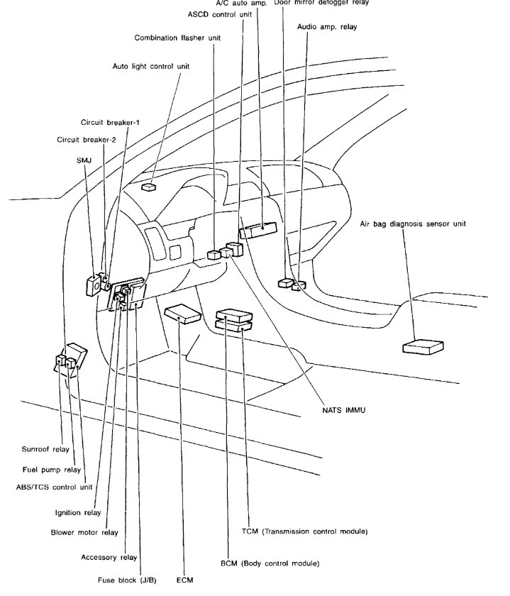

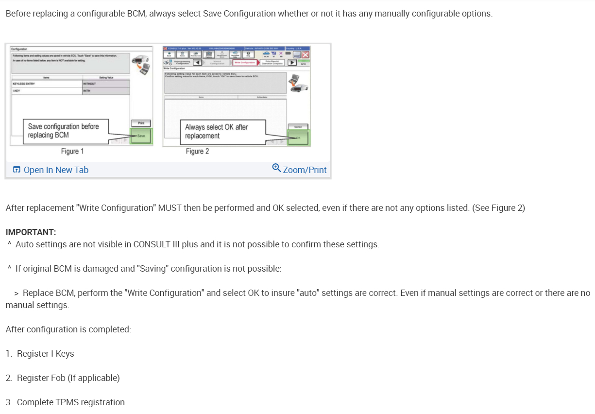

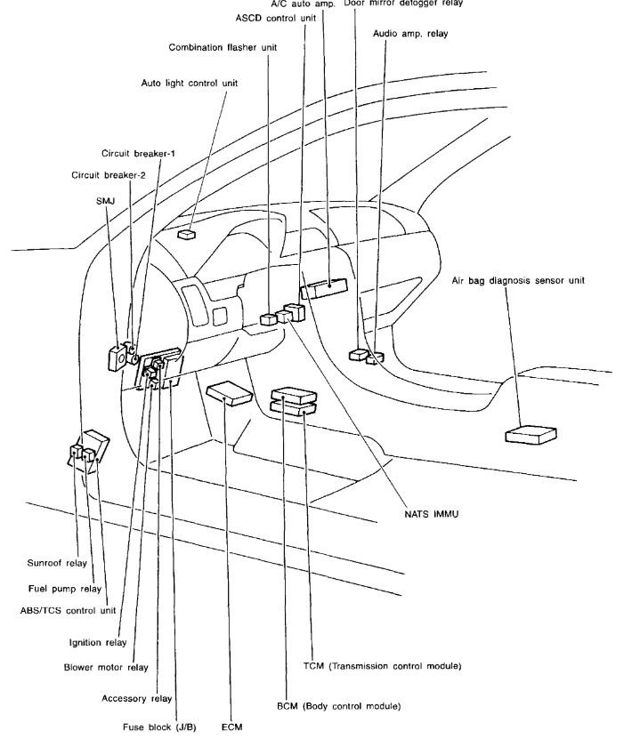

I've got another issue. As I was unscrewing the last screw to take the cover off the steering column this loud buzzing sound came out of the speakers and wouldn't stop. I put the key in and turned it to all positions and it only stopped when it was in the start position. I disconnected the battery and continued with the cover. I took the radio fuse out and reconnected the battery and checked all the connection. Everything checked out fine. I put the fuse back in and turned on the radio but nothing came out of the speakers.
What do you think has happened?
(Merged)

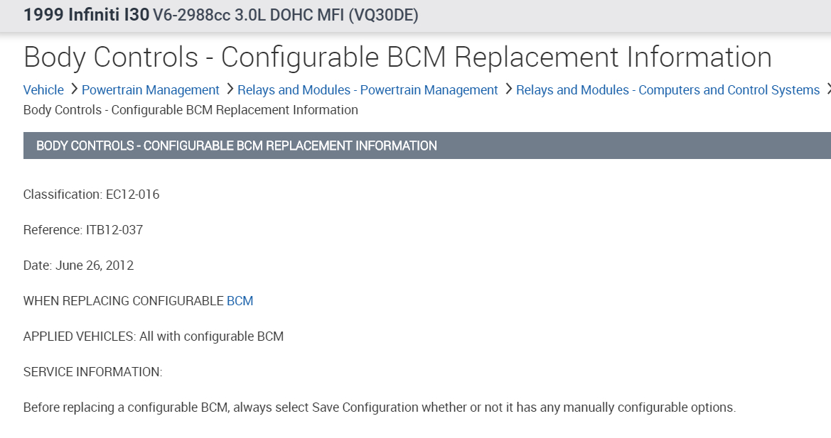

It sounds like the BCM has shorted out. To be sure we need to do a CAN scan. Here is a video that shows how to do it with instructions in the diagrams below to help show you how the change out the BCM and its location:
https://youtu.be/InIlnsjOVFA
Remove the electrical connector from the BCM to check for corrosion. Check out the diagrams (below). Please let us know what happens.

Thanks for the information. No corrosion. As far as the can scan goes I just can't afford to rent a scanner at this time, but as soon as I can I will. Thank you anyway guys.
