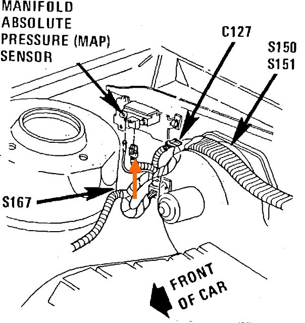

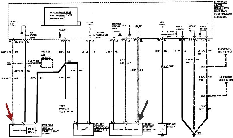

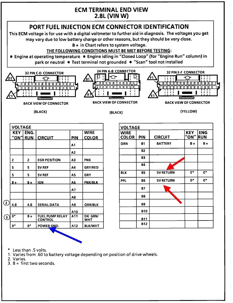

Most sensors, the first two in this list in this case, are fed with ground and 5.0 volts from the Engine Computer, then they develop a signal voltage between those two voltages. There's mechanical stops inside the throttle position sensor that limit the range of its signal voltage to roughly 0.5 to 4.5 volts. Only a circuit defect can let the signal voltage go outside that range. Doing so is what the computer sees to detect that problem, and set the appropriate diagnostic fault code. I would concentrate on the first two fault codes as they're pretty easy to diagnose.
Code 35 is misleading. That part is the "idle air control motor", not sensor. You may have inadvertently set that code if the ignition switch was turned on while that motor was disconnected.
To set code 45 requires a properly-working oxygen sensor. The Engine Computer likely reverted to a back-up strategy once the first two codes were set. They can't let the system run lean in that back-up mode as that would lead to stumbling and hesitations. When running too rich, engine performance will still feel acceptable.

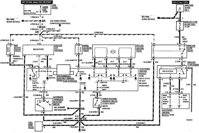

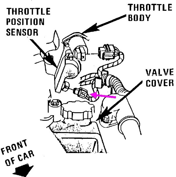

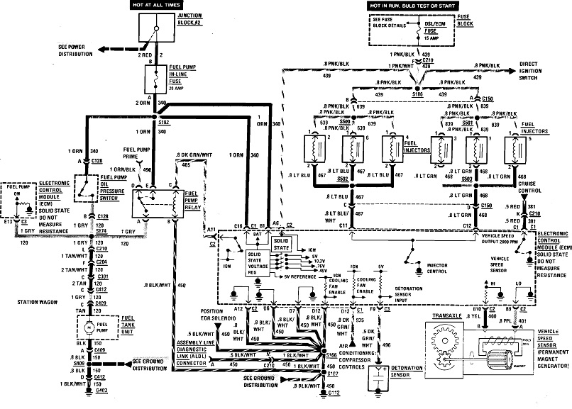

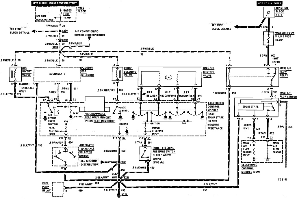

These three diagrams cover most of your engine controls. If you have trouble seeing them, I can cut them into pieces that I can enlarge for you. In particular, look at the two arrows I added in the second diagram. The red arrow is pointing to the 5.0-volt supply to the MAP sensor, and the gray arrow is pointing to the 5.0-volt supply to the TPS. Normally they use just one wire to supply multiple sensors, so when you're getting multiple "low voltage" fault codes, it's related to that one wire. Here they're using a separate wire for each sensor, but they still all originate from a single regulator circuit inside the computer. My suspicion is you're going to find one of these wires is shorted to ground, or both of them are open, meaning they have a break in them.
The TPS is the easiest to get to. It's on the side of the throttle body. To be valid and accurate, these readings have to be taken with the sensors plugged in. You can stick the meter's probe through the rubber seal around the wires.

Let me know what you find on these two wires.

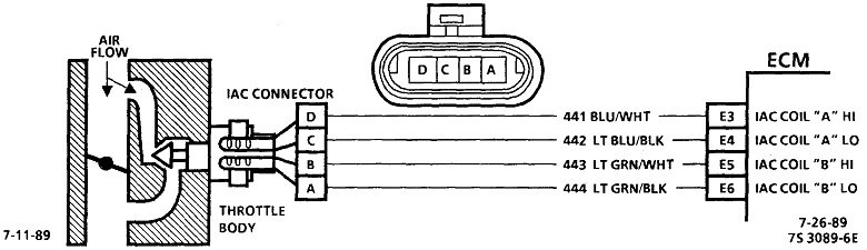

Probably the last suspect would be the idle speed motor itself. They have four electromagnetic coils of wire inside, and those wires are pretty substantial and not prone to breaking.
The system can be tested with a scanner, under the "IAC Test" or "idle speed test". That allows you to command the computer to raise engine speed to as much as 2,000 rpm in 100-rpm increments. If engine speed responds accordingly, the system is working.

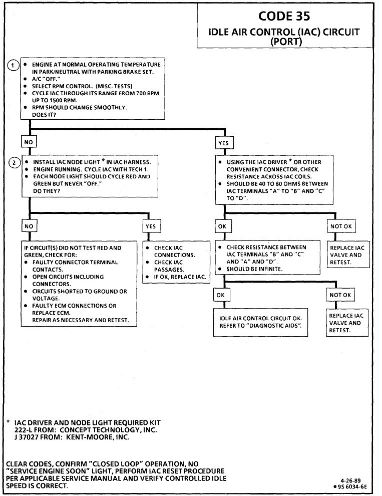

Here's GM's diagnostic steps for code 35:
CIRCUIT DESCRIPTION
Code 35 will set when the closed throttle engine speed is 300 rpm above or below the desired (commanded) idle speed for 50 seconds. Review the "Description and Operation" of the Idle Air Control (IAC) Valve operation in "Idle Speed / Throttle Control - Electronic"
TEST DESCRIPTION
Numbers below refer to circled numbers on the diagnostic chart.
1. The Tech 1 rpm control mode is used to extend and retract the IAC valve. The valve should move smoothly within the specified range. If the idle speed is commanded (IAC extended) too low (below 700 rpm), the engine may stall. This may be normal and would not indicate a problem. Retracting the IAC beyond its controlled range (above 1500 rpm) will cause a delay before the rpm's start dropping. This too is normal.
2. This test uses the Tech 1 to command the IAC controlled idle speed. The Electronic Control Solenoid (ECM) issues commands to obtain commended idle speed. The node lights each should flash red and green to indicate a good circuit as the ECM issues commands. While the sequence of color is not important if either light is "OFF" or does not flash red and green, check the circuits for faults, beginning with poor terminal contacts.
DIAGNOSTIC AIDS
A slow, unstable, or fast idle may be caused by a non-IAC system problem that cannot be overcome by the IAC valve. Out of control range IAC "Scan" tool counts will be above 60 if idle is too low, and zero counts if idle is too high. If idle speed is above 600-700 rpm in drive with an A/T, locate and correct vacuum leak. If rpm is below specifications, check for foreign material around throttle plates. Refer to Fuel Delivery and Air Induction / Throttle Body.
The following checks should be made to repair a non-IAC system problem:
Vacuum Leak (High Idle)
If idle is too high, Stop the engine. Fully extend (low) IAC with tester. Start engine. If idle speed is above 800 rpm, locate and correct vacuum leak including PCV system. Also check for binding of throttle blade or linkage.
System Too Lean (High Air/Fuel Ratio)
The idle speed may be too high or too low. Engine speed may vary up and down and disconnecting the IAC valve does not help. Code 44 may be set. "Scan" Oxygen (O2) voltage will be less than 300 mV (0.3 volt). Check for low regulated fuel pressure, water in the fuel or a restricted injector.
System Too Rich (Low Air/Fuel Ratio)
The idle speed will be too low. "Scan" tool IAC counts will usually be above 80. System is obviously rich and may exhibit black smoke in exhaust. "Scan" tool O2 voltage will be fixed above 800 mV (.8 volt). Check for high fuel pressure, leaking or sticking, injector. Silicone contaminated O2 sensors "Scan" voltage will be slow to respond.
Throttle Body
Remove IAC valve and inspect bore for foreign material.
IAC Valve Electrical Connections
IAC valve connections should be carefully checked for proper contact.
PCV Valve
An incorrect or faulty Positive Crankcase Ventilation (PCV) valve may result in an incorrect idle speed.
A/C compressor or relay failure
See C-Charts Component Testing / Chart C-10A if the A/C control relay drive circuit is shorted to ground or if the relay is faulty, an idle problem may exist. See: A L L Diagnostic Trouble Codes ( DTC ) > Related Tests, Information and Procedures > Chart C-10A A/C Clutch Control
If intermittent poor driveability or idle symptoms are resolved by disconnecting the IAC, carefully recheck connections, valve terminal resistance, or replace IAC.
Refer to Diagnosis by Symptom / Rough Idle or Stalling. See: Computers and Control Systems > Symptom Related Diagnostic Procedures > Rough, Unstable, or Incorrect Idle, Stalling

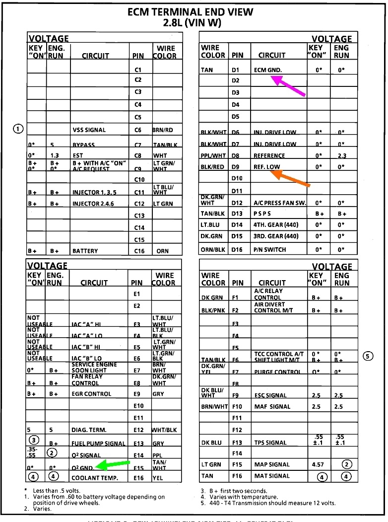

Here's the diagrams for the plugs for your Engine Computer. I found five ground wires here, but they aren't necessarily two for each circuit. For example, they use a separate wire for the oxygen sensor, (green arrow in the second diagram), probably for the same reason as a slight voltage interference from other circuits would adversely affect the O2 sensor's readings. "Reference" or "reference low" are designations for ground wires.
Do not waste your time trying to use an ohm meter to check these wires. All it takes is one tiny strand still intact to get a good reading that way. Instead, the voltage on these wires must be measured while the engine is running. That's when current flows through them and is when any excessive or undesirable resistance shows up as a "voltage drop". Put the voltmeter on its lowest range. Sometimes the voltage readings will jump around a few hundredths of a volt due to stray magnetic interference, but typically those readings will be obviously too high when there's a problem in one of the wires.

35 - Idle air control sensor circuit fault
64 - Oxygen sensor right side lean exhaust indicated
Here's what we have listed for those code numbers: Code 35 is to be expected. The computer saw the break in the wiring when the idle speed motor was unplugged. As I mentioned earlier, these two-digit fault codes don't get very specific. They're only supposed to tell you which circuit you need to diagnose. They don't actually include a diagnosis.
When the engine starts, you'll notice engine speed goes real high, as in 1500 rpm, for a few seconds. That's called "idle flare-up". That lasts a lot longer on Fords and on newer vehicles, but on older GM and Chrysler products, it comes back down to normal idle speed within a few seconds. To accomplish that, the computer retracts the valve in the idle speed motor after the engine is stopped. Some models do that the instant the engine is stopped, and others do that when the ignition switch is turned on, just before cranking. It sounds like yours does that when the engine is stopped,. Once the valve is retracted to allow additional air to bypass the throttle blade, it can't extend to close that passage when you have it unplugged. Once the computer sees the wiring is disconnected, it will stop trying to adjust idle speed, but it can resume trying when the motor is plugged back in.

It's hard to know where to look without having scanner data to look at. This is exactly the problem cars would have had if it wasn't for the diagnostic fault codes to get us started. It's much worse on '96 and newer models. You could spend weeks checking each circuit if there weren't fault codes to tell you where to look.
The only other thing I can suggest is to remove the idle speed motor, or get a good used one from a salvage yard, and plug it in while it's laying out where you can watch it. Don't run the engine with the valve out as this will create a huge vacuum leak, but when a helper turns the ignition switch on, you should see that pintle valve retract. It should extend fully when the ignition switch is turned off.
There is nothing in the system to tell the computer where the idle speed motor is set, or adjusted to, other than it knows engine speed. Referring back to Chrysler's numbering system that I'm familiar with, lets say the computer sets the motor at step 50 in preparation for the next engine start. Once that is done, if you come along and tug on that valve fairly hard, you will be able to pull it out or squeeze it back in. The physical step position will have changed, but as far as the computer is concerned, it still assumes it is at step 50. Besides you moving the valve manually, the armature could be sluggish, or it might have even vibrated to some other step. Regardless of how it happened, it is out of sync with the computer. To prevent that, on every one of these I've played with, the computer runs that valve all the way out to step "0", then pulses it some more in case it didn't have time to get there. At that point it knows that valve has to be at step "0". From there it retracts it to, in my story, step "50", then sits there and waits until you want to start the engine. What you should see when you turn the ignition switch off is that valve will extend a lot, then retract part way. You can usually hear that if you have your head under the hood when your helper stops the engine. The computer knows now the valve is at step "0", and it knows it has opened it up enough to provide the idle flare-up. If you don't see that happen, that would explain the no flare-up you observed, but we'll have to figure out why.
