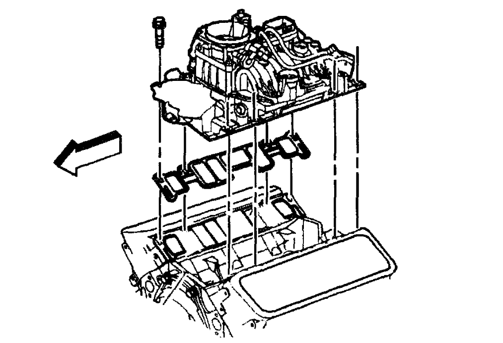

Usually this is caused by a vacuum leak, and if the RPMs are that high, then a major one. Here is a link to a guide explaining how to track down vacuum leaks. Please pay special attention to the intake manifold portion of the guide.

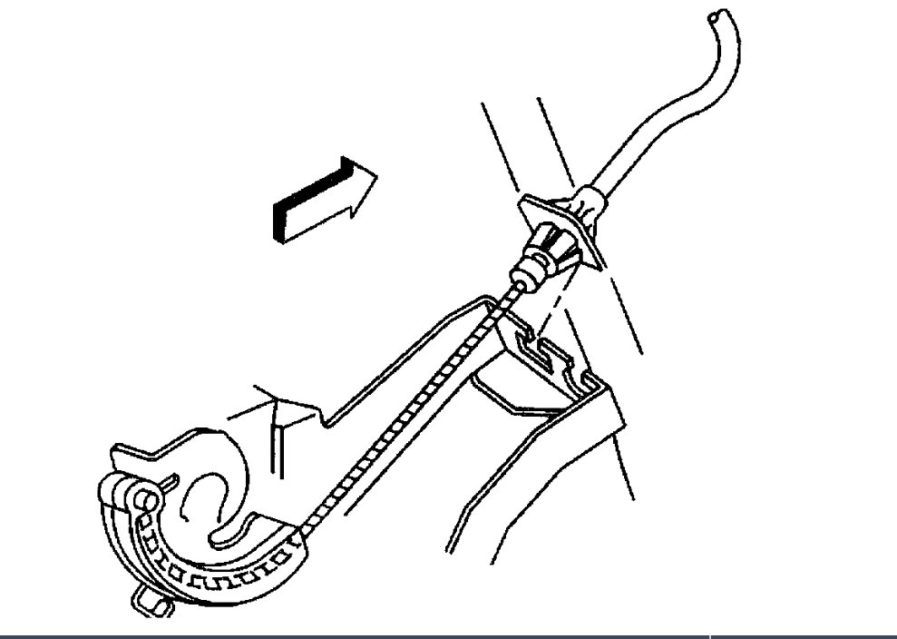

It could be the throttle valve is not shutting or sticking open, Clean and adjust it and check the throttle cable adjustment. There could also be a massive vacuum leak check the intake gaskets for vacuum leaks. Check the EGR valve for sticking open, Check the brake booster hose and all vacuum lines. Check the Idle Air Control motor pintle for carbon sticking and the throttle valve idle adjustment for tampering. Check the correct positive crankcase ventilation (PCV) valve, properly installed and proper operation of the PCV valve. Check for restricted air intake system. I'm attaching repair guides and component location below. Let us know if you more info.

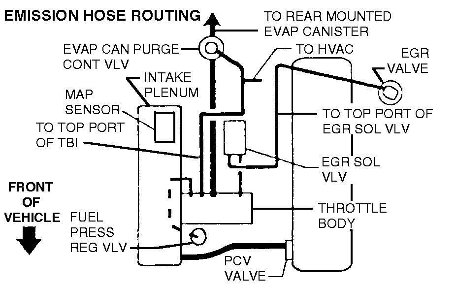

They are fuel fouled do you by chance a simple vacuum hose diagram?
Jan 20, 2021 at 7:27 PM (Merged)
Diagram.

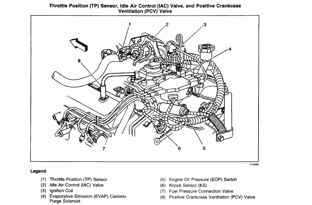

Hello. I have a nasty high idle in my 95 chevy s10. I have replaced every single electronic component that would effect the idle. The weird thing is that when I unplug the idle air control valve from the computer, the truck doesn't idle high.
Any help would be appreciated. Thanks
Jan 20, 2021 at 7:29 PM (Merged)
RASMATAZ
  • 75,992 POSTS
Try cleaning the IACV out-don't work-look for a vacuum leak-also check the TPS

The idle air control valve takes care of the idle. check for vacuum leaks too. If this is the 4.3L, check the intake for leaks. It was a common problem.
