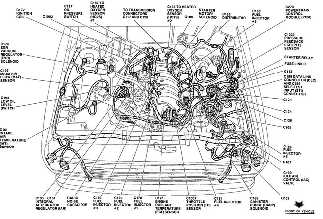

Hi lsc14006, Welcome to 2carpros and TY for the donation Clean out the idle air control valve and also clean the MAF sensor with an electronic cleaner and see what happens
https://www.2carpros.com/forum/automotive_pictures/12900_iacv_20.jpg
