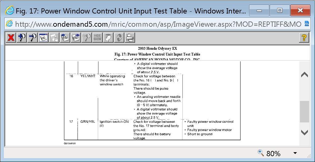

When trying to roll the passenger side window down from the driver side it won't go down, but it will go up, and it goes up and down when using the passenger side switch.
After studying the wiring diagram in the Haynes manual I did some voltage checks. I checked the voltage in the wires that plug into the passenger side window switch. The wires seem to be getting the proper voltage (DOWN circuit got 11.7 V when rolling the window down, UP circuit got 11.7 V when rolling window up.)
When checking the same wires while using the switch on the driver side, I got the correct voltage when rolling UP but got zero voltage when rolling DOWN. It seems like the down circuit is broken but I can't tell where. Any help would be appreciated.
By the way, this problem happened when I replaced the passenger window motor/regulator (cable was broke). There are two 6-pin connectors in the door and I accidently switched them when plugging them back in. I should have paid more attention to which one went where. Anyway, when I connected the battery up I smelled an electrical burning odor for a minute or so. Nothing worked, so I did some troubleshooting and figured out the connectors were plugged in wrong, switched them back and everything worked fine except the problem I describe above.

Hi GLP, Symptoms indicates a faulty master switch or passenger side switch. Here are procedures for testing the passenger switch. PASSENGER'S WINDOW SWITCH TEST 1. Check for continuity between the terminals in each switch position according to the table. 2. If the continuity is not as specified, replace the switch.
https://www.2carpros.com/forum/automotive_pictures/192750_PassengerWindowSwitch03OdysseyFig41_1.jpg
https://www.2carpros.com/forum/automotive_pictures/192750_PassengerWindowSwitch03OdysseyFig42_1.jpg
If the switch is ok, then you would have to test the driver door control unit.

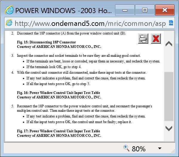

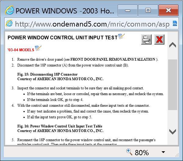

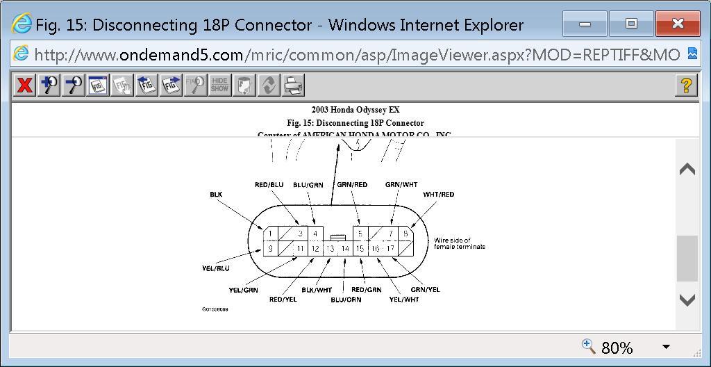

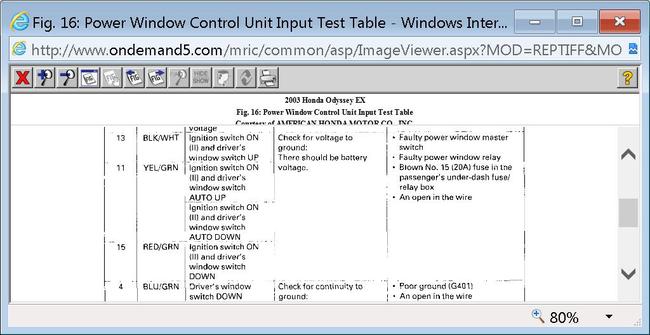

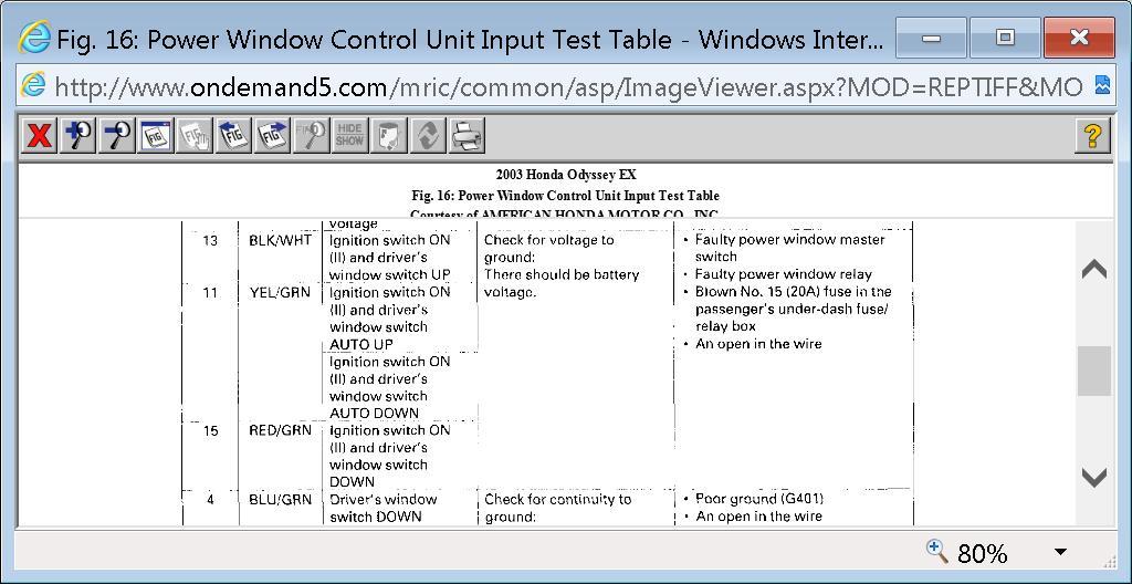

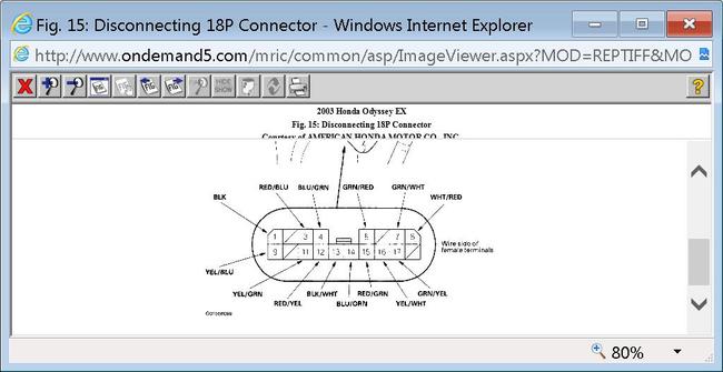

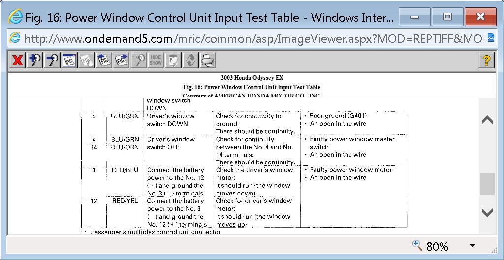

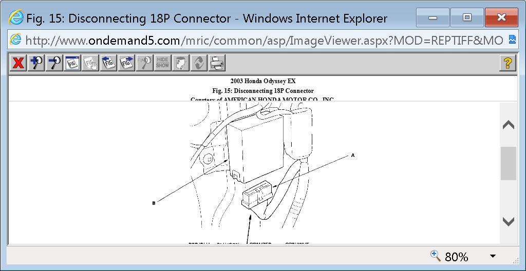

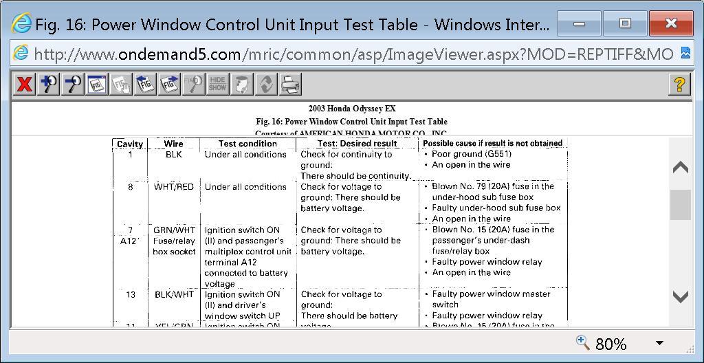

KHLOW2008
  • 41,814 POSTS
Your model is 03 so you should used the bracketted numbers instead.
UP = terminal 2 and 4 should have continuity but isolated from 1,3 5,6, which are all connected.
OFF = Only terminal 4 has no continuity in the circuit.
DOWN = Terminal 4 and 6 are connected.
Since the passenger switch did not solve the problem, I would suspect the master switch to be more likely to be the cause. If it is the Multiplex control system, most probably you would not be able to control the passenger door at all from the drive master switch.
Master switch testing procedures are not found in our database so most probably you would need to get a substitute master switch to test.
You can try getting the part from a junk yard to reduce cost.
Jun 26, 2020 at 12:25 PM (Merged)
GLP
  • 29 POSTS
I replaced the master switch and that didn't solve the problem. With a new master switch and passenger switch installed, the passenger window still won't roll down from the driver side. Do you have any other suggestions?
KHLOW2008
  • 41,814 POSTS
Are both replaced switches new or used? I would not rule out the possibility of any of them being faulty.
I have emailled some diagnostic files to you. Go through them and see if you can come up with anything. If you do not receive the files, please let me know.
KHLOW2008
  • 41,814 POSTS
I have resent the updated files and if you have any questions, please post reply here.
GLP
  • 29 POSTS
I can now view all the Figures in PWCUTest03Odyssey.pdf. I still cannot view the Figures in PWCUInputTest03Odysey.pdf. Maybe that file didn't get updated.
Thanks
