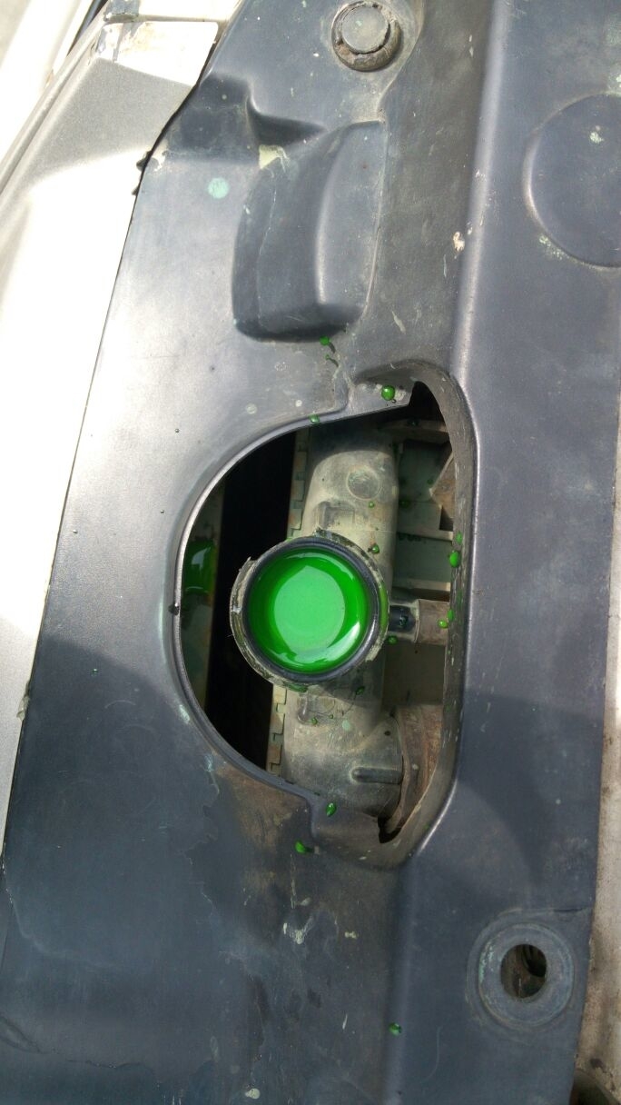

Hi good morning hope all is well. Thanks for the answers so far. But yesterday evening I used my car I checked the water level but driving it for about ten km and back I parked it this morning, I checked the water but it has dropped and I added some to it. this morning I drove it to office about twenty km I parked it and waited for it to cool down. I checked it again and the water has dropped but because there were no traffic the overheating did not start. what will be the problem?
Thanks so much for your help.
Jul 26, 2017 at 7:58 PM (Merged)
Hey MICHAEL,
Are the cooling fans working when the engine gets hot? if no they probably need replacing.
Here is a guide that will help you get the problem fixed:
https://www.2carpros.com/articles/replace-electric-fan-motor
Please let us know what happens so it will help others.
Best, Ken

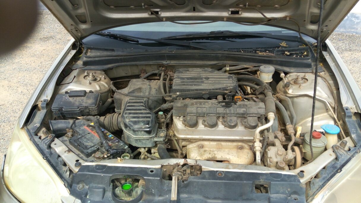

my 2005 Honda Civic EX special edition is overheating. a mechanic replaced the radiator, thermostat, gasket, and coolant, but it continues to overheat. what is causing this?
SATURNTECH9
  • 30,869 POSTS
Has it been checked for a bad head gasket? With blowing the radiator cap off i would check it for a blown head gasket.
ICROMWELL
Could it possibly be the water pump? i am not sure if it has been replaced or not. i bought it used.
SATURNTECH9
  • 30,869 POSTS
When the water pump fails they leak or seize up. Rent a chemical head gasket tester from auto zone its a free rental with deposit you just have to buy the chemical.
