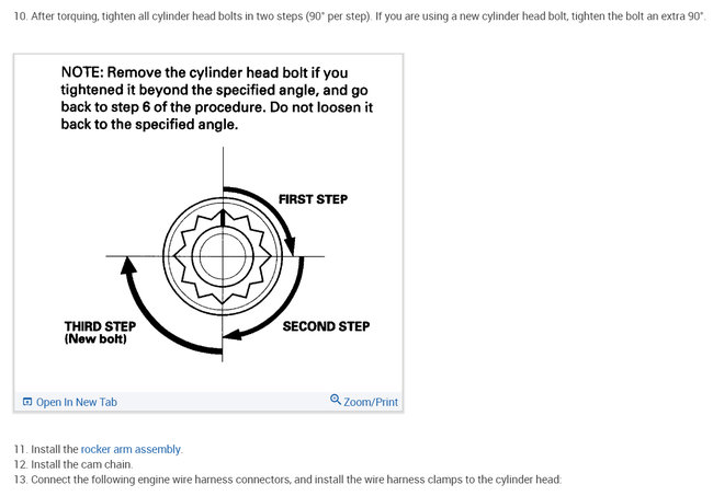

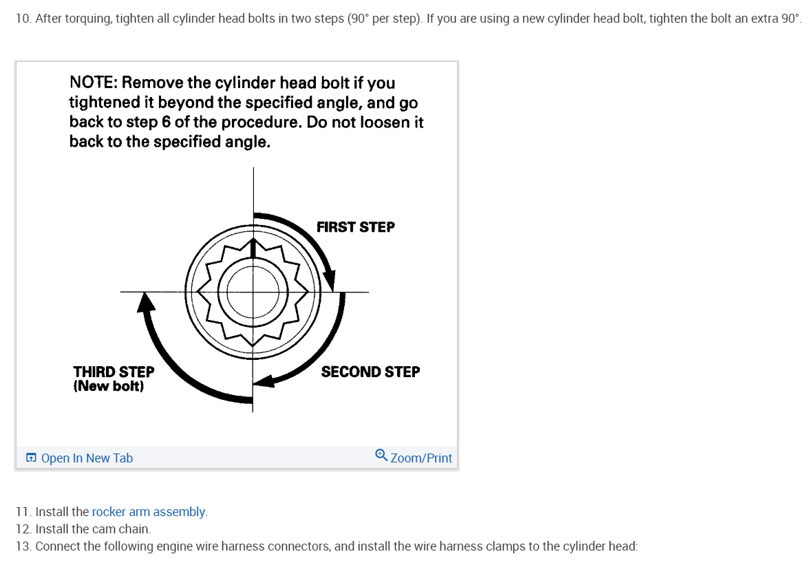

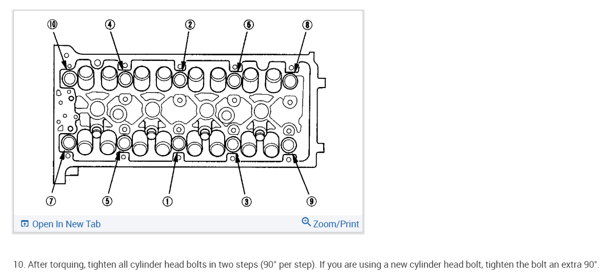

I have a 1999 Honda Accord LX 4cylinder 2.3 liter and the oil is getting into the radiator. I had a back yard mechanic replace the head gasket but just the head gasket and the car did great for about 500 miles and it started to do it again. I think that he did not do it right. Also it has a new radiator and there is no crack in the block so that is not it.
Feb 13, 2019 at 12:16 PM (Merged)
there may be a crack in the block that you cannot see.
did your guy replace the head bolts with new ones?? if not, that most likely may be the cause which means it has to come off again and be re done correctly.
MILTONASHLEY25
  • 8 POSTS
no he used the same old ones....and if that is not it what else could it be
that is it. they are torque to yield bolts and cannot be re used. when you remove the head again, take the time to have a machine shop check it for warpage and cracks.
start there. you need this before going anywhere else.
