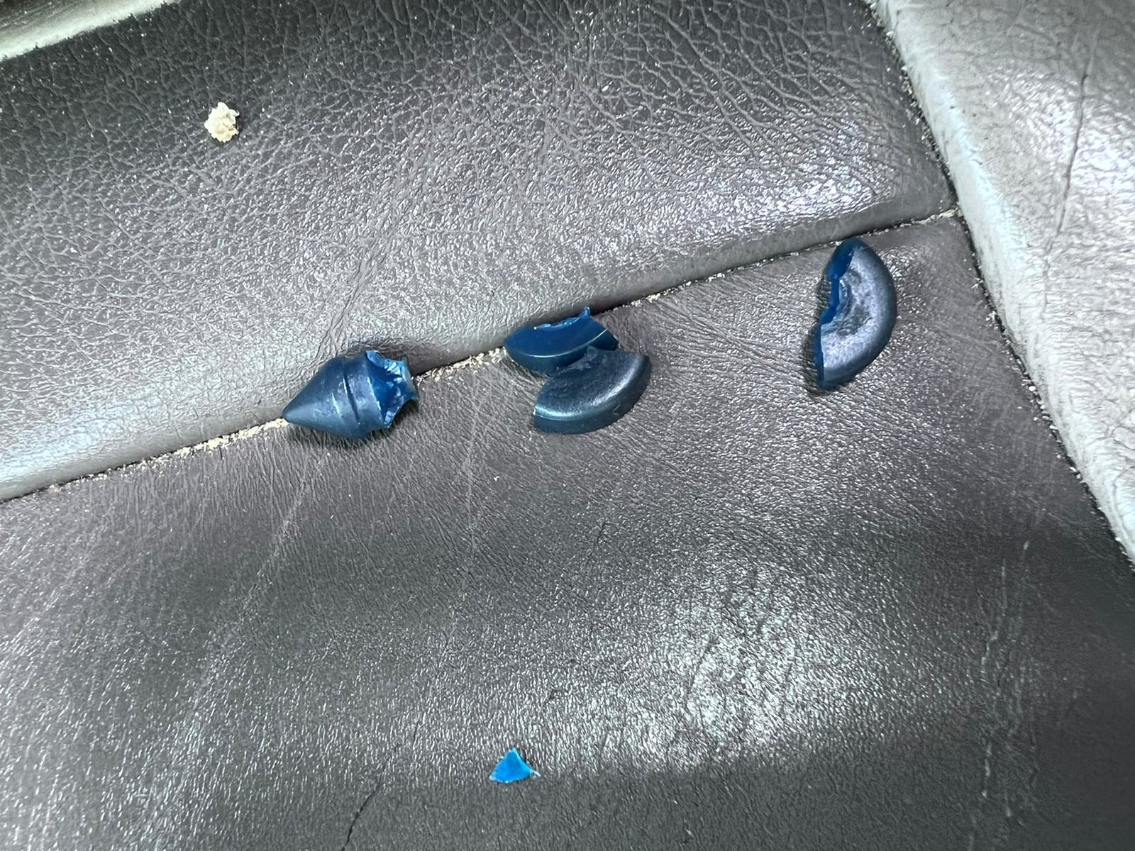

RASHFLOW
Honda Accord 2000 SE. Morning, I tried to start the car but it won't. Upon investigating i found some broken parts under the steering wheel which turned out to be brake pedal stopper. I guess replacing that will solve the problem. Is it also possible that the battery is completely drained out?
Jun 25, 2022 at 10:03 AM
Yes, if the stopper is messed up it can hold the lights on draining the battery out. Can you please upload a picture of what you are seeing?
Jun 25, 2022 at 11:23 AM
RASHFLOW
Here is what i found underneath.
Jun 25, 2022 at 12:58 PM
Yep. that will do it, that is the brake pedal stopper. Here are some new ones for you.
https://www.google.com/search?q=Honda+brake+pedal+stopper&gs_ivs=1#tts=0
Please let me know how it goes.
Jun 25, 2022 at 5:26 PM
RASHFLOW
Out of stock at auto shops near me. Amazon will deliver it quickest in 3 days! This is so stupid. The brake light must have drained my battery. Now every time I walk out of my car, I need to check the floor for broken pieces or my brake light or is there some other way to detect this?
Jun 26, 2022 at 5:56 AM
It's a good idea to keep an eye on the car but this is a rare problem, but should be fixed rather easily.
