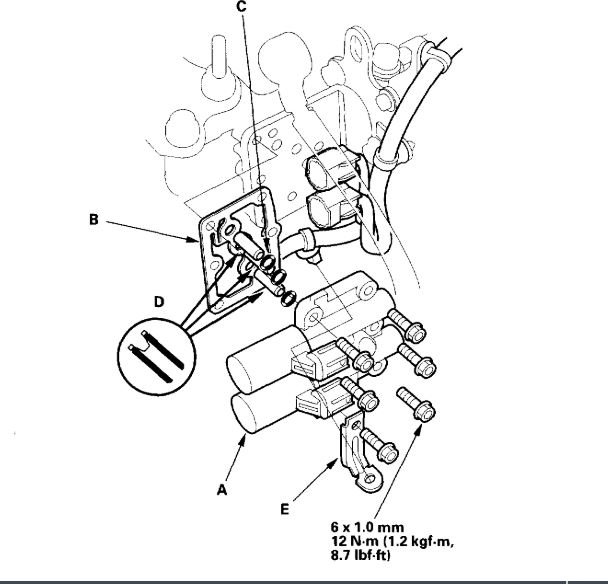

DTAUTFEST
Had d4 flashing and seemed to be stuck in 4th gear. ses light.
has dtcs p0780, p0730. dtcs will not clear with key on engine off.
ses light out after clearing. test drove 30 miles with no problem.
suspect a b solinoid issue but not sure. your input would be greatly appreciated. thx...Dan

clearing does nothing for the issue. stop doing that as it stores data at the time of failure for the tech to see when he scans it.
780
DTC P0780: Mechanical Problem in Hydraulic Control System for Shift Solenoid Valve A and A/T Clutch Pressure Control Solenoid Valves A and B, or Problem in Hydraulic Control System
NOTE:
- Record all freeze data before you troubleshoot.
- Keep replacement solenoid valves on hand:
- Torque converter clutch solenoid valve/shift solenoid valve A
- A/T clutch pressure control solenoid valves A and B
1. Check whether the OBD II scan tool indicates another code.
Does the OBD II scan tool indicate another code?
YES - Perform the Troubleshooting Flowchart for the indicated Code(s). Recheck for code P0780 after troubleshooting.
NO - Go to step 2.
2. Turn the ignition switch OFF.
3. Replace the torque converter clutch solenoid valve/shift solenoid valve A, and the A/T clutch pressure control solenoid valves A and B.
4. Reset the PCM memory by removing the BACK UP fuse in the passenger's under-dash fuse relay box for more than 10 seconds.
5. Drive the vehicle for several minutes in 1st, 2nd, 3rd, and 4th gears in 1 position.
6. Recheck for code P0780.
Does the OBD II scan tool indicate code P0780?
YES - Replace the transmission assembly.
NO - The problem has been corrected.
NOTE: Honda Motors has extended the warranty on A/Ts and torque converters to 7 years or 100,000 miles for '00-'01 Accords, '99-'01 Odyssesys, and '00-'01 Preludes. For more information, see Service Bulletin 02-062 (January 5, 2007).

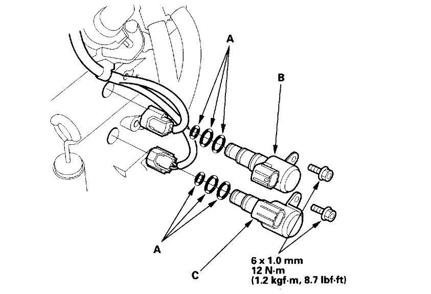

LOTHIAN
Hiya, ASEMASTER6371.
Can you reply with the Honda OEM p/n's for the solenoids you list in your response? eg,: "torque converter clutch solenoid valve/shift solenoid valve A", "shift solenoid valve B", "shift solenoid valve c", the "A/T clutch pressure control solenoid valves A and B". I'm having difficulty identifying each of these specific parts.
Jun 1, 2020 at 5:33 PM (Merged)
Below are the pictures for the solenoids A,B,C and the pressure solenoid.
You will need to call Honda for the part numbers as they have changed since the update in my system.
