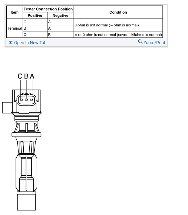

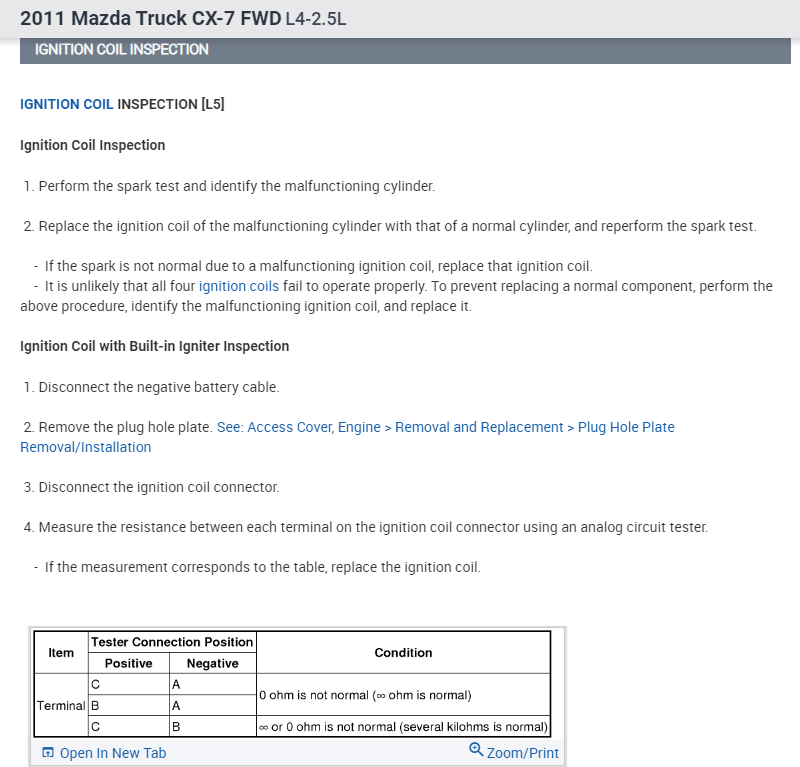

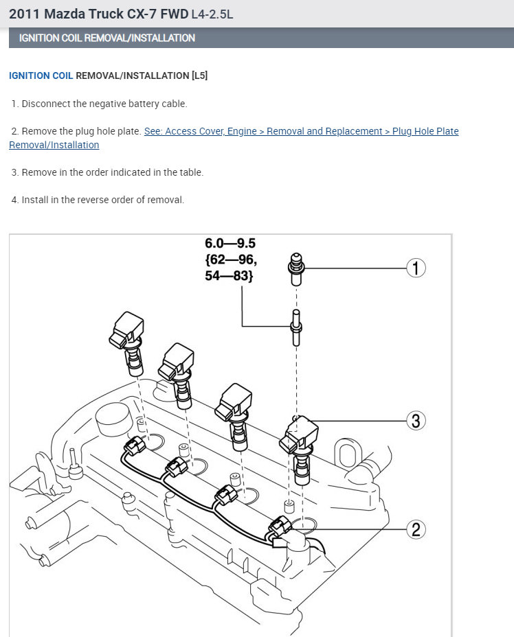

Oil-soaked coil pack typically does not function properly. However, if the oil is only on the outside, it might just need to be cleaned and dried out.
I have attached the ignition coil test procedure below for your reference.

Well, they were soaked in oil (two of them) took apart and cleaned let dry.

I wonder if there is a wiring issue with this vehicle. As these codes can also indicate faulty PCM.
If you are able to test the coils after they dry with a multimeter. That way you will know that the coils are/are not the problem.

Let me know the outcome after the coil gets installed.
