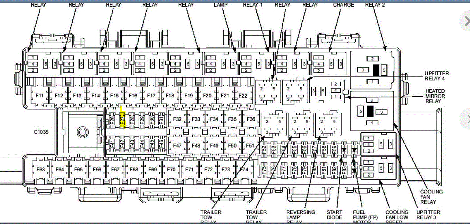

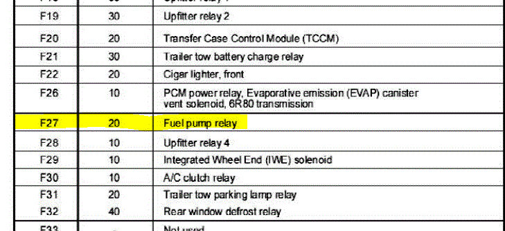

Okay, I need you to check a specific fuse in the battery junction box. It is fuse 27. Do me a favor, pull it and inspect the fuse as well as the socket it goes to. I remembered reading about an issue with them overheating and causing hard start or no start conditions. See pics 1 and 2.
Mar 4, 2020 at 7:08 PM
WIERDFOOT
  • 20 POSTS
Already checked that. Fuse is fine and no problem with the socket.
Mar 5, 2020 at 2:38 AM
If you have 12v at the socket, then either the pump is bad or something is causing a restriction.
At this point, I would check to see if pressure is good right at the module. If it isn't, the pump has a problem. If it is, then there is a restriction at some point.

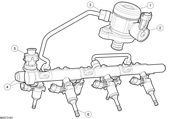

Take a look through this info and let me know your thoughts. In most cases, the injector pump either works or it doesn't. I guess it's possible that we have a new type of issue. However, you are checking fuel pressure before this component. Once the engine starts, the fuel injection pump increases pressure. That is why I don't feel it is related.
2010 Ford Truck F 150 4WD V8-5.4L Flex Fuel
High Pressure Fuel System
Vehicle Powertrain Management Computers and Control Systems Testing and Inspection Diagnostic Trouble Code Tests and Associated Procedures Powertrain Control/Emissions Diagnosis (PC/ED) Section 1: Description and Operation High Pressure Fuel System
HIGH PRESSURE FUEL SYSTEM
2010 PCED Gasoline Engines
SECTION 1: Description and Operation
Overview
The high pressure fuel system receives low pressure fuel from the fuel pump module and delivers fuel at high pressure to the direct injection fuel injectors.
The high pressure fuel system consists of the fuel injection pump, the fuel volume regulator, the fuel rail pressure (FRP) sensor, the fuel supply line, the fuel rail, and the fuel injectors. For additional information on the fuel system components, refer to Engine Control Components in this section. Operation of the system is as follows:
1) The fuel injection pump receives fuel from the fuel pump module, increases the fuel pressure from approximately 448 kPa (65 psi) to a PCM determined pressure up to as high as 15 MPa (2175 psi), and delivers it to the fuel rails.
2) The fuel volume regulator controls the volume of low pressure fuel that enters the inlet check valve and the pump piston inside the fuel injection pump. The PCM regulates fuel pressure by controlling the timing of the fuel volume regulator solenoid.
3) High pressure fuel exits the fuel injection pump and is delivered to the fuel rails through the fuel supply line.
4) The fuel rails distribute and channel high pressure fuel to the fuel injectors.
5) The FRP sensor provides a feedback signal to indicate the fuel rail pressure so the PCM can command the correct injector timing and pulse width for proper fuel delivery at all speed and load conditions.
6) The fuel injectors meter fuel flow to the engine. A given cylinder fuel injector can deliver single or multiple injections for each cylinder event. The amount of fuel is controlled by the length of time the fuel injectors are held open.
pic 1
___________________________________
The other thing is the fuel pump control module. It may not be working properly, but then you wouldn't have 12v right away to the pump.

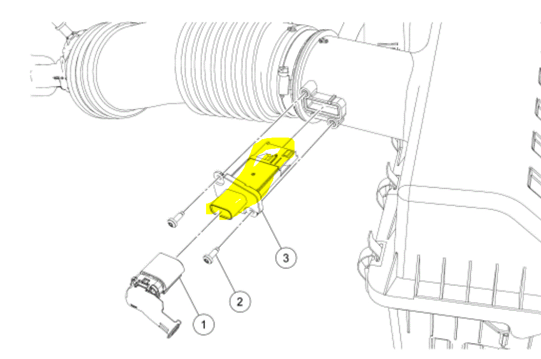

As far as the idle, that is usually the result of a faulty idle air control valve. That is what allows metered air to enter the engine when the throttle plate is closed. However, your description could also indicate an issue with the mass air flow sensor.
Let's do this: Remove the MAF and see if it appears dirty. Try cleaning it with MAF cleaner that you can get at a parts store.
Here is a link that shows how it's done:
https://www.2carpros.com/articles/mass-air-flow-service
The attached pic shows the location.
