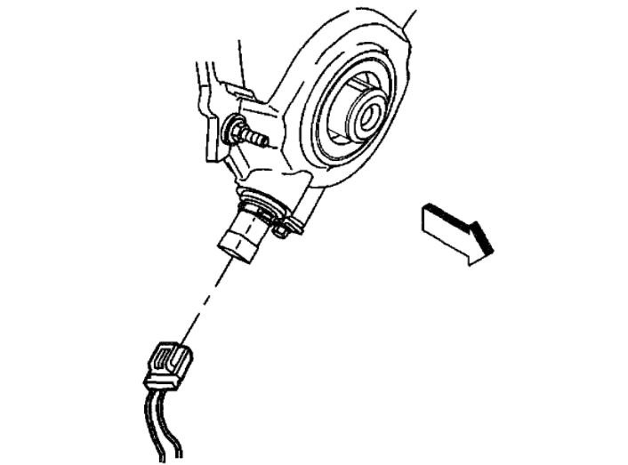

Okay, thank you. So I need to drop the oil pan in order to get to it?
Jan 25, 2021 at 12:19 PM (Merged)
nope, simple. go under the truck and on the passenger side of the harmonic balancer is the sensor. one connector, one bolt and out it comes.

So I have the 5.7 v8.Is it inside the oil pan or on the outside of the oil pan?
As I stated and sent a picture, it is outside the oil pan. it is mounted on the block next to the harmonic balancer. it has a connector that has to be removed and one hold down bolt.
