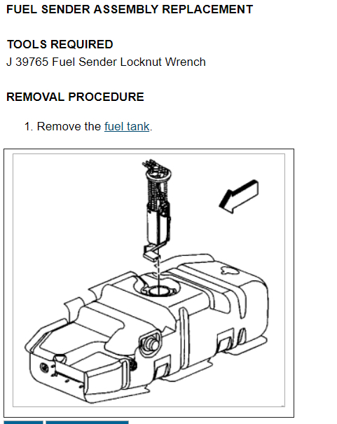

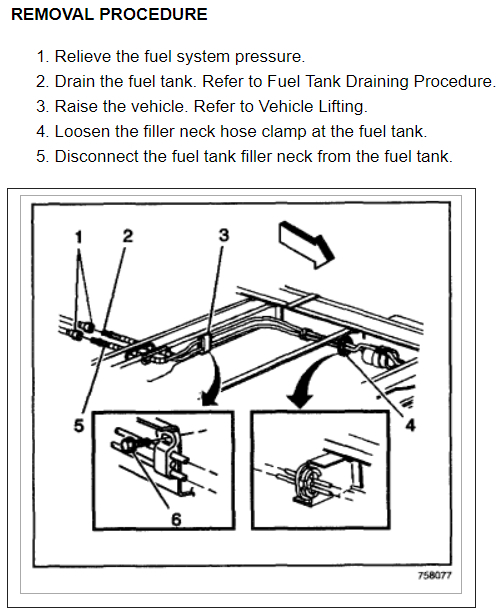

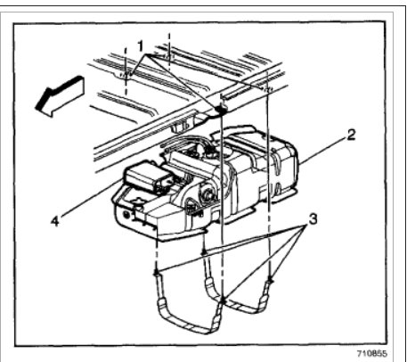

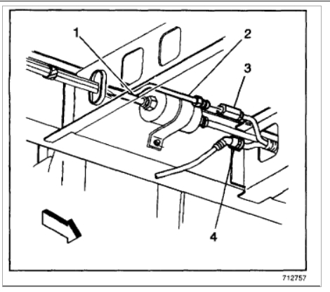

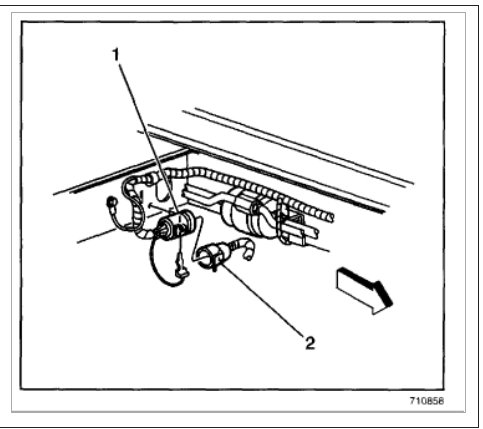

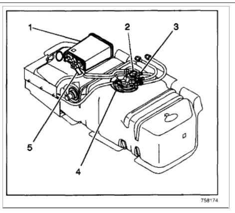

It looks like my pump is bad, no fuel pressure. how do I replace it?
Oct 20, 2018 at 4:43 PM (Merged)
SATURNTECH9
  • 30,869 POSTS
Yep I thought so. Here is a guide that can help you see what you are in for when doing the job
Here is what it will be like on your car.
Cheers
