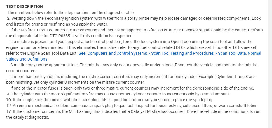

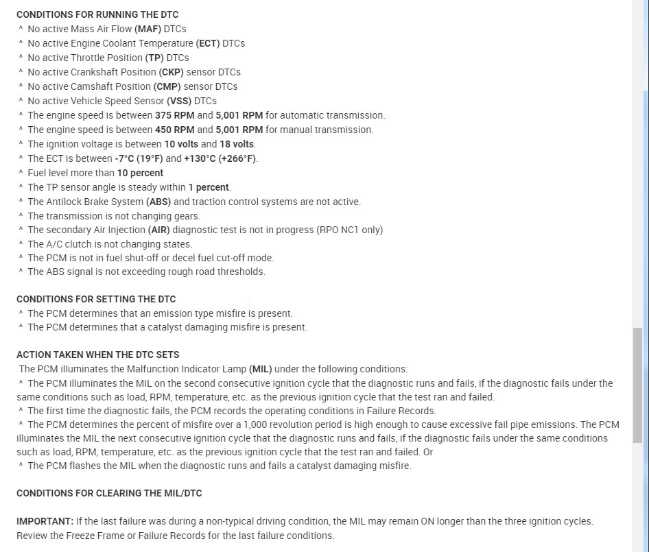

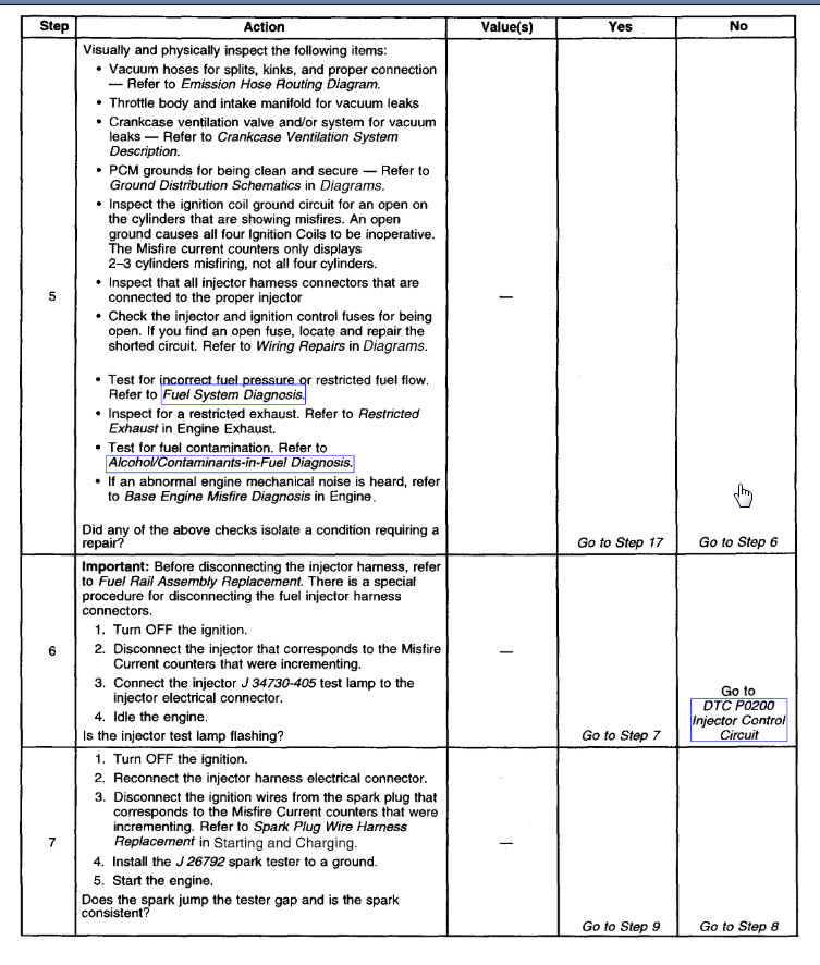

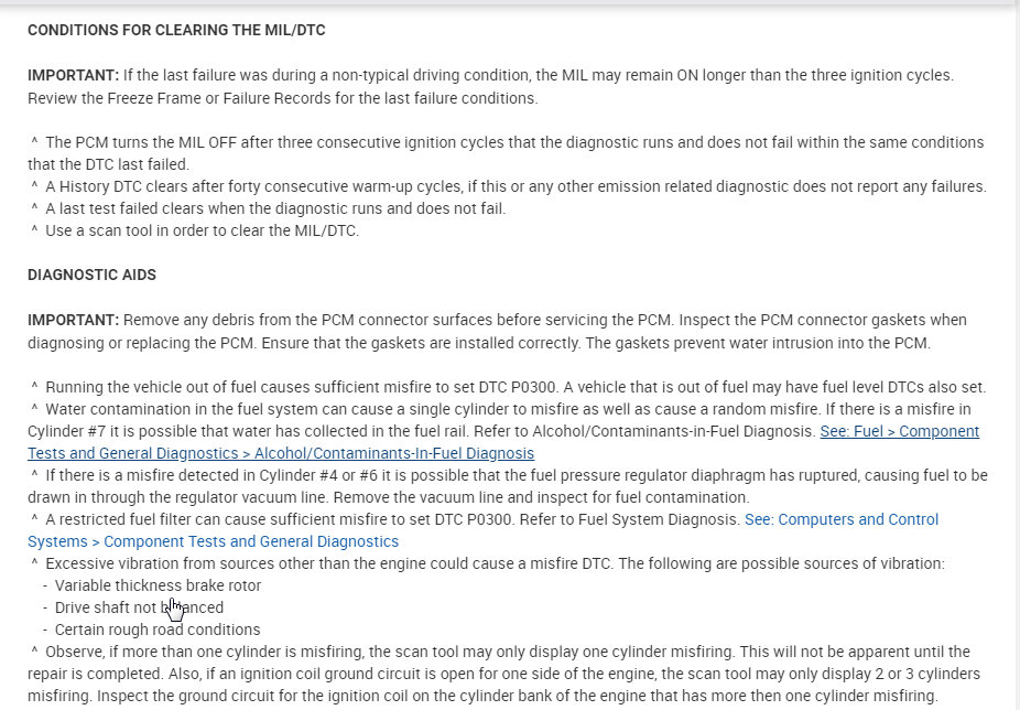

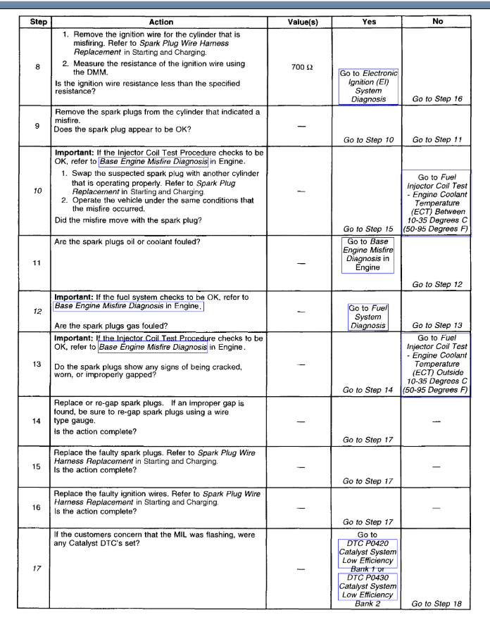

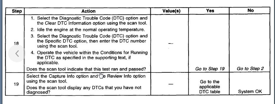

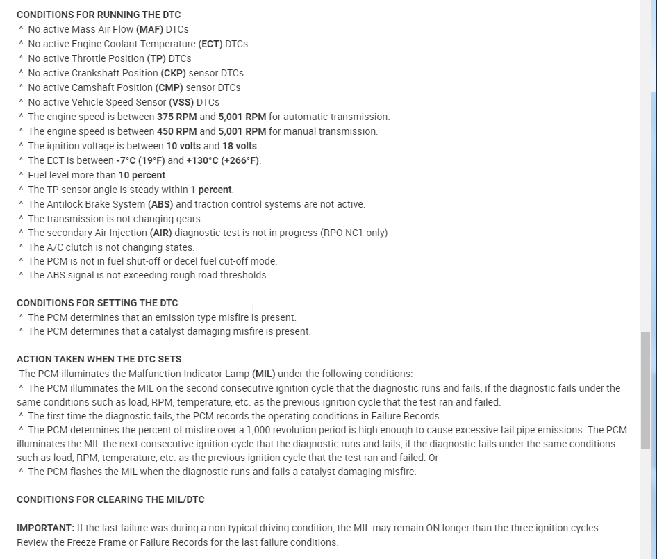

I attached the testing for the p0300 code. This code is just telling us that the PCM is not seeing the crankshaft accelerate as it should after each time the spark plug fires. This is on various cylinders and not one repeatedly.
So this means we need to check the things that each cylinder has in common first. This is fuel pressure and ignition issues. This could also be o2 sensor issues or simply a crank sensor issue.
The only way to know for sure is to run through this testing and find out where the issue is. Let us know what you find and we can go from there. Thanks
