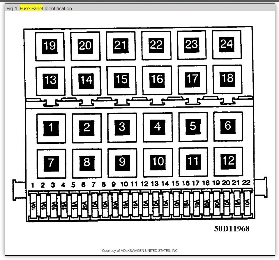

I need help I am trying to connect some wires that I noticed were disconnected from the fuse box. I have a few missing fuses, but I do not know where wires belong or what fuse goes where.

My son took the fuse box apart & I have no idea now where everything goes. Please Help!

Hi there, Fuse box layout as per pic. Mark (mhpautos)

Thank you, Mark (mhpautos) for your response. However, the pic that you sent is way to small to even view. Please will you sent the pic again but larger?

not sure if i can send larger In this forum, have you tried saving the pic and opening it with a picture program? I will see what i can do though.

Yes I did try saving it & opening it with a pic program but it only made it blurry. Where might I get the pic of the fuse box layout myself?

This pic is not off a free web site, so you will not have access to it. I am trying to get you a bigger view.

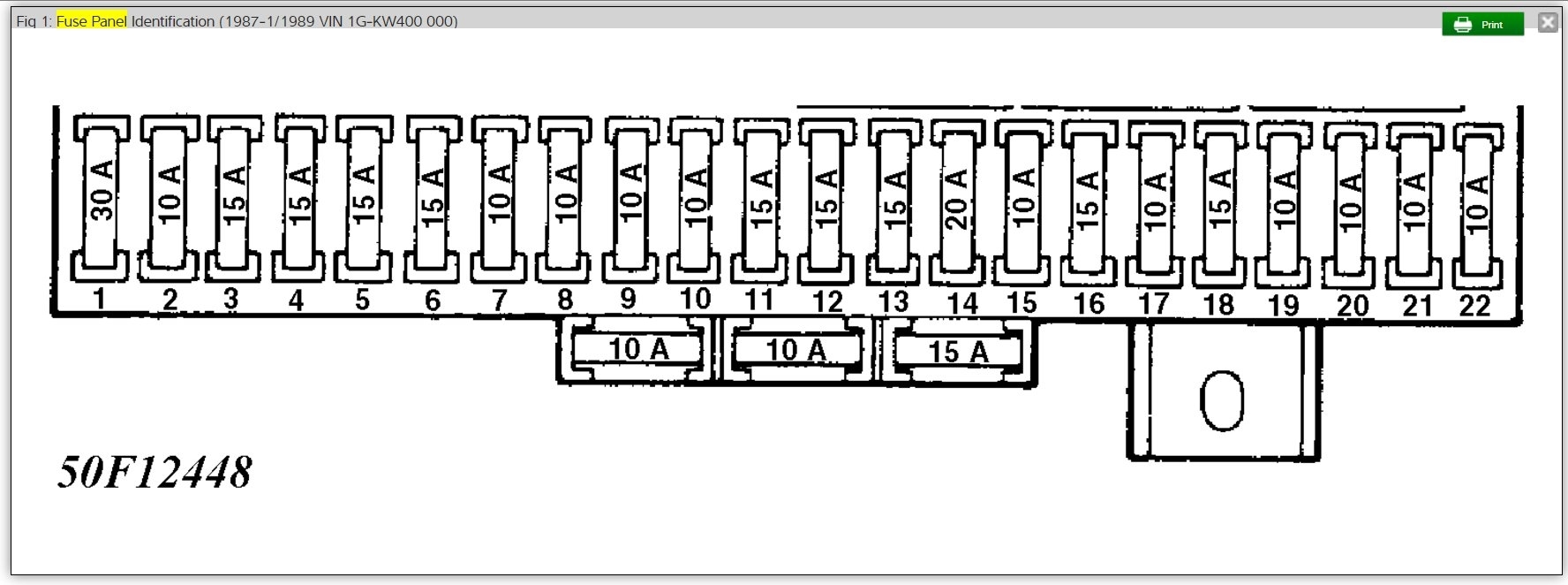

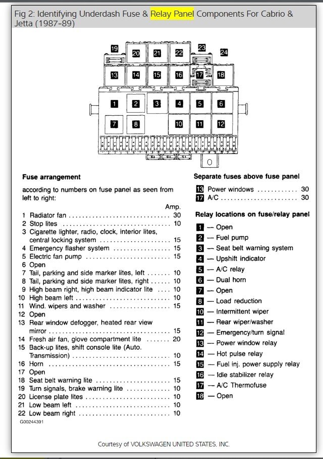

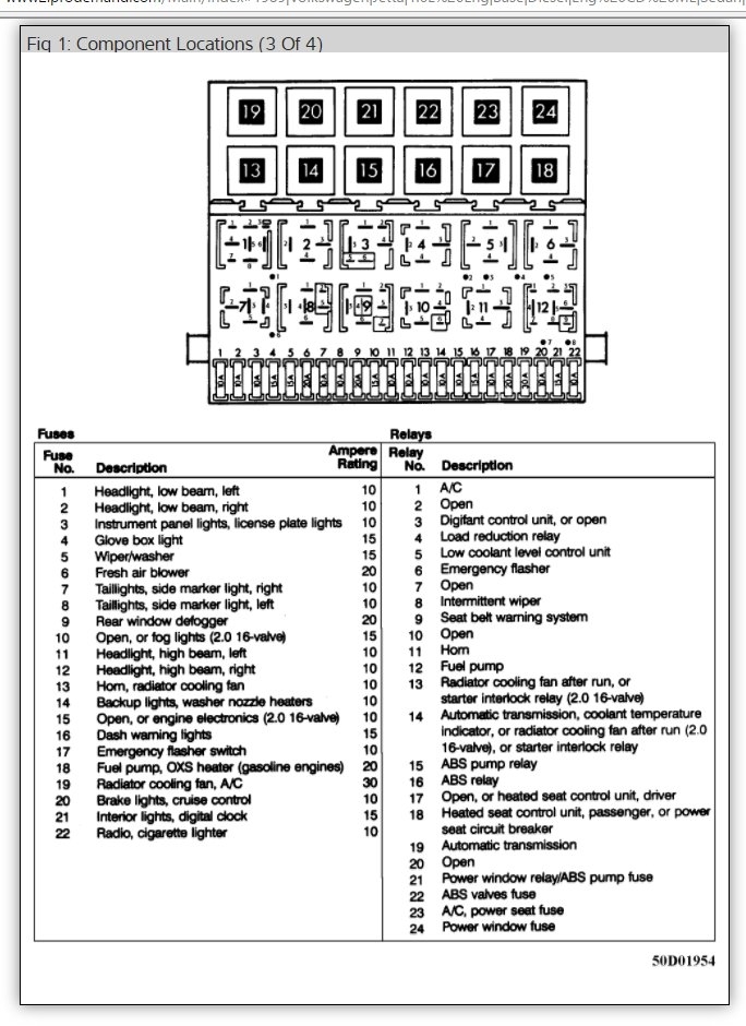

jetta2 cli fuse box diagram
Jul 14, 2020 at 12:19 PM (Merged)
I found the complete fuse box guide for you with diagrams (BELOW)
1 - 10 Amp Left Headlight Low Beam
2 - 10 Amp Right Headlight Low Beam
3 - 10 Amp Instrument & License Lights
4 - 15 Amp Rear Window Wiper, Glove Box Light
5 - 15 Amp Windshield Wiper/Washer
6 - 20 Amp A/C, Fresh Air Fan (16-Valve)
7 - 10 Amp Right Taillight & Side Marker Light
8 - 10 Amp Left Taillight & Side Marker Light
9 - 20 Amp Rear Window Defogger
10 - 15 Amp Fog Lights (2.0 16-Valve Only)
11 - 10 Amp Left Headlight High Beam & High Beam Indicator Light
12 - 10 Amp Right Headlight High Beam
13 - 10 Amp Horn, Radiator Cooling Fan (16-Valve)
14 - 10 Amp Backup Lights, Washer Nozzle Heaters
15 - 10 Amp 2.0 16-Valve Only: Engine Electronics, Stabilizer Valve, Cold Start Valve
16 - 15 Amp Instrument Panel Warning Lights, Multi Function Indicator (16-Valve)
17 - 10 Amp Emergency Flasher, Turn Signals
18 - 20 Amp Fuel Pump, Oxygen Sensor
19 - 30 Amp A/C, Radiator Cooling Fan
20 - 10 Amp Brakelights, Cruise Control
21 - 15 Amp Interior Lights, Digital Clock, 16 Valve: Luggage Compartment Light, Central Locking System, Multi-Function Indicator
22 - 10 Amp Radio, Cigarette Lighter
