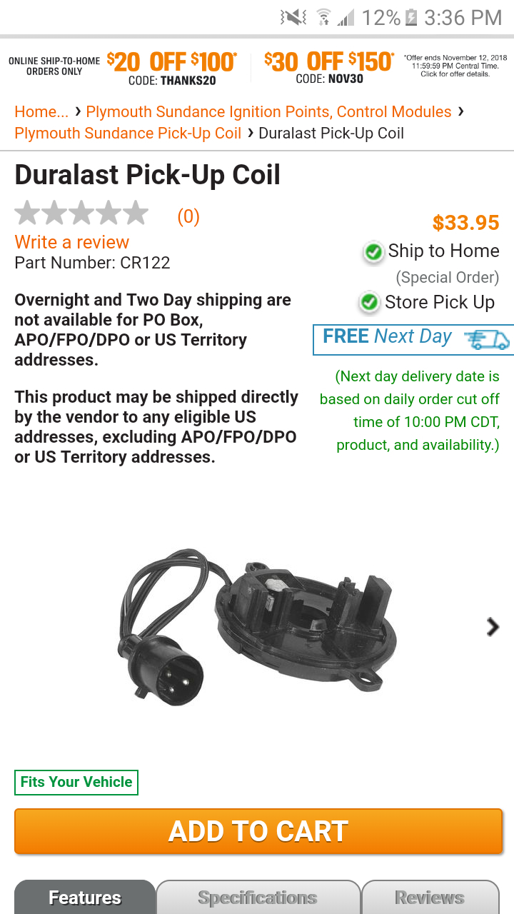

Sorry. The shutter wheel. Those white pieces broke of the shutter wheel.
Nov 7, 2018 at 5:55 AM
Yes, the replacement piece is complete. It just drops in and you plug it in.
Nov 7, 2018 at 6:06 AM
The reason I ask is cause the part from AutoZone does not show the shutter wheel in the picture it just shows the pick up coil.
Nov 7, 2018 at 6:43 AM
When you go to the parts store, take the old one with you to match it up. It should have everything with it.

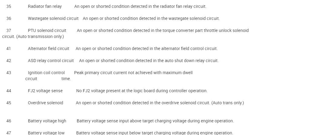

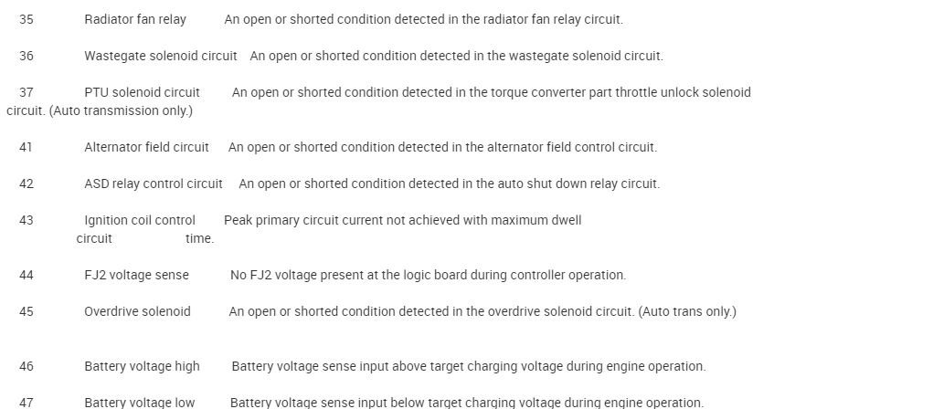

Got it running. Drove about thirty miles the had to pull over on side of highway. Now the motor is not turning just hear the starter cranking. Got code 42.
Nov 8, 2018 at 1:21 PM
I swapped the relay with another relay nothing changed. Will check wiring but did not do anything once I put the new distributor in. It was working fine then got about half way to Austin then it just kind of lost power. Checked oil it is low, but car not even cranking just hear the starter spinning. New starter and timing belt and of course the distributor. Will check the ASD relay wiring. If I do not find anything wrong any other suggestions?
Nov 8, 2018 at 1:40 PM
Can you hear the fuel pump run? Do you have spark?
Check the fuse for the ASD relay.
