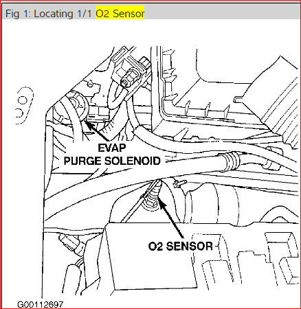

Got the new catalytic converter in and now another code popped up for P0135. The hits keep coming with this car.
Jul 2, 2018 at 5:02 PM
DANNY L
  • 5,648 POSTS
Hello again, Danny here.
That code is your Upstream Bank 1 heated O2 sensor. Unfortunately it is my experience that it goes hand in hand with the bad catalytic converter on that side. Having that misfire damaged that sensor and converter over time. Usually O2 sensors run $60.00 to $90.00 from auto part stores but nowadays people like shopping online to save money. I am confident you can do this repair. Here is the tutorial for O2 sensors and location.. Danny-
https://www.2carpros.com/articles/how-to-replace-an-oxygen-sensor

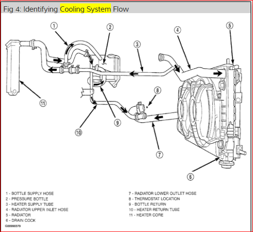

What is the second hose on the thermostat housing?
Jul 3, 2018 at 3:32 PM
DANNY L
  • 5,648 POSTS
That is the heater return tube. I have attached a diagram for you. Hope you are having good luck.

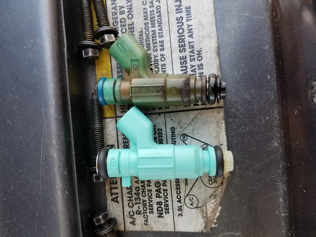

As we previously discuss I changed out the number one fuel injector and ever since I bought this car I had a strong smell of fuel by the intake manifold and then I can smell it in the cabin of the vehicle. Now from the picture that I uploaded do you think that o-ring is bad and would cause a fuel leak?
Jul 3, 2018 at 9:27 PM
DANNY L
  • 5,648 POSTS
Hello again.
That old Injector? I would say yes, Looks like it would leak!

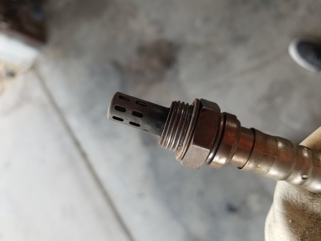

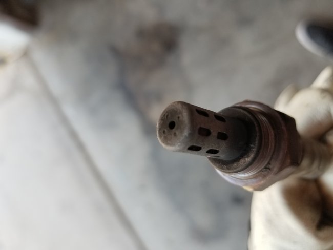

Took the o2 sensor that was throwing that code.
Jul 4, 2018 at 1:44 PM
ALEX19899
  • 171 POSTS
Jul 4, 2018 at 1:45 PM
DANNY L
  • 5,648 POSTS
Hello again.
After replacement be sure to clear codes. Looks like you should be almost completed with repairs! Danny-
Jul 4, 2018 at 4:48 PM
ALEX19899
  • 171 POSTS
Yea, I never seen o2 sensor with that black stuff before.
Jul 4, 2018 at 6:09 PM
DANNY L
  • 5,648 POSTS
Hello again.
That would normally be caused by the engine running rich due to a misfire. Danny-
