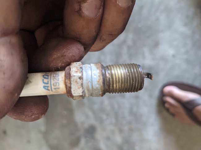

Well I finished up the plugs and wires. With the new ACDelco plugs and 10mm wires I did get a good carbon burning smell when I first started it and let it idle for a bit. I revved it a few times and it did ok but stumbled a bit in the 2-3k range. So I took it for a drive. First off I'll say I "think" I've got a better throttle response now. I drive it kinda hard. And it performed well. Hit it's gears fine. 0-80 was smooth. So the power is there. But at 1/4 throttle, there is a stumble on the 2-3k range still. It got better as I drove the truck, so maybe it'll work itself out. Or maybe it's time for some seafoam down the intake...
Any other ideas?
No lights. No codes, of course.
The image below is the from infamous cylinder #3 that many people hate fighting with (takes about 10 minutes if you know what you're doing). It definitely has some age on it. And it matches the other 5.

Look at those OSHA safety shoes LOL.... That plug is easy if you know the trick, or bought the specific swivel socket for it...

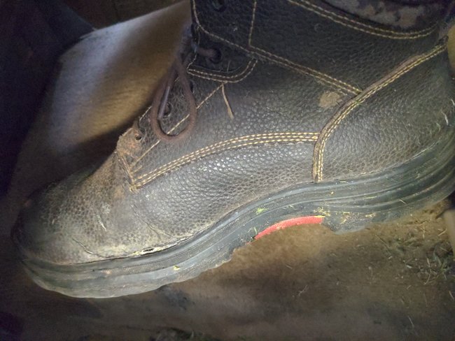

No such thing as OSHA in my own garage. But are these better? They're my postal approved shoes.

Those are a bit better... Air filter wise, unless you are replacing one that is full of dirt I've never seen any real increases, unless you are running a vehicle that really needs a lot of air like a blower or large turbo otherwise they pass a LOT of dirt and crud, plus the oil tends to mess with the MAF. Speaking of oils, you might try putting synthetics in all the boxes, might give a bit more.

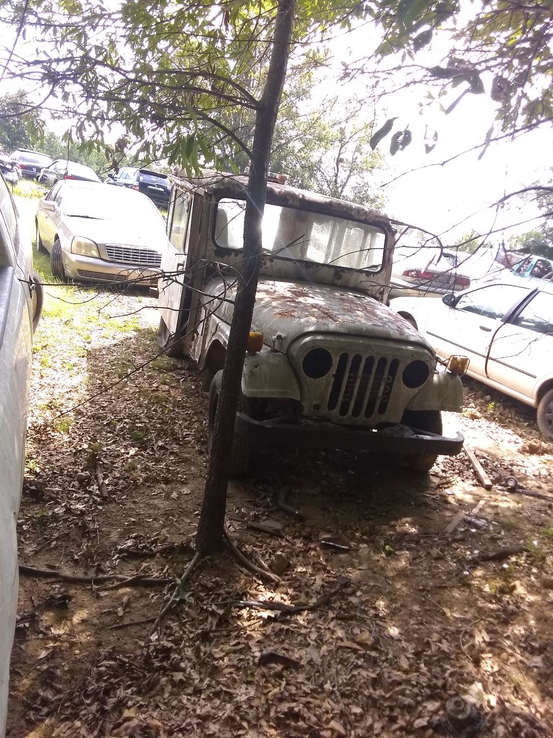

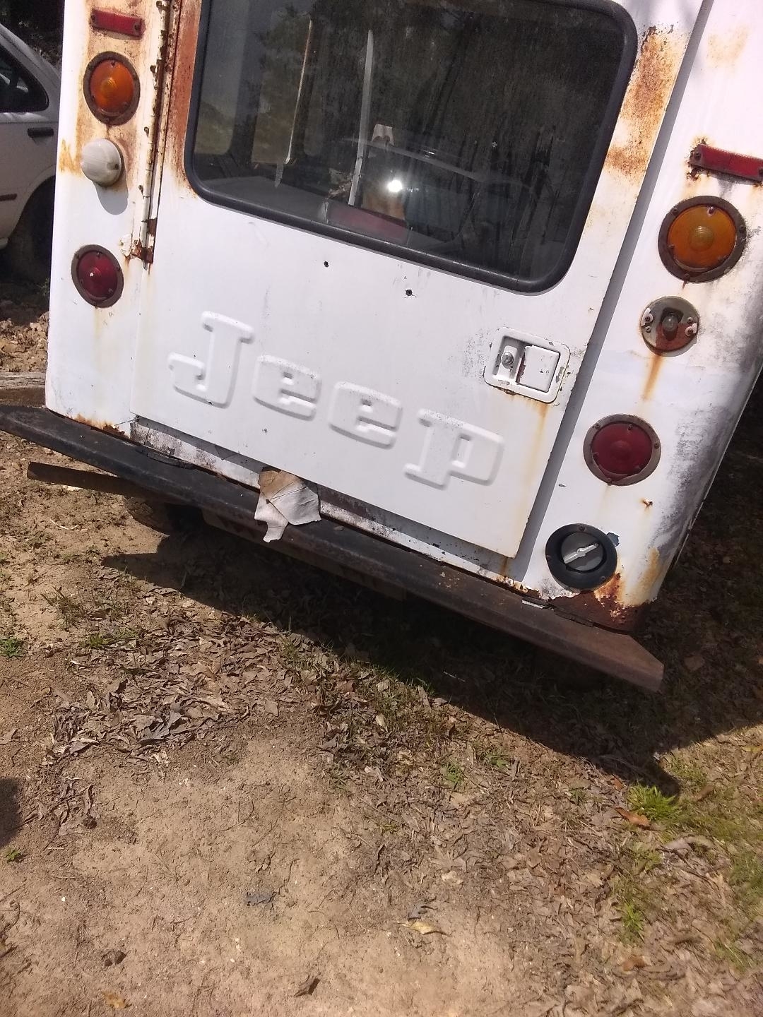

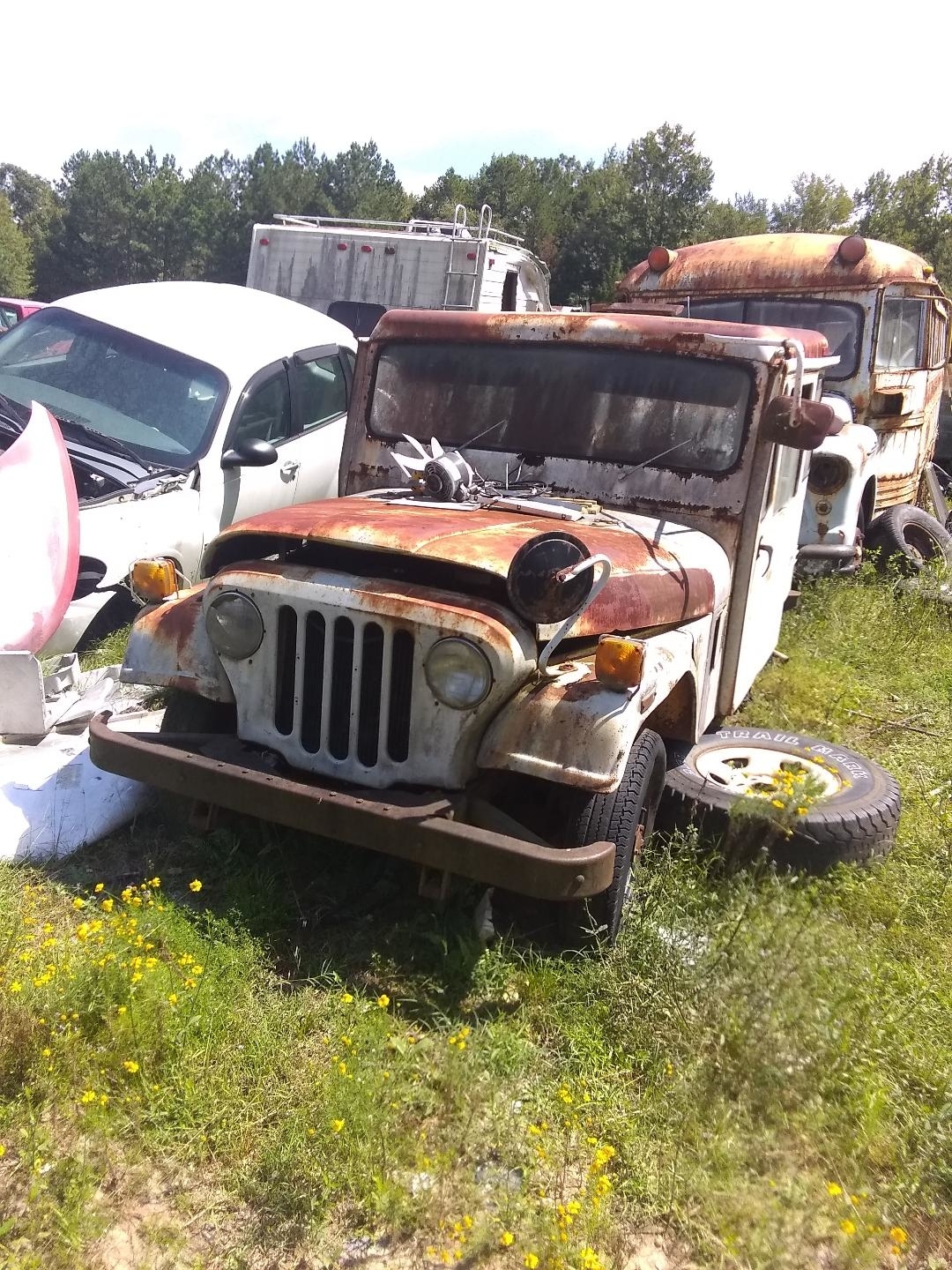

CJ MEDEVAC
  • 11,004 POSTS
I was just there today, these four got to the yard within the last year (since the last time I went)
Revert back to the "Proven" / "Accepted"/ "Reliable" mail method. Inexpensive parts.....computerless.....permanent Code "PO (post office)EZ FIXIN'"
With the money you're spending, one of these could be back up and running with proven MPG modifications!
I feel like one of them will make it back to my house, hopefully a deal (as he's given me in the past) He and my brother and law are best buddies!
They might stop calling you the "mail blazer"/ "mail van" and you earn the "Mail Man" designation as did all of the previous Postal "JEEP" drivers were called!
