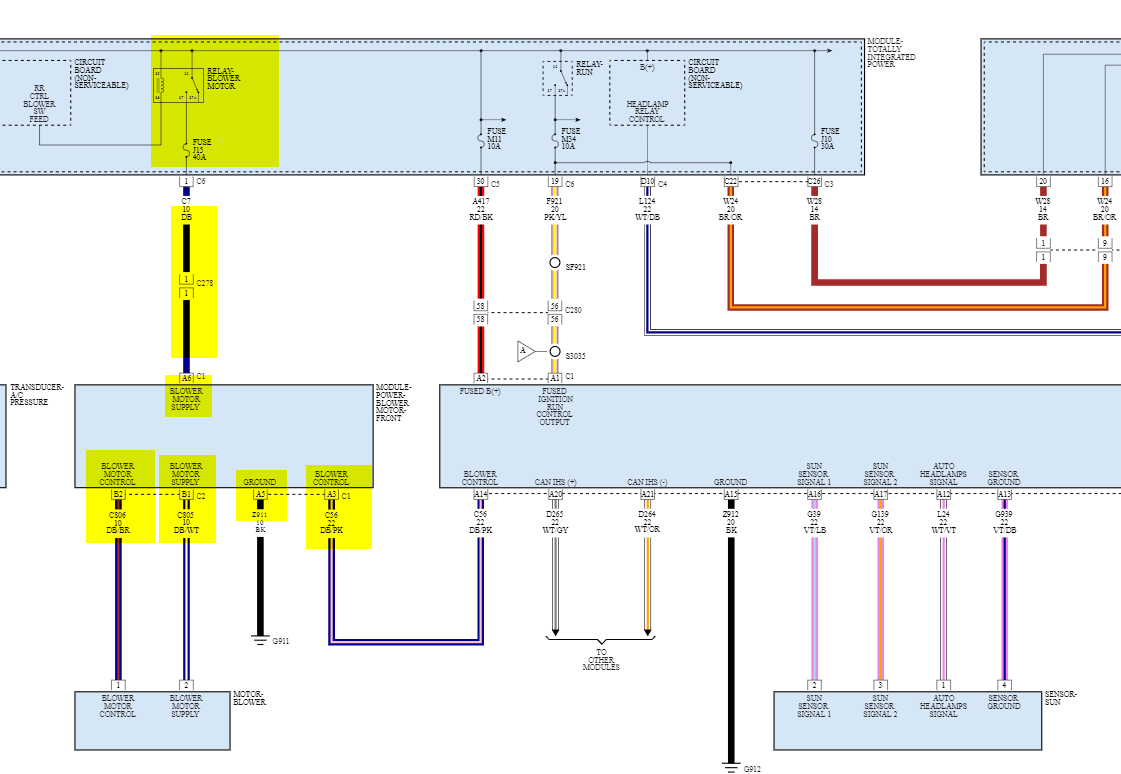

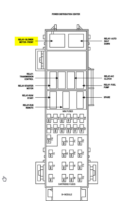

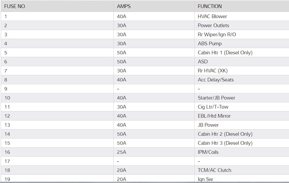

My wife notified me she didn't have any heat in the car! So when I go home from work I checked to see what she was talking about and the front blower doesn't do anything. You can hear the blend doors open and close, no blower motor at all. Relay, motor, resister. I have no idea. It worked perfectly fine the day before. And the rear blower works fine it just blows cold air and that's it. More worried about the front blower than anything. Please help!
Oct 3, 2019 at 10:54 AM

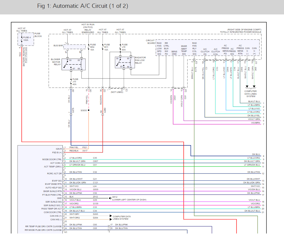

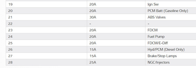

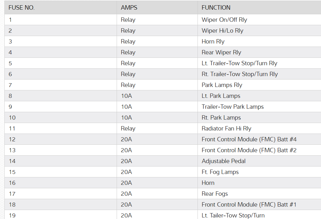

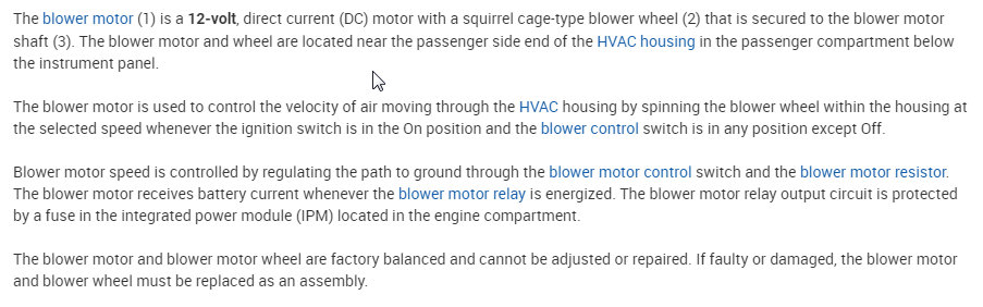

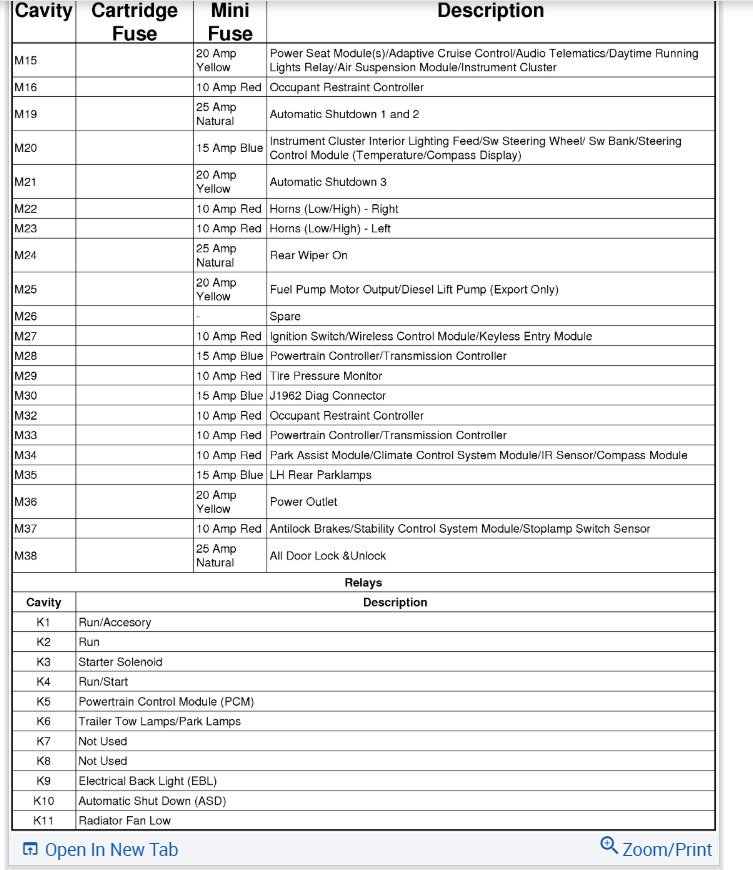

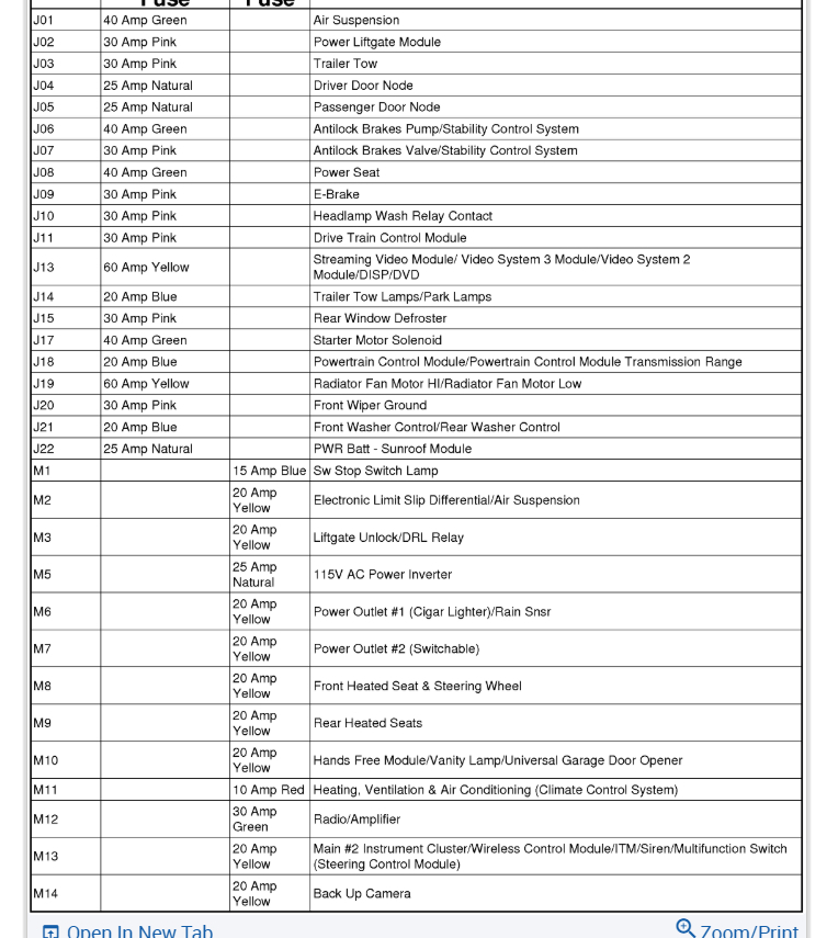

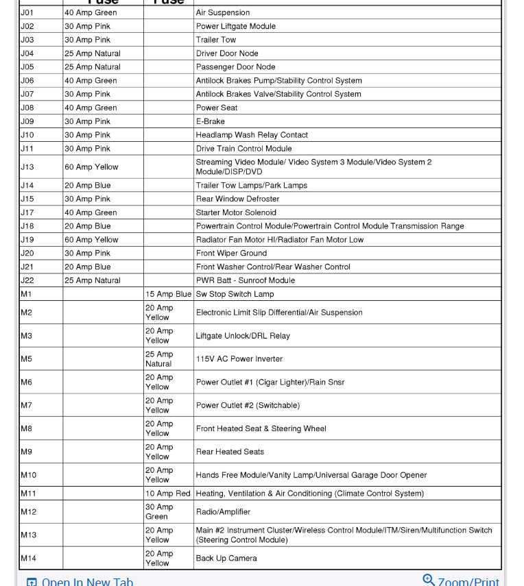

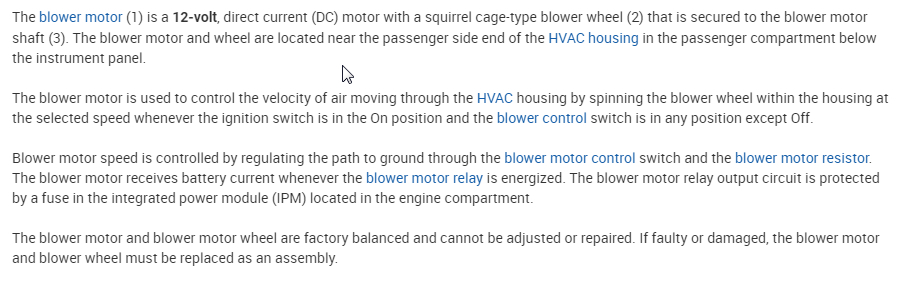

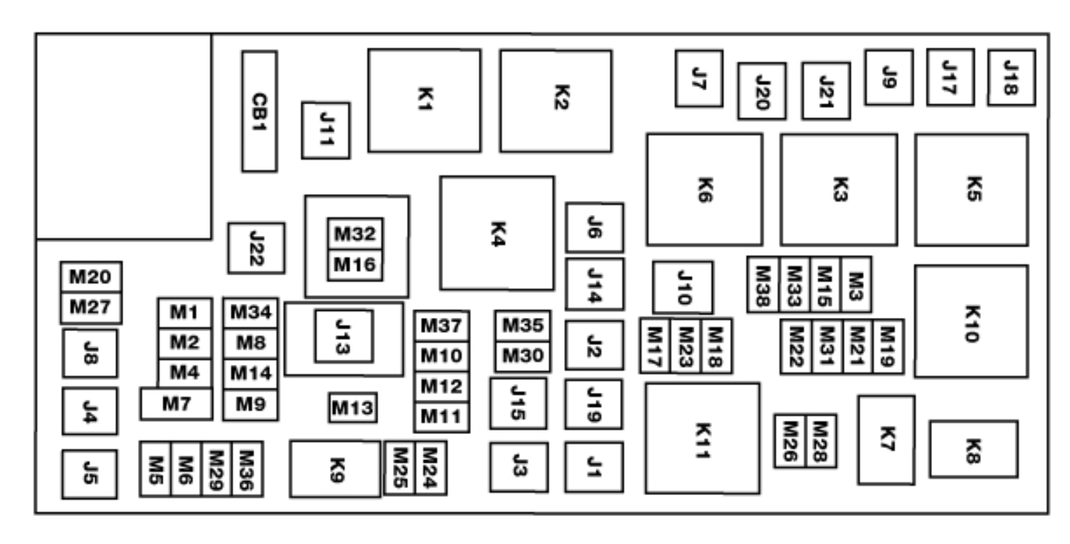

Lets check fuse # J15 to see if its okay if so it sounds like the blower motor or blower motor relay has gone out. To be sure here are three guides to help us see whats going on and the blower motor wiring diagrams below so you can see how the system works with the location of the blower motor and fuse with relay as well (below):
Oct 4, 2019 at 2:17 PM
RYAN EHRLICH
I did figure it out last night! I went through and metered relay to make sure door was opening and closing by ohming everything out along with fuse! Everything ohmed out good! When I went to put the fuse panel cover back on I still had the key on and I heard the blower kick in. So I pulled the actual panel out and found loose and corroded wiring. Cleaned up and all good now! Thanks for the response!
Oct 4, 2019 at 2:26 PM

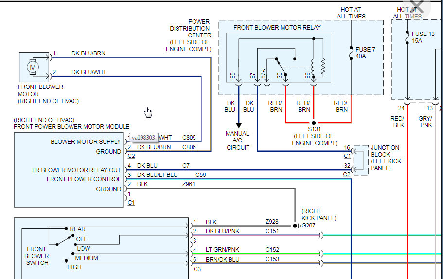

If the blower motor doesn't work at all then this could be the motor, wiring (loose or corroded), or relay, or a module. I highlighted where we need to take voltage readings when the blower motor is turned on. This will tell us what the issue could be. Let me know if you have questions but unfortunately your vehicle doesn't have just a resistor like older vehicles. Your blower motor is controlled by a power supply and then a control module. The blower motor control module gets a power supply from the TIPM and the HVAC control module tells the blower module when and at what speed to turn on.
Let me know if you have questions. Thanks
Oct 4, 2019 at 2:40 PM

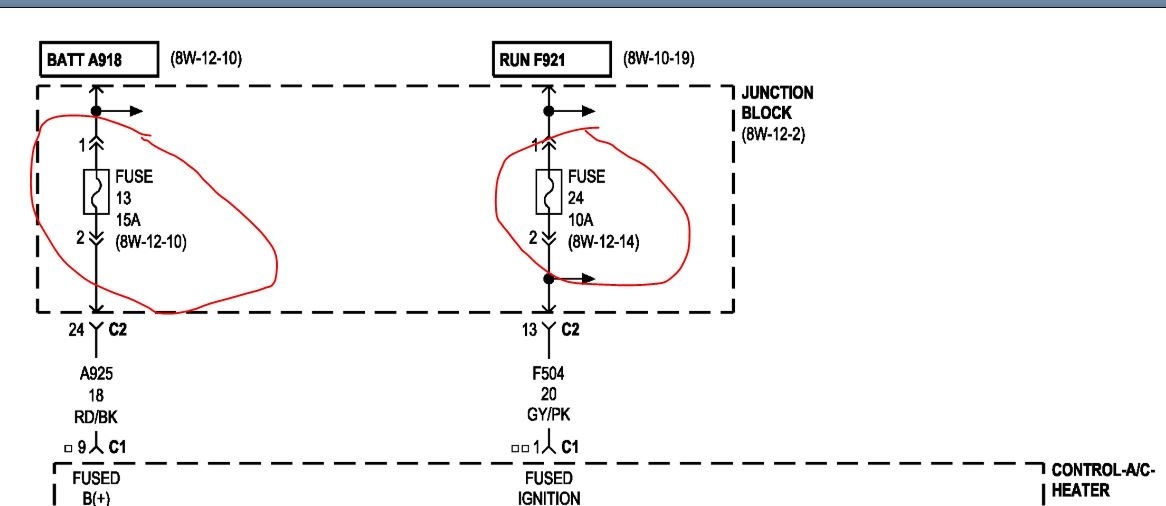

It sounds like either there is no power to the front blower motor or the motor itself failed. Does it run if you put it on high speed?

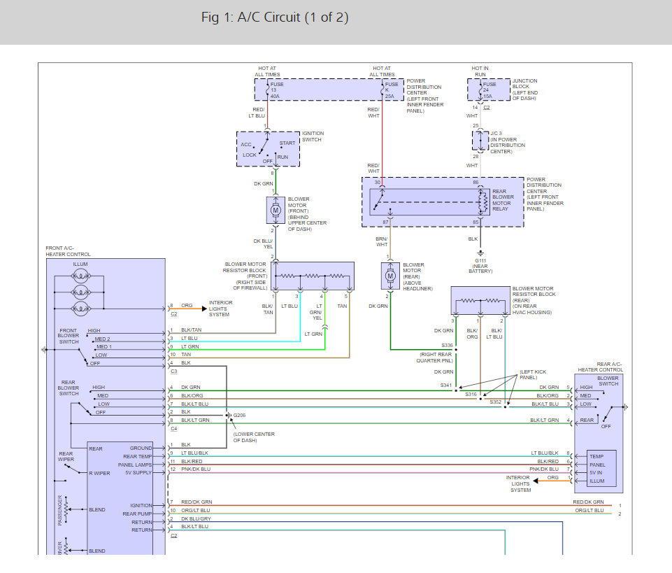

Lets start with the basics. I need you to check two fuses in the under hood fuse box. See the attached wiring schematic for fuse numbers.

Sounds like the blower motor is not running at all. The small amount of air coming out is most likely because the system allows air in and is sped up by the blower fan so that is just the natural amount of air coming into the system.
We need to measure power at the blower motor to find out if we have an issue with the motor or the power getting to it. If there is power there then the motor has failed. If no power then it could be a module issue or maybe a relay issue which is part of the Power Distribution Center (PDC).
Here is a guide that shows how to test wiring. Unfortunately, we need to do some testing because we don't want to just replace parts because of the number of different things that it could be.
Here is a guide that talks about how to test wiring:
Let me know what you find at the blower motor and we can go from there.

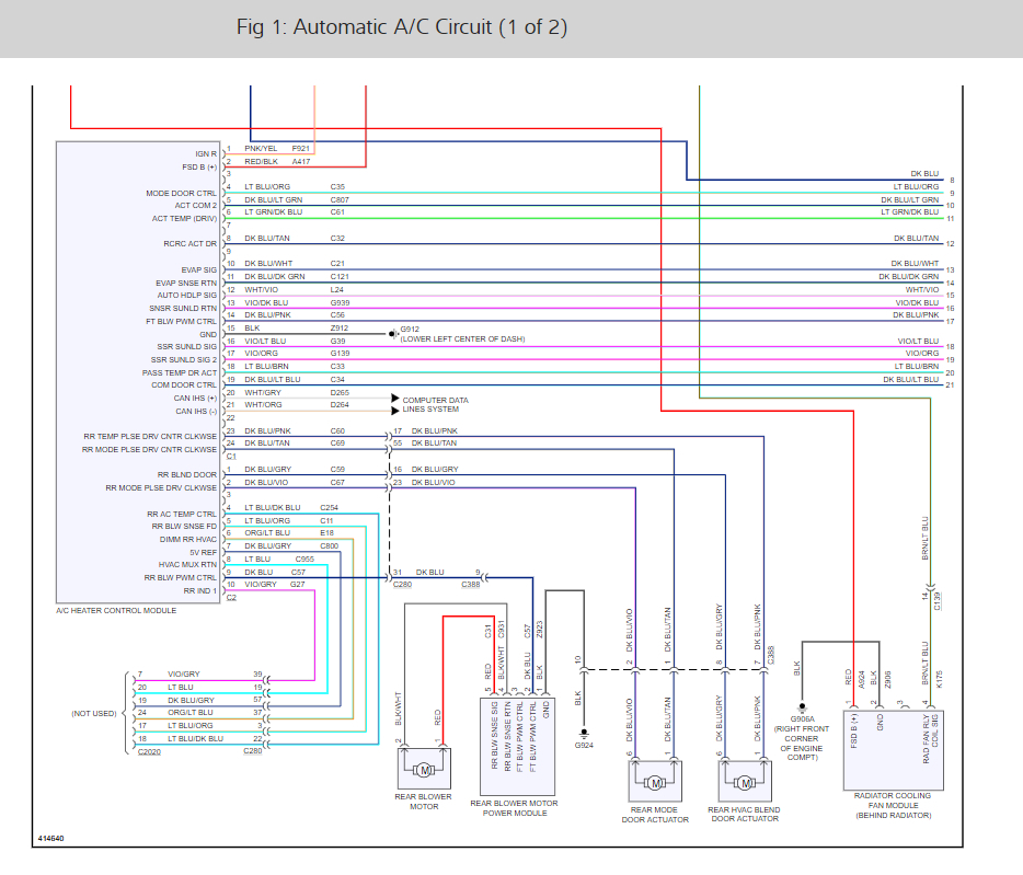

There is a rear blower motor relay that needs to be checked and the blower motor here are two guides that will help us fix the problem with the blower motor wiring diagrams so you can see how it work with eh relay locations as well.
Check out the diagrams (Below). Please run this test and get back to us.

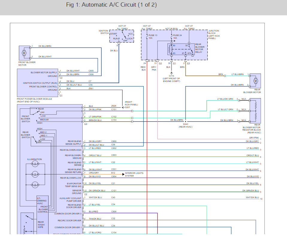

I am having the same problem in my 2001 dodge durango. the front blower motor is not working but the rear works just fine. The front doesn't work on any speeds. Hooked up the blower motor to 12v battery and it fired right up. replaced the resistor and the pigtail harness still nothing. all the fuses are good and no melting on any of the relays. what could i possibly try next?
Aug 6, 2020 at 10:46 AM (Merged)

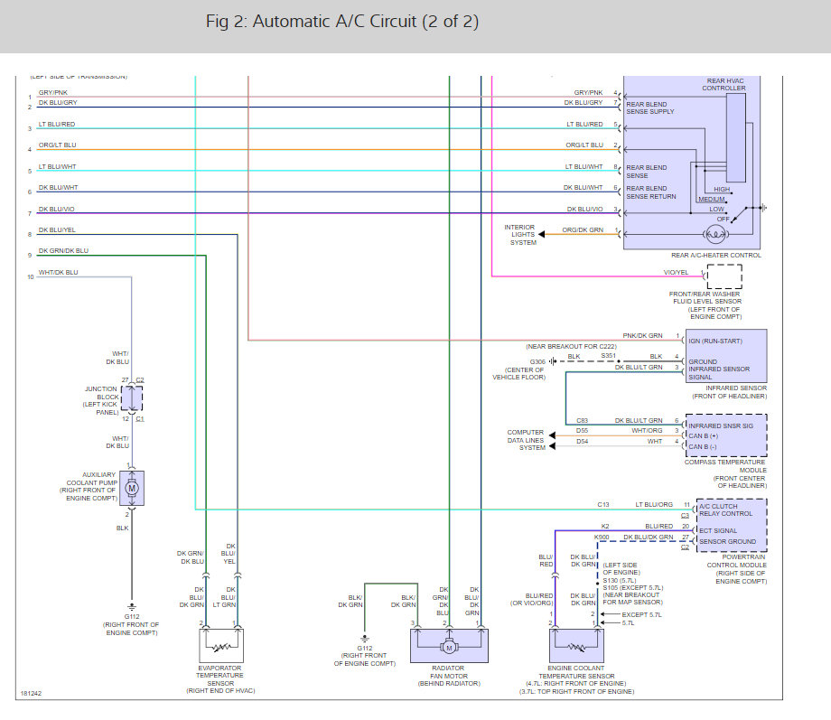

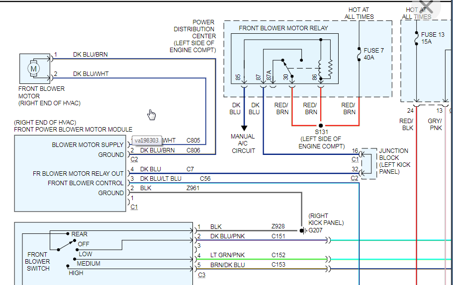

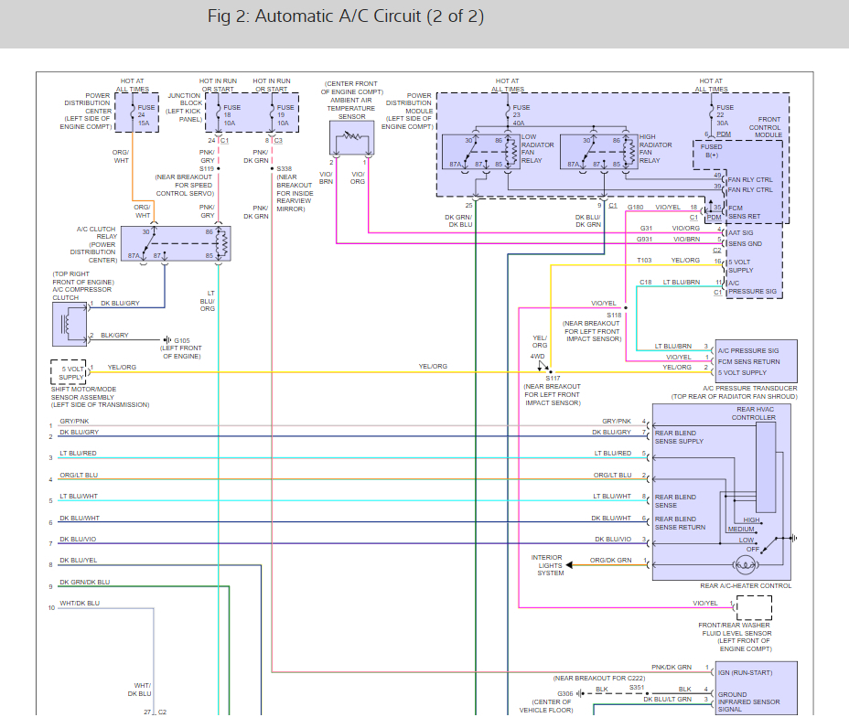

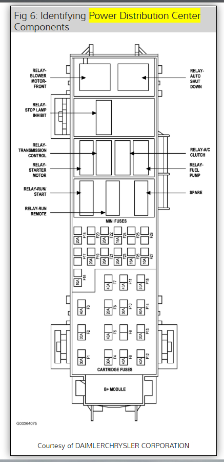

Can you test for power on the dark blue wire going to the power transistor? Test is with the key on here is a guide to help. Check out the wiring diagrams in the second post to see how they system works in this thread.
A.ARON

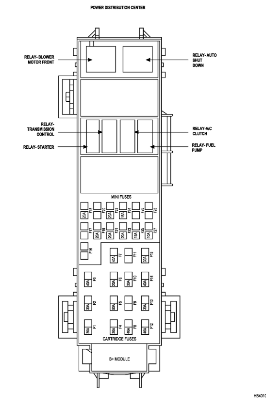

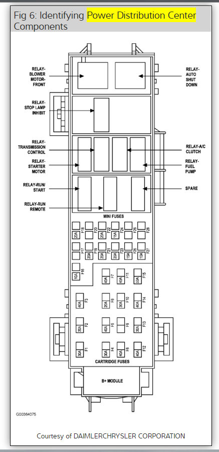

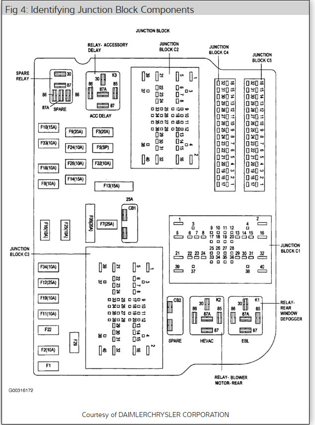

I will have to buy that test light unfortunately I will not be able to do it until tomorrow. Where would be the relay for the front blower? When looking on the fuse box diagram it only has listed for the rear blower motor. I do not believe I am getting power but will know for sure tomorrow.

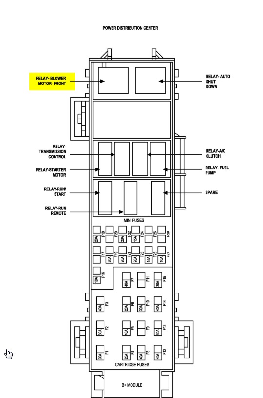

The relay is in the fuse panel in the cab. Here is a guide to help check it and the location of the relay below:

There is no power to the dark blue wire.

That diagram does not match the fuse panel in my 2001 Dodge Durango

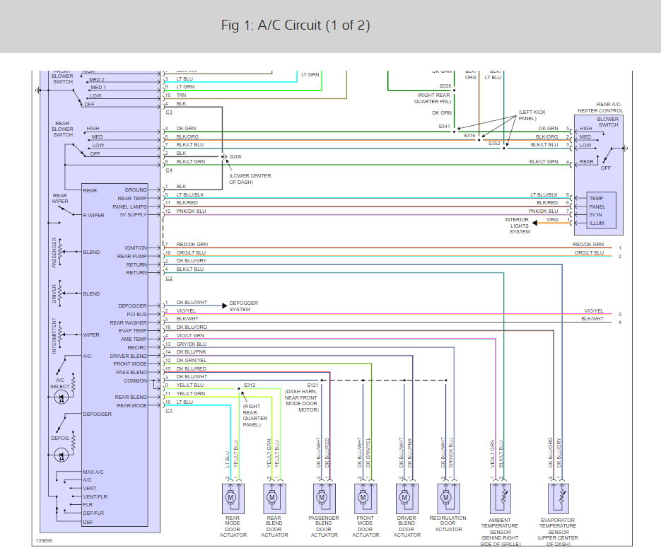

Sorry that was for a 2004 on a 2001 there is no front blower relay only a rear here are the wiring diagrams so you can see how the system works with a guide on how to check for power so you can tell where the problem is. Key on switch on you should have power at the dark green wire

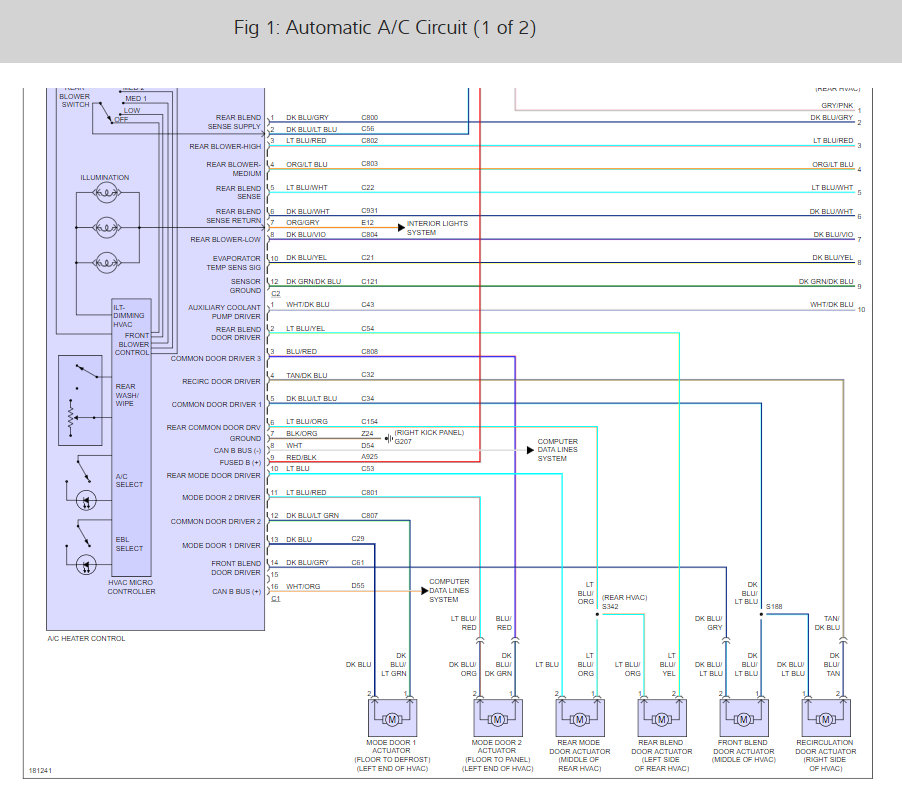

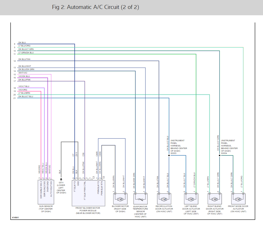

Does it have the manual controls or the automatic heat system. Different power feeds and controls.
Manual control - Fuse 7 (40A) in the PDC on the left fender. It feeds power to the fan relay on the left side of the header panel through a Red wire. Then out of the relay to the blower motor through a Dark Blue wire. The motor is grounded through the Dark Blue w/Gray trace wire through the blower motor resistor in the right side of the HVAC plenum.
To test the feed side you could take a section of wire, connect it to the battery positive and to the Dark Blue wire on the blower motor. If the blower runs and you can change speeds, the problem is the relay, fuse or associated wiring. If it doesn't then the resistor or control switch or ground (behind right kick panel, also grounds rear blower control)
Automatic control - Looks like the blower control module (right side of HVAC duct) the blower motor or the control head would be the issue. They share power with the rear system.
Aug 6, 2020 at 10:47 AM (Merged)
JOHNNY G.JR
  • 320 POSTS
check underside of fuse box cover for diagram
JOEY WARD
Steve, the rear blower works fine and yes, the system is automatic.
OK, you had to have the upscale system... :-)

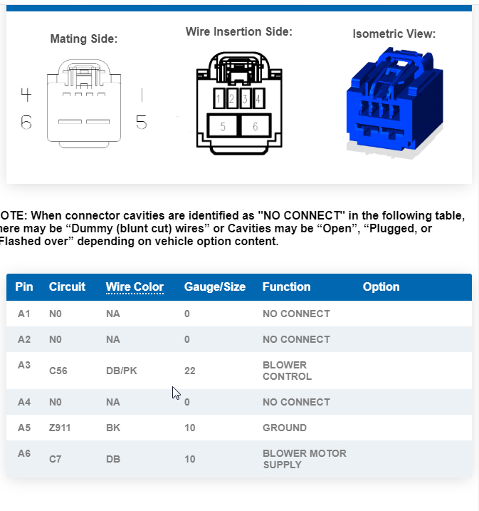

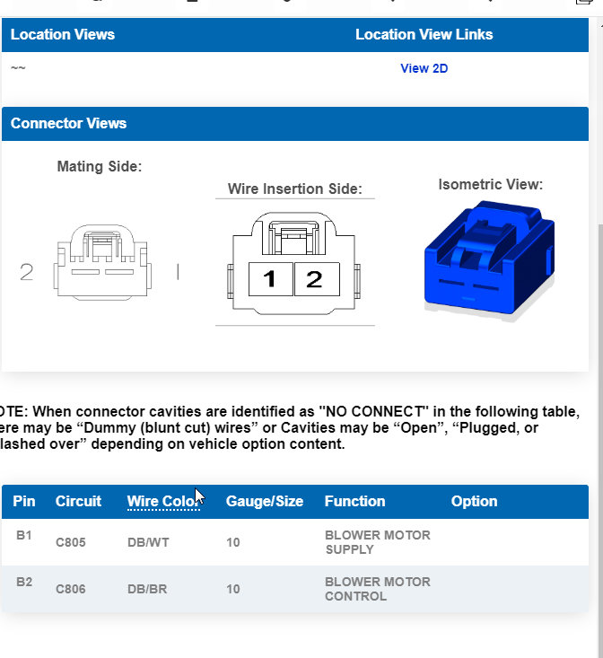

On the right side of the heater box you will find the blower control module.
It will have two connectors on it.
One with 2 wires that goes to the blower motor
The other with 3 wires that provides the control and power.
First check for 12V on the Dark Blue wire with the key on.
If you have power there use it with a test light to check the Black wire for ground.
If both of those check out. Unplug the two wire connector.
Connect a jumper from the Black ground wire to the Dark Blue with Brown trace wire. in the connector.
Touch a jumper wire from the power (Dark Blue) wire to the Dark Blue with White trace wire. If the blower motor starts running the motor is OK.
That leaves the blower control module and the head unit. Depending on how the control system works the next test >>> might

pferdig: Replace blower relay. Look under dash on passenger side. Locate harness with plug into blower box...unplug. Now remove this outlet from the blower box (two screws)...the blowen relay is built into this outlet...replace this part...reassemble and connect. This SHOULD take care of the problem (I've replaced mine twice) To prevent this, do not turn on blower when vehicle interior is HOT...open window and cool down interior before turning on AC and blower...seems to have worked for me
Aug 6, 2020 at 10:51 AM (Merged)
MSP54
REPLACE BLOWER RELAY Look underdash on passenger side. Locate harness that plugs into blower box. Unplug the harness. The "blowen relay" is built into the plugs outlet...remove the two screws on the outlet, pull downwards...remove the outlet and replace with new relay/outlet. Reattach harness. I replaced mine twice. I've learned to NOT turn on AC/blower when vehicle interior is excessively hot...I now open window and cool down interior, then turn on blower fan ONLY for a moment to purge hot air. Once reasonably cooled down, then turn on AC....good luck.
