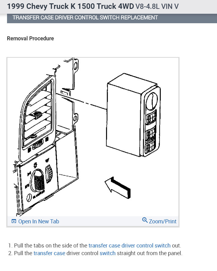

I had this truck with this problem. I replaced the control switch and it fixed it. here is how in the diagrams below. Check out the diagrams (below). Please let us know what happens.

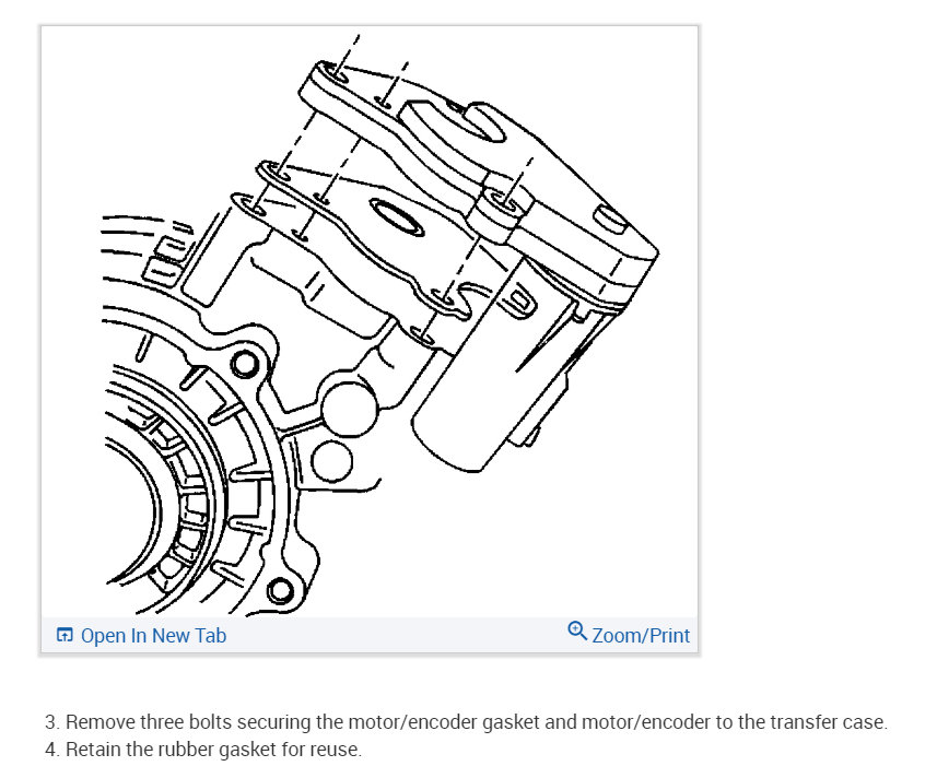

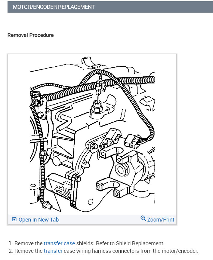

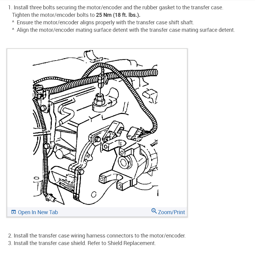

The system doesn't work that way, it sounds like the encoder is out. Here is how you replace it. Check out the diagrams (Below). Please let us know what happens.

is it possible you put the encoder motor in wrong. try starting from the beginning. remove the encoder motor and with it plugged in put it in 2wd then make sure the transfer case is in 2wd then reinstall it.
