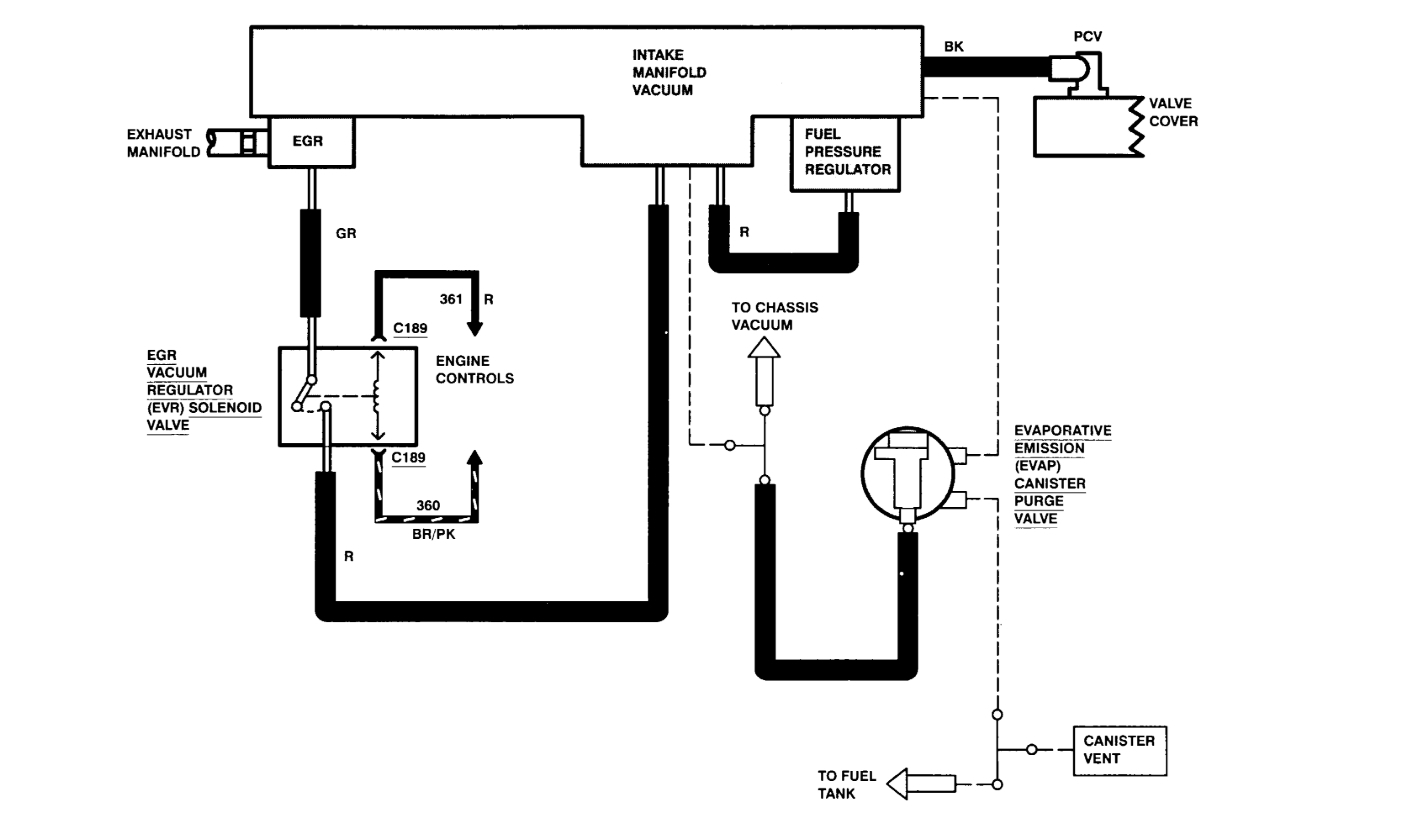

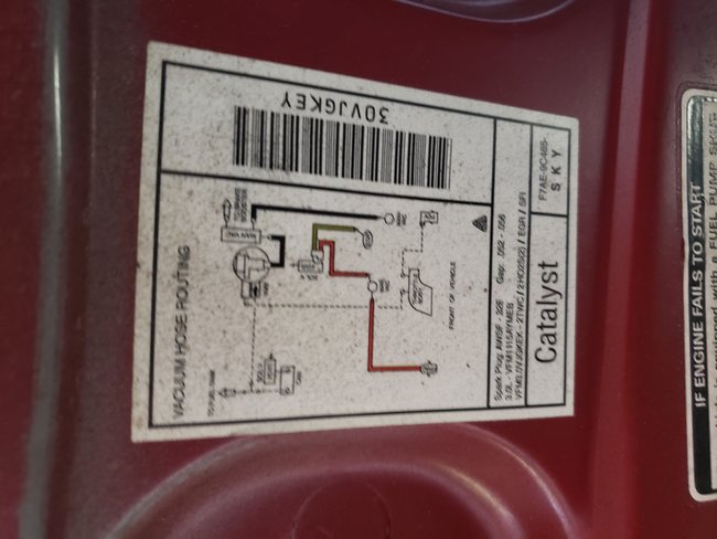

Just changed the EGR and the DPFE sensor. These lines don't add up. I have the diagram here and it doesn't make sense. It's almost like I'm missing a line. In my photo the red line has a 90 deg bend into the intake, and also there is a red line coming from a solenoid next to the fuel rail. That red line ends.. open? I have 2 fittings here I found sitting on the transmission. One with green plastic but the plastic line is hooked up.

Okay, I may have jumped the gun and asked this question, I found the remainder of the line which is a connector to the rear of the intake with a red line. however the picture with 2 fittings I pieced together to join the remainder of the red line together. Is that how it is supposed to go? It seemed to run fine. My engine light is staying off but for some reason when I do an OEM Enhanced scan it shows P1519 showing up.

  • 4,897 POSTS
I have included the vacuum hose diagram for your vehicle in the diagrams down below. The DPFE sensor should just have an electrical connector and two hoses that go to the exhaust manifold as it measures the exhaust pressure in your vehicle. There should be no vacuum lines going to it. I hope this helps.

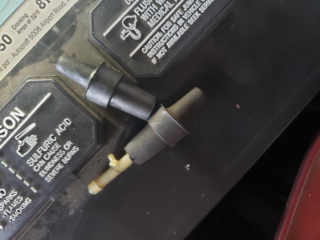

Has nothing to do with the DPFE, only the green and red plastic lines going to the intake, FPR, EGR, and solenoid. I pieced those two black plastic fittings together to join the remaining red line.

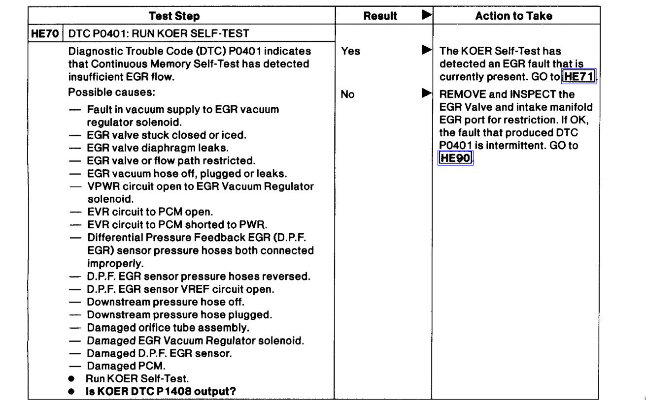

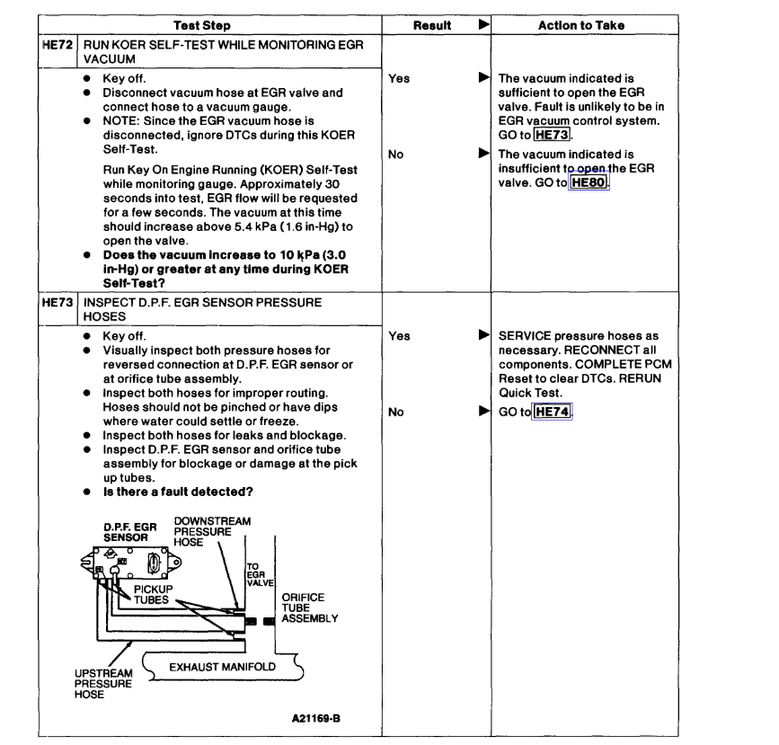

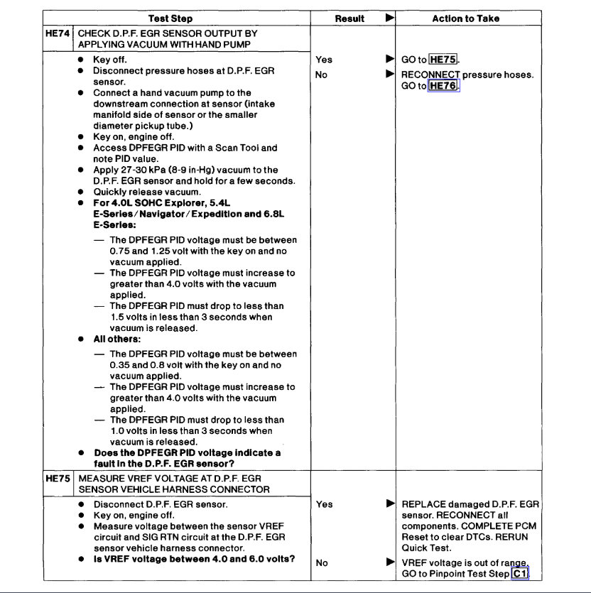

Hello again,
In the diagrams down below I have included the diagnostic troubleshooting guide for DTC P0401 from the vehicle manufacturer. Please go through the guide and get back to us with what you are able to find out.

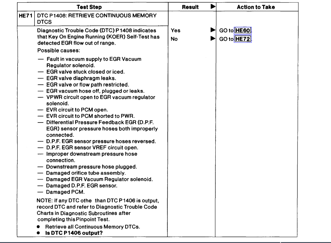

seems like p0401 may be intermittent. What does HE90 say? It may come on after a couple weeks, or months, sometimes every other day. It's never consistent. I almost think it's the control solenoid because that's the last thing to replace. I don't have vacuum gauges and you can forget getting a multi-meter on the DPFE sensor.

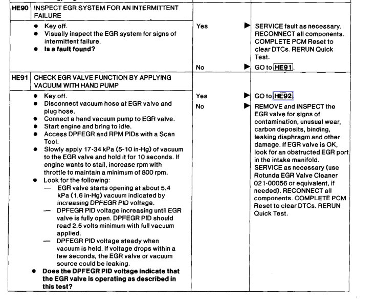

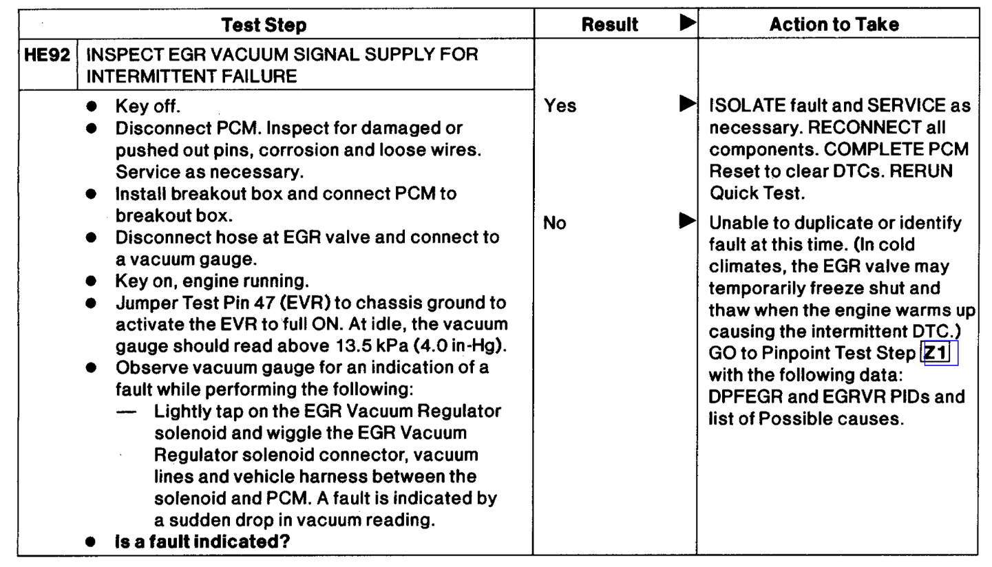

Hello again,
Okay, so I have included HE90-92 in the diagrams down below. Please go through this guide and get back to us with what you find out.
Thanks,
Alex

Hello again,
I'm sorry about that. This happens to me from time to time. Here they are. A little trick that I've used before is where they want you to install a breakout box is to use the PCM electrical connector and small safety pins instead. The breakout box is a box that goes inline in between the PCM connector and the PCM with big holes for every pin on the PCM. You can stick the leads of your DMM into the holes and it is the same thing as inserting them into the PCM connector, but without the possibility of damaging the PCM electrical connector. Using small straighten out safety pins, and I emphasize small, you should be able to insert the safety pin into the corresponding PCM electrical connector female pin and then touch with the DMM lead and accomplish the same thing. The small safety pin will fit snug and will not damage the PCM electrical connector female pin. This is extremely important and please be very delicate when you do this. Please get back to us with what you find out.

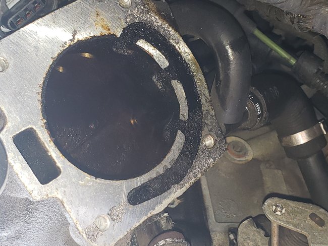

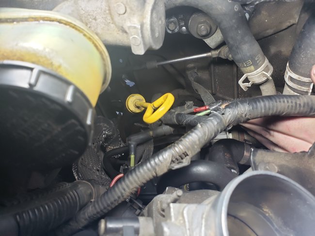

Well, the light hasn't come back on yet. I cleaned the EGR port on the intake. It was pretty dirty. Also, I found that a metal arm attached to a lever was disconnected. It looks like the lever is attached to an "intake manifold runner control valve", Part # 911928. This arm is held in the lever by two little white bushings (part #47099). Do you think that has anything to do with it? The car seems to start right up very quickly now.

Hello again,
Absolutely. The intake manifold runner control is vacuum operated and if there is a leak there, then that's a vacuum leak and that would cause your vehicle's symptoms.

Visiting this again because it's still happening. Read something somewhere about the C channel might be clogged. Look at this!! This apparently goes right to the EGR. Hope cleaning this will do the trick.
