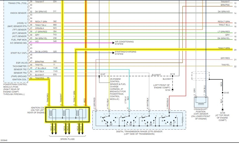

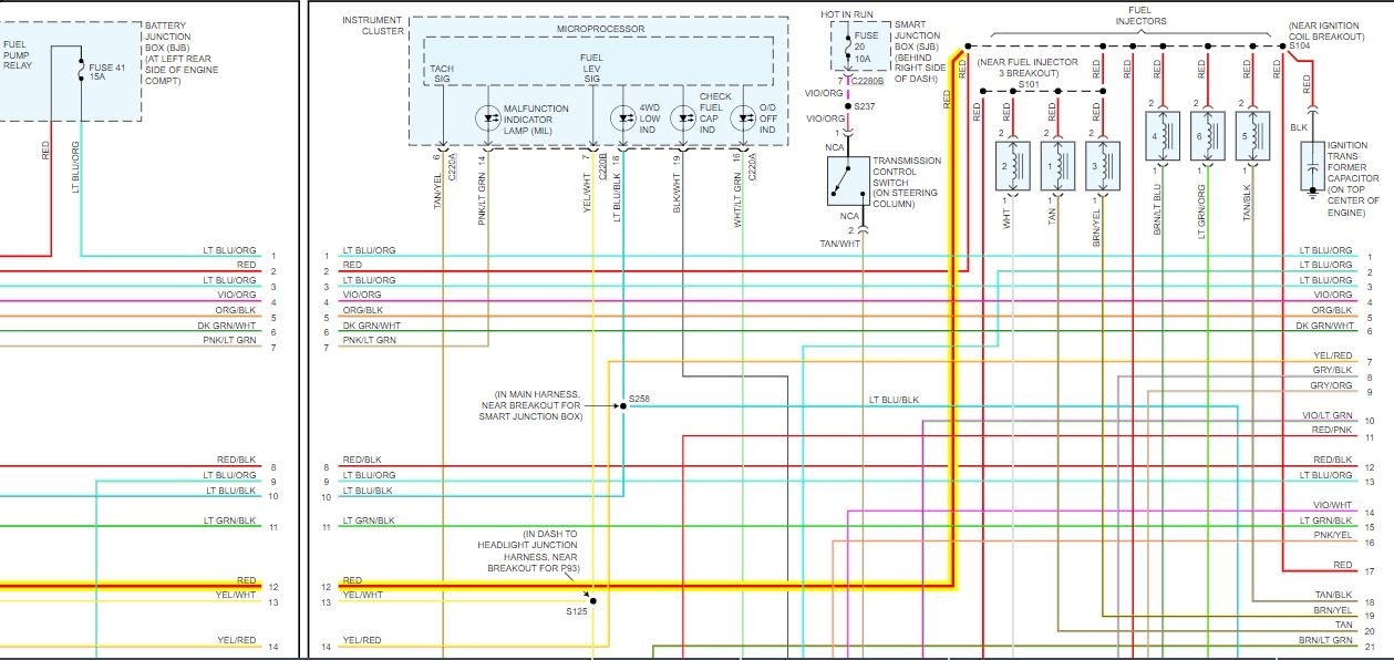

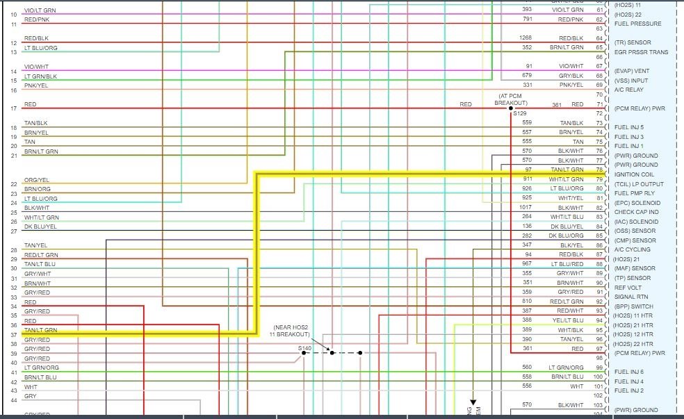

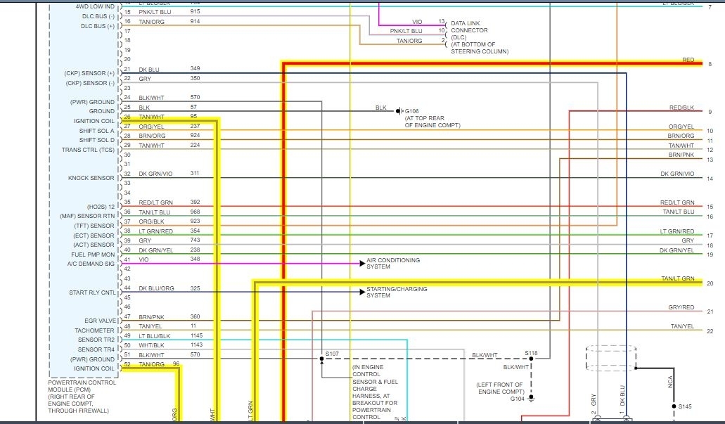

No spark on three and four when tested with HEI spark tester on coil. Have changed out coil pack, plug wires and plugs. Using procedures on easy auto diagnostics.com there is no signal present on pin 1 per their procedure (no light flashing when engine started).
I would like to chase that red wire back to PCM, but would feel more comfortable with a diagram which shows the pin out supporting the ignition function.
Jul 29, 2020 at 10:53 AM (Merged)
Good morning,
I attached the diagram for you of the wires from the coil to the ECM.

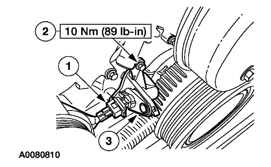

I would also consider the crank sensor. That is the sensor that sends a signal to the ECM for cylinder location and to ground the coil so the spark will occur.

Thank you Roy. after looking at the diagram, I figured out I am an idiot! Having a background in electronics I seemed to ignore what a red wire typically indicates (B+). so, my test had no value. I am going to start over and pull codes for key on, engine off and the engine running check.
I noticed the wire colors on diagram do not match those on my vehicle. starting with red, next is white/orange, then white/green, and last is white/tan.
