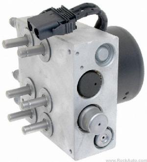

Joe, Now I am stumped. Raybestos has stopped remanufacturing the actuator and OEM suppliers are saying that Ford the part is no longer available.
Any idea where I can get a replacement? Something is wrong here and no one is talking. I am wondering if these are a bad design and no one is talking?
Chuck
Apr 14, 2021 at 10:15 AM (Merged)
I don't know of any specifics. The manufacturer is required to make replacement parts available for 10 years. That makes the end of this year 10 years. I would contact the customer service rep listed in the owner's manual and see what they have to say. Also, have your dealer search their computer to see if there is another dealer in the country that has "Dealer Old Stock" (DOS). I feel confident they could find them that way. The truck isn't that old. Also, have you checked salvage yards?

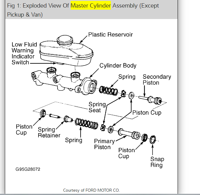

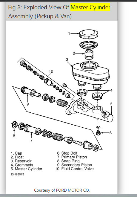

I have also included exploded diagrams of both brake master cylinders that are used on your vehicle as well as a factory troubleshooting guide for the master cylinder in the diagrams down below for you. Please go through these guides and get back to us with what you are able find out.

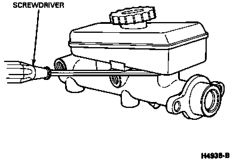

1. Disconnect the brake warning lamp indicator wire from the plastic reservoir fluid level indicator socket. Drain the brake fluid from the brake master cylinder.
pic 1
2. Using a large screwdriver, pry between the brake master cylinder reservoir and the brake master cylinder and remove the brake master cylinder reservoir.
Master Cylinder Reservoir
Pic 2
CAUTION: Whenever the brake master cylinder is replaced, the brake tube grommets (2k409) must also be replaced or leakage may occur causing brake system failure.
