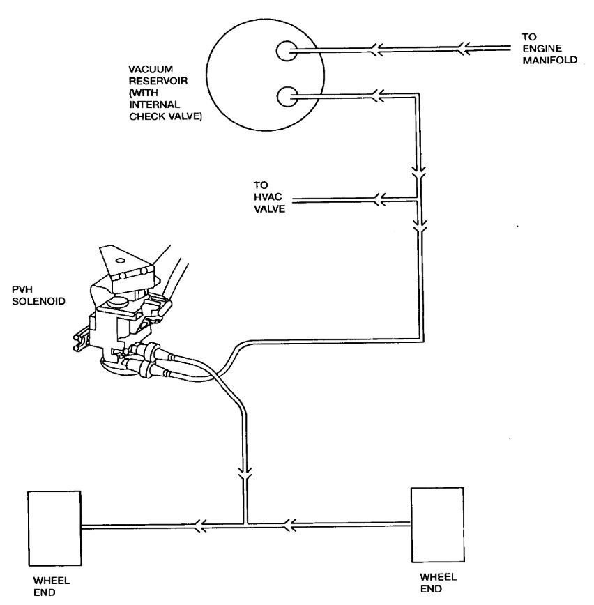

Okay, to start vacuum hubs work by first when you put it in four wheel drive the engine vacuum pressures up a canister with vacuum and the vacuum stays sealed in the canister throughout the lines to the hubs, when engaged the vacuum pressure engages the hubs, but if a hose is broken the vacuum leaks out until it has no pressure and hubs unlock, i have an 1998 four wheel drive and i know this by experience. so anyone can call me on it but i found when i got mine that the right tire hub, the vacuum hose to it right where it connects to the tire was cracked and it bleed the vacuum and hubs just disengaged so to start i would remove front tires and look on inside of assembly at vacuum lines for crack or anything then if no problem trace lines to engine looking for any problem if no problem remove vacuum line from engine and see if it is even getting vacuum. try this and get back to me.
vacuum reservoir tank and bracket is located either on or beneath the RH front fender splash shield.
See the vacuum diagram below
