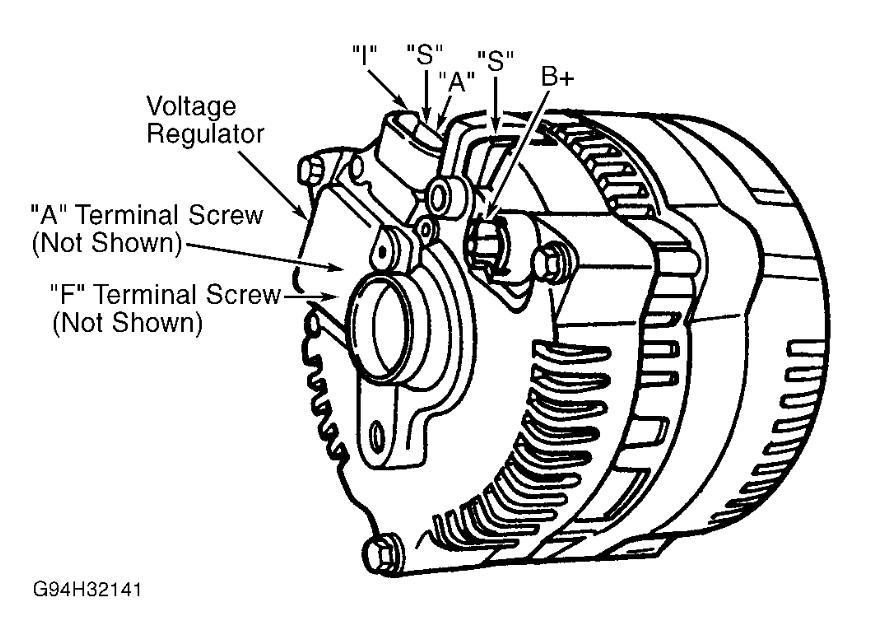

the alternator is external but the regulator is internal and probably soldered inside. he should be able to see it if he looks under the hood.Disconnect negative battery cable. Remove accessory drive belt. Remove power steering pipe support brackets from exhaust manifold. Remove 3 nuts and exhaust manifold heat shield. Raise and support vehicle. Disconnect electrical connectors from generator. Remove lower generator mounting bolt. Lower vehicle. Remove wire harness clip from generator mounting bracket, 2 mounting bolts and generator from vehicle. To install, reverse removal procedure. Tighten fasteners to specification.
print this part as it shows how to take it off. unless this is a 2.0L Ztec engine. pictured is a typical alternator
