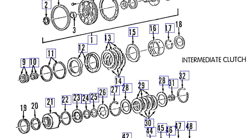

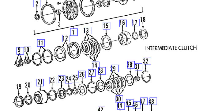

No, the OD light blinking indicates the overdrive clutches or band may be the issue especially if the clutches are slipping. very common issue with these transmissions.
I attached a diagram for you to view. 13 through 16 is the area behind the front pump that is the overdrive clutches.

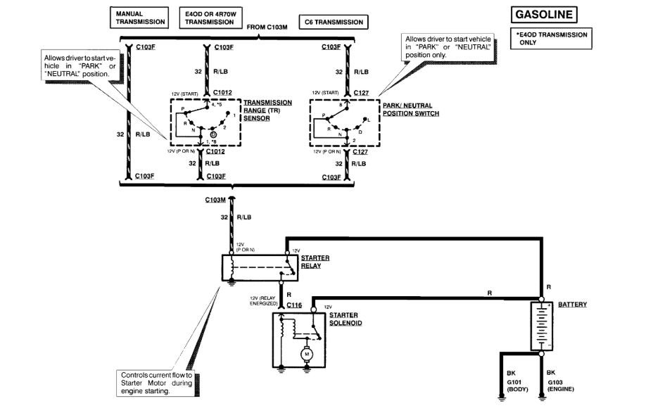

Good afternoon Roy,
I forgot to mention that during the replacement and flush of the transmission I noticed there was a problem with the wiring harness that connects to the MLP sensor (neutral safety switch), so I bought a new harness part# WPT389 connector by MOTORCRAFT. would it be possible to get a diagram showing how to replace and rewire it the correct way? I do not want to mix the wires. I tried looking for one on the internet but it shows different ways and I just do not want to get it wrong.
My truck has a 4R70W automatic transmission.
Mar 24, 2021 at 1:46 PM
(Merged)

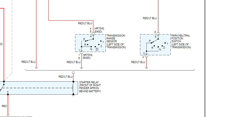

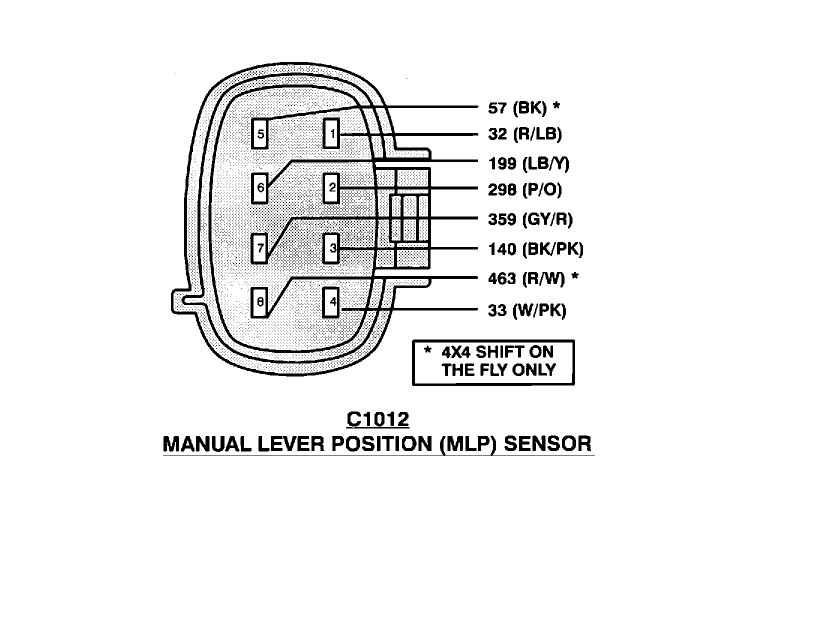

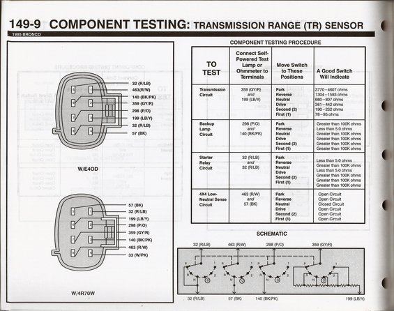

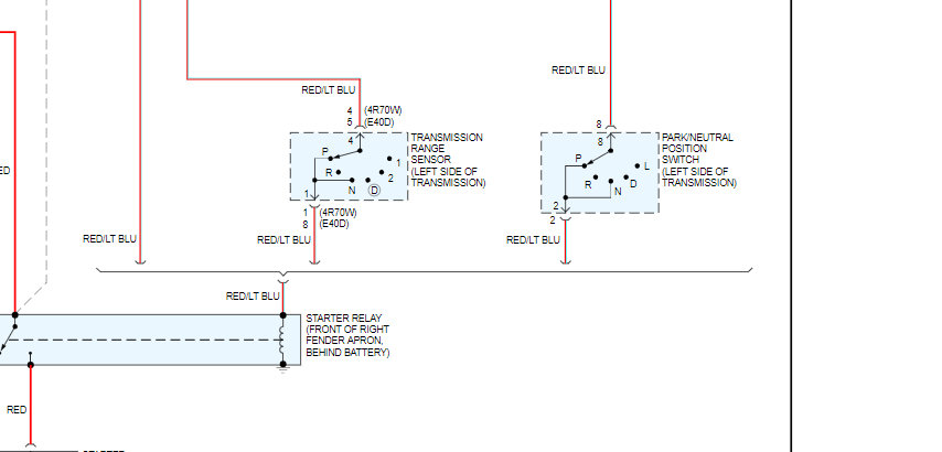

I have this picture here. I'm just unsure if its the correct way to rewire the MLP connector, does it matter if I use but connectors or should I solder it. Because the truck was doing well after the transmission flush and replacement of the fluid. However now after trying to install this new MLP connector and repair all the broken wires. the truck starts up but when in drive. I cannot hear the truck shift gears again it continues to rev high as if the over drive is engaged and it has brought me back to the previous problem that I have tried to repair.
(Merged)
Do you realize that is the connector for the four wheel drive connector on the transfer case?
you need to be looking at the neutral safety switch on the side of the transmission.
no, solder and shrink wrap the connections.

Do i need to test red and light blue wire in order to find out if there is an issue with it? Because the only two wires I've been messing with are the PIN#5 - 57 (BK)* and the PIN#8 - 463 (R/W)*. I tried swapping the position on both of those due to not knowing where they went but now I know those are not the problem, I'm going to leave those alone and test out PIN#1 - 32 (red and light blue ). I'll check it on the transmission range sensor. I do have them with butt connectors so the best thing for me is do it again but check the red and light blue first then solder and shrink wrap everything once again and do it the right way.
it looks like that image you uploaded shows the red and light blue wire on two different types of transmissions?
Thank you Roy and sorry for all the annoying questions.
Ulysses
Ulysses
(Merged)
that sounds good. do that test and see.
