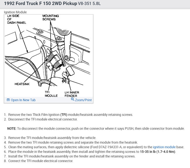

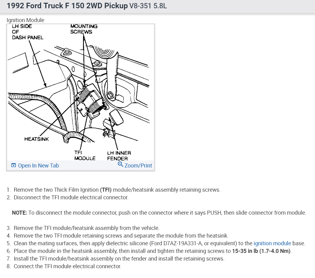

New fuel filter, fuel present at rail. New Throttle position sensor. Recently new tune up which included plugs, wires, cap, rotor, oil and oil filter, air filter, new battery with clean connections.
Engines starts ok, drives great for about 2-3 miles. Then starts missing very badly will not accelerate and eventually dies. Cannot be restarted until the next day.
Need some advice as to where to begin? Any help will be greatly appreciated. Thanks very much.
