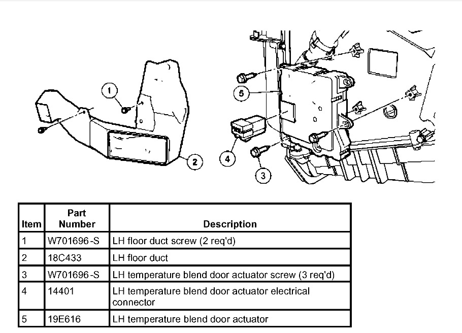

DOCFIXIT
  • 18,828 POSTS
Blend door actuator electric motor that moves door from AC to heat.
https://www.2carpros.com/forum/automotive_pictures/198357_Graphic_234.jpg

04BLKFRDEXPLR
I am having the same issue...heat doesnt work...but the ac seems to be working fine and there is a knocking/clicking sound as soon as you turn the truck on...is the pic above from the glove compartment area or the drivers side and can i get to it thru the glove compartment or do i need to remove something else

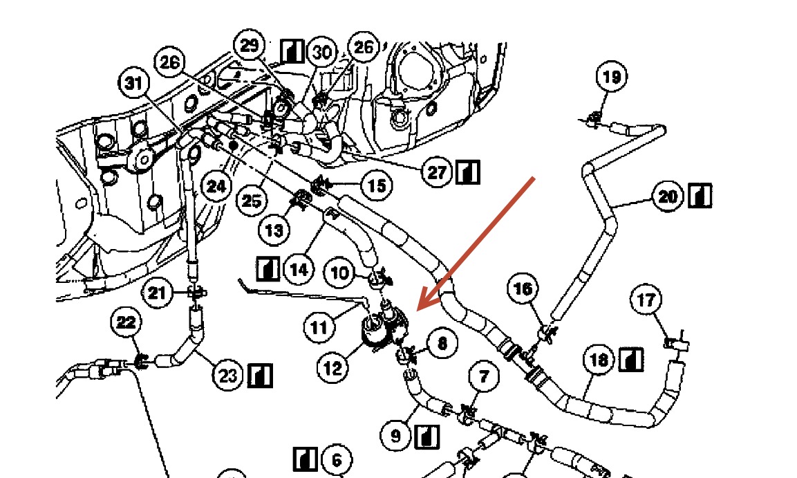

HMAC300
  • 48,601 POSTS
this can be a couple of things. you have a water valve item 12 in pic see if is passing water through it so it will be hot both sides. then there are temp actuators on LH (shown second pic) and Rh they may not be working. But pull the hvac fuse for 60 seconds with key then reinstall sometimes these reset. Otherwise they may not be working.
