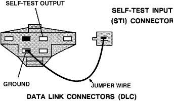

Do you have the 2004 computer, wiring, and sensors in the Ranger? Is it the correct computer for the type of transmission you have? Is this a "new" symptom, or has it been this way since installation?
Next, I suggest that you put some diagnostics on the engine. This has the sound of a bad mass air flow sensor. Also, you should never clean the throttle body. Cleaning it will cause idle problems and hesitations.
