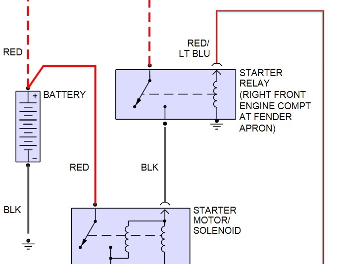

I found this wiring diagram. You see the relay, the load side, the load side of relay is the arm with the arrowhead on it. When the relay is activated that arm moves to the other terminal carries voltage to starter motor.
The relay part I looked at, the two large terminals are main power terminals. The smaller terminal should be relay control. If you use two large shank screwdrivers, the screwdrivers will carry a lot of amps. Touch one screwdriver to each large terminal, let the screwdriver shanks touch each other, the starter motor should crank. If it cranks at least you know that part of the system is ok and the engine isn't seized. If the key is on when you try this, it may start. Just make sure the tranny is out of gear and parking brake is set before testing. There are safety issues with trying this. Safety is your responsibility. I can't see what your doing from here.
