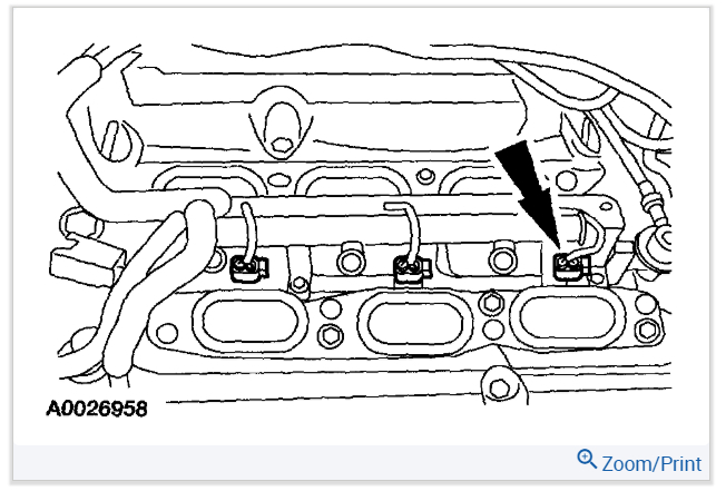

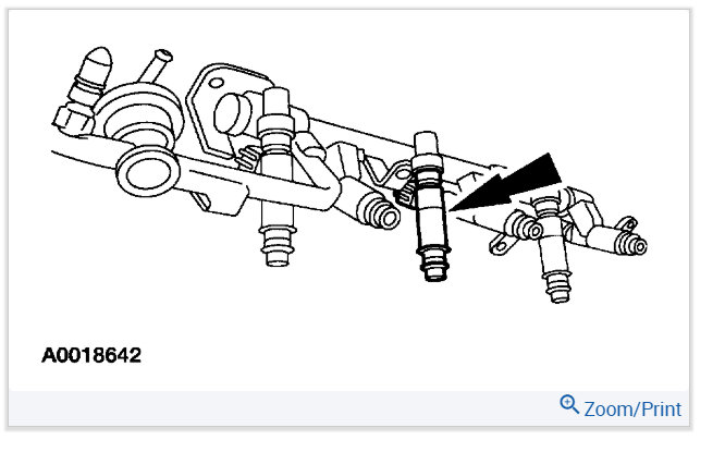

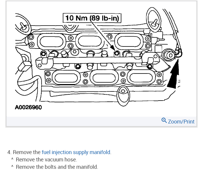

This sounds like you have a fuel injector that is not working right if you pull the spark plug is it white like nothing is happening in the combustion chamber?
If so I would remove the injector to test it here is a guide.
https://www.2carpros.com/articles/how-to-test-a-fuel-injector
Check out the diagrams (Below). Please run this test and get back to us.

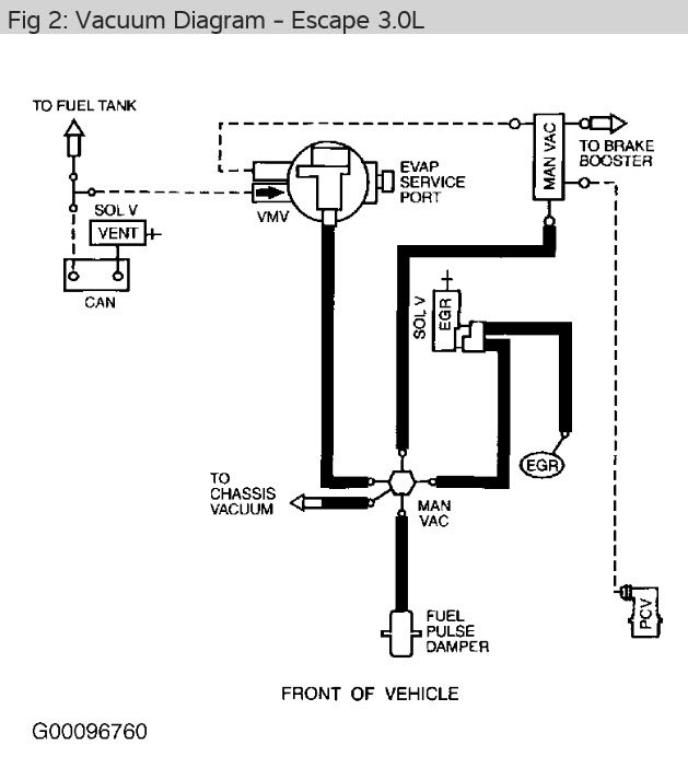

and could fuel pressure cause one cylinder to misfire I'm seriously asking the head because most vehicles that I've had misfire they were random misfires when it was a fuel issue but like I said I'm not an expert I have no clue I'm just trying to figure it out I'll get a fuel pressure tester tomorrow I'm pretty sure its not a compression problem because it doesn't have any of the symptoms of a compression problem it has power loss of power I live in Pennsylvania and I can go up a pretty steep hill at 50 miles an hour and no problem I'm really thinking it's something stupid I was wondering if you could tell me what vacuum lines on there are supposed to have vacuum if I pull them off and put my finger on it I do not know much about vacuum lines but I know that I checked a couple of them and the lines coming from the valve covers that go it into a tea that go into the air breather they don't have any vacuum on them the EGR doesn't have vacuum when its idling but I'm not sure if that's supposed to the only ones that I seen that have vacuum or the brake booster and the one that goes from the throttle body to what I'm assuming is some fuel modulator
Jul 19, 2018 at 2:19 PM (Merged)
HMAC300
  • 48,601 POSTS
the lines going from the valve cover to air duct /breathers are not vacuum only the pcv is if you are good with a scanner freeze frame it and check your voltages if a sensor is bad can cause that also check grommets for air leaks. i'll send a vacuum diagram in next email because our site has changed and I can't do it on a reply.
HMAC300
  • 48,601 POSTS
see pic
