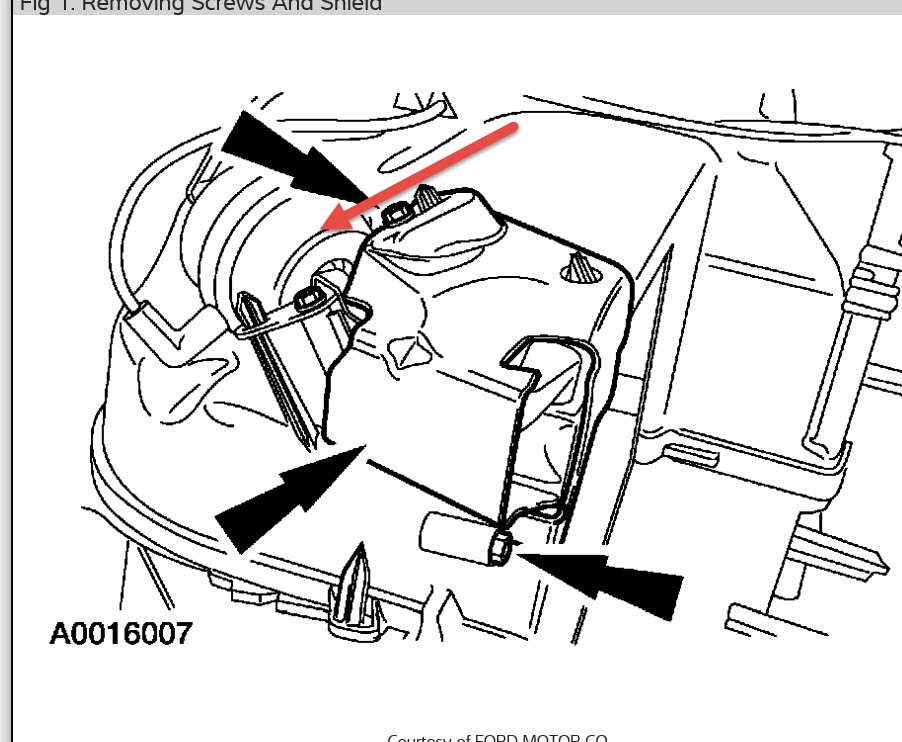

I have replaced the blend door actuator on the right side. I also attempted to re-calibrate the actuators. However, I still can’t get the air to blow anywhere except the defrost. It doesn’t matter which mode (A/C, heat, defrost). What’s the next step please?
Thanks,
Mark
Mar 25, 2020 at 11:10 AM

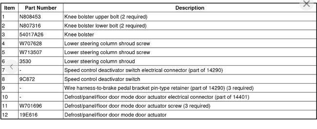

Good afternoon,
The actuator for the modes is the most common failure for this issue.
I attached a picture of the location and the procedure for you to follow. Most parts stores will carry the part.
Mar 25, 2020 at 11:16 AM

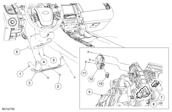

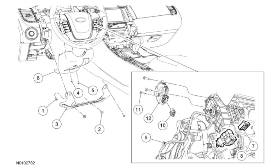

I believe you looked at the wrong actuator. The actuator in this case is called a mode door actuator and more centered behind the dash and closer to the driver's side. Take a look at picture 1. I circled the actuator in question. Is that the one you checked?
Here is a link that reviews and discusses this exact issue. Take a look through it.
https://www.2carpros.com/articles/air-vents-stay-in-the-defrost-position
___________________________

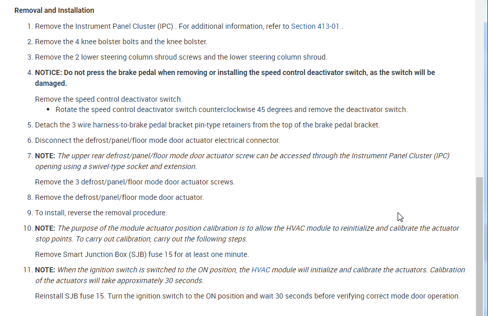

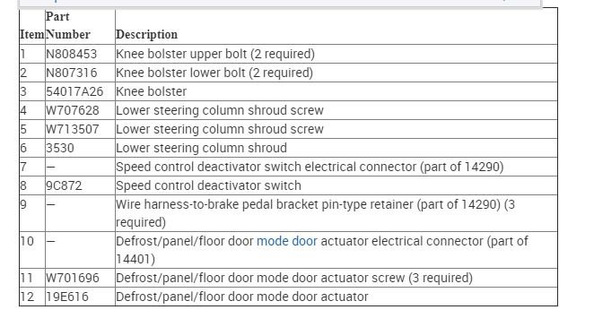

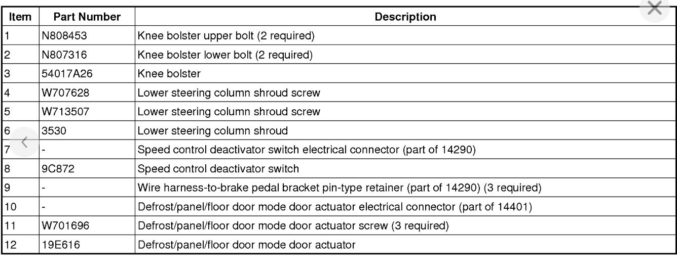

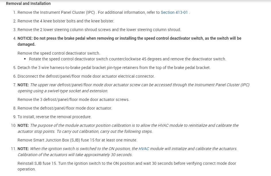

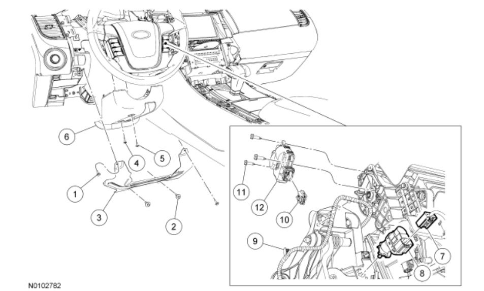

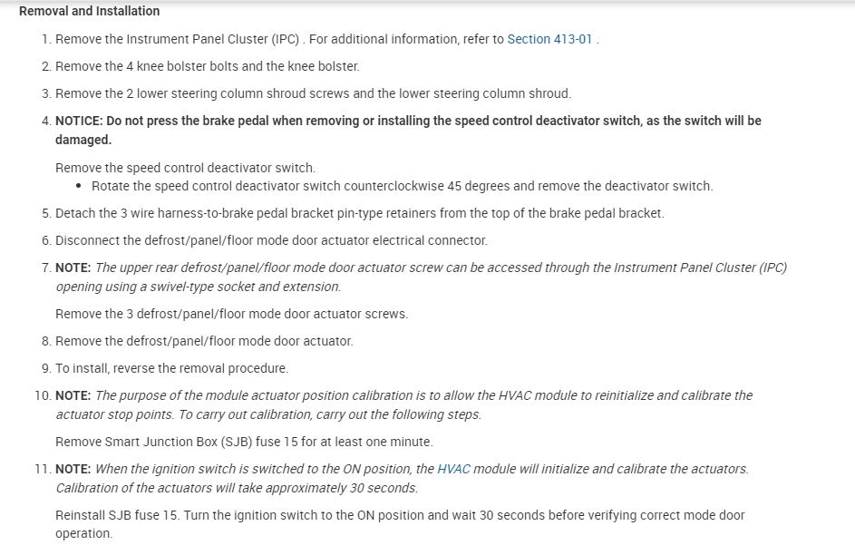

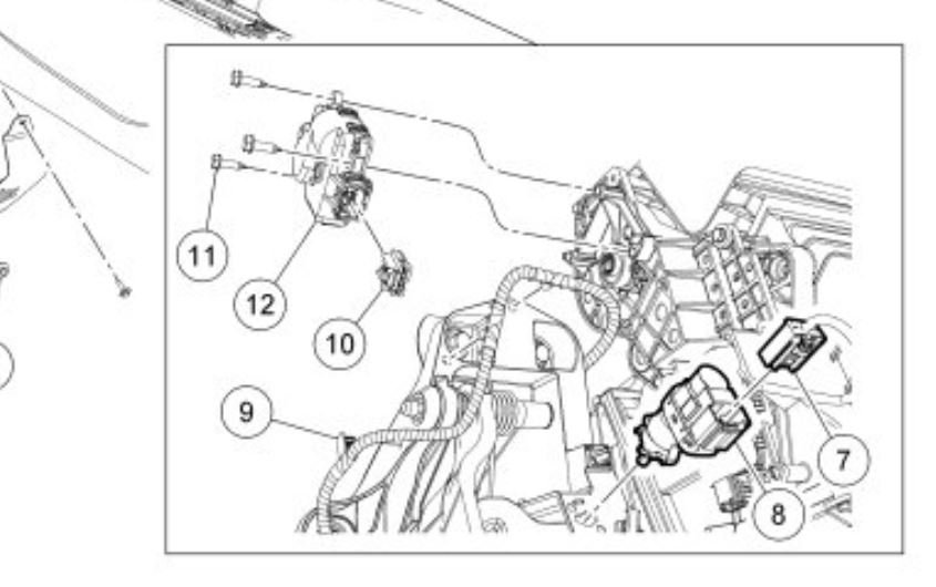

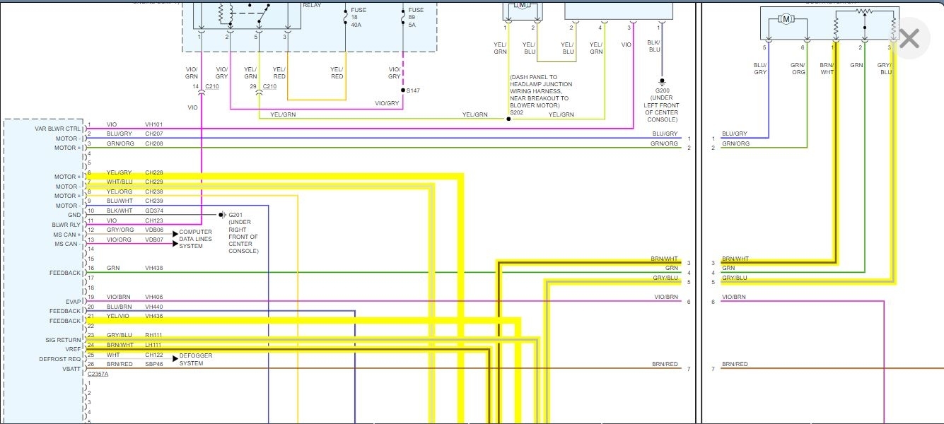

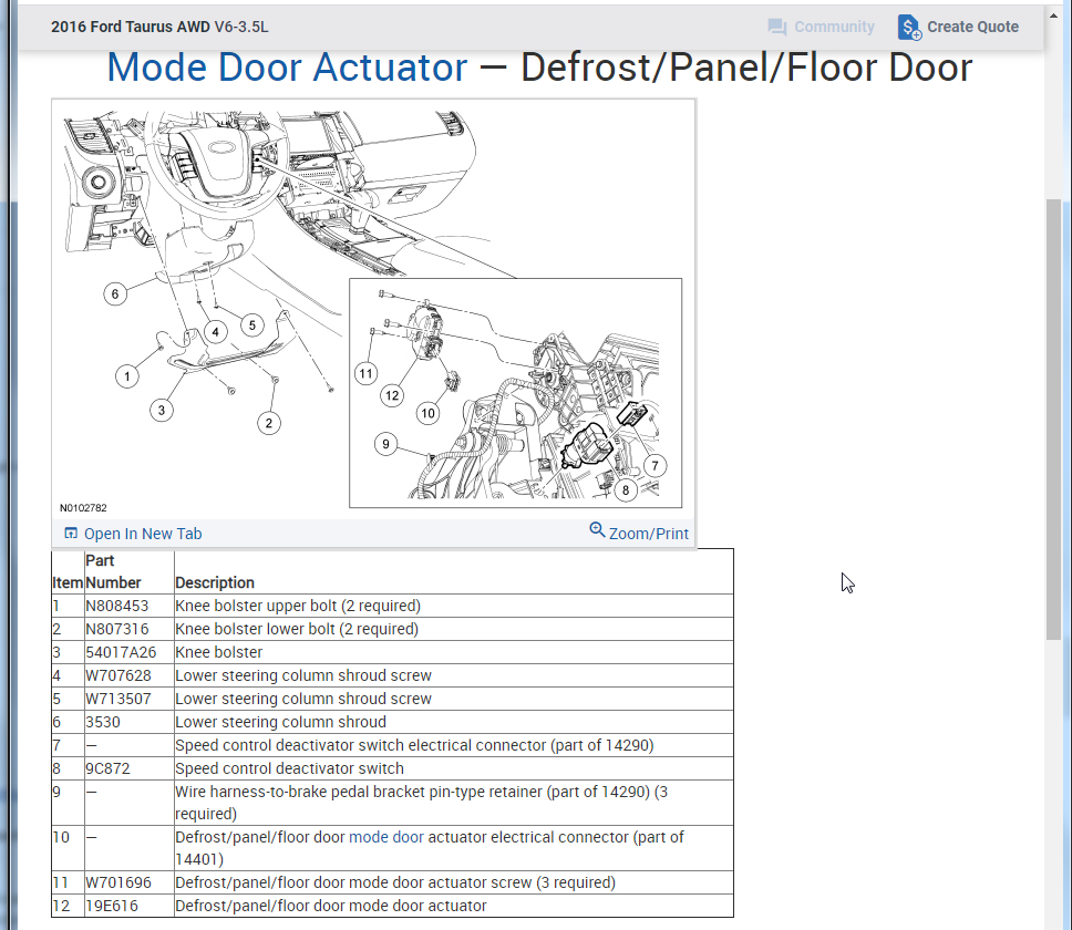

If it isn't the one you checked, here are the directions for replacing it. Pic 2 correlates with the directions.
Removal and Installation
Remove the Instrument Panel Cluster (IPC) . For additional information, refer to Section 413-01 .
Remove the 4 knee bolster bolts and the knee bolster.
Remove the 2 lower steering column shroud screws and the lower steering column shroud.
NOTICE: Do not press the brake pedal when removing or installing the speed control deactivator switch, as the switch will be damaged.
Remove the speed control deactivator switch.
Rotate the speed control deactivator switch counterclockwise 45 degrees and remove the deactivator switch.
Detach the 3 wire harness-to-brake pedal bracket pin-type retainers from the top of the brake pedal bracket.
Disconnect the defrost/panel/floor mode door actuator electrical connector.
NOTE: The upper rear defrost/panel/floor mode door actuator screw can be accessed through the Instrument Panel Cluster (IPC) opening using a swivel-type socket and extension.
Remove the 3 defrost/panel/floor mode door actuator screws.
Remove the defrost/panel/floor mode door actuator.
To install, reverse the removal procedure.
NOTE: The purpose of the module actuator position calibration is to allow the HVAC module to reinitialize and calibrate the actuator stop points. To carry out calibration, carry out the following steps.
Remove Smart Junction Box (SJB) fuse 15 for at least one minute.
NOTE: When the ignition switch is switched to the ON position, the HVAC module will initialize and calibrate the actuators. Calibration of the actuators will take approximately 30 seconds.
Reinstall SJB fuse 15. Turn the ignition switch to the ON position and wait 30 seconds before verifying correct mode door operation.
Let me know if this helps or if you have other questions. I have a feeling that you were looking at the blend air door actuator behind the glove box.

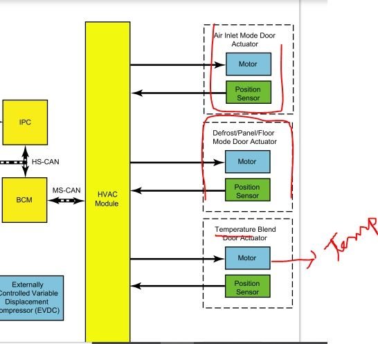

I believe the one you changed is wrong. However, not being there makes it hard for me to determine. Now, there is no self test that I can find available for this vehicle. However, I am attaching the air distribution description and operation. It discusses the two different types, manual and automatic. Take a look through it and see if there is anything that helps. As far as mode door actuators, there is one for fresh air or recirculate and one for the air flow direction.
________________________________________
2015 Ford Taurus AWD V6-3.5L
Air Distribution and Filtering
Vehicle Heating and Air Conditioning Description and Operation Components Air Distribution and Filtering
AIR DISTRIBUTION AND FILTERING
412-01 Climate Control 2015 Taurus
DESCRIPTION AND OPERATION
Air Distribution
NOTE: This vehicle is factory equipped with a cabin air filter.
There are 2 sources of air available to the air distribution system:
Outside air
Recirculated air
Recirculated air is always used when the HVAC module is set to the MAX A/C mode on vehicles equipped with Electronic Manual Temperature Control (EMTC) . Vehicles equipped with dual-zone Electronic Automatic Temperature Control (EATC) use recirculated air only when the RECIRC function is selected in any mode other than DEFROST, or when required by the HVAC module in the AUTOMATIC mode.
*****Air distribution within the vehicle is determined by the function selected ( EMTC ), or the dual-zone EATC system in the AUTOMATIC mode. The air distribution mode on vehicles equipped with dual-zone EATC can be overridden by the driver if desired. Airflow mode control doors are used to direct airflow within the heater core and evaporator core housing. Electric mode door actuators are used to position these airflow mode doors.
Vehicles equipped with dual-zone EATC use 2 separate temperature blend doors. This allows individual temperature settings to be selected for the RH and LH air outlets. The airflow mode doors are not partitioned for separate RH and LH airflow positions. Therefore, the airflow mode will always remain similar for the RH and LH sides of the vehicle regardless of the temperatures selected.
Air enters the passenger compartment from the:
instrument panel registers.
floor duct.
windshield defroster.
side window demisters.
rear footwell duct (if equipped).
Passenger compartment air is exhausted from the vehicle through open windows or body air vents located near the rear lamp assemblies.
Cabin Air Filter
NOTE: A cabin air filter must be installed for correct climate control system NVH performance.
The vehicle is factory equipped with a cabin air filter. The cabin air filter is positioned at the blower motor inlet and filters both fresh and recirculated air. The cabin air filter can be accessed though the glove compartment.
For cabin air filter maintenance intervals, refer to Section 100-03 .

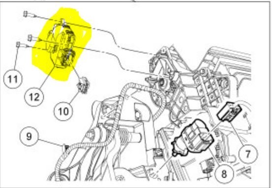

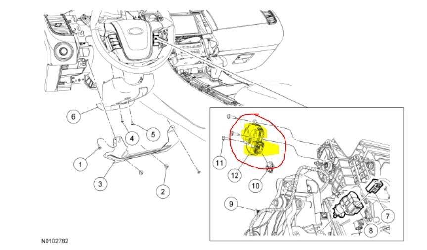

Take a look at the attached pic for mode doors.
Let me know what you find.
Jun 22, 2021 at 10:59 AM (Merged)
TIMEBREAKER101
  • 5 POSTS

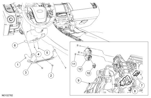

I got the dash and IPC, but could not see anything that resembles that part, most of it is covered. Is it above-beside the steering column and more than likely needs the air vents etc. removed to get to it or is it below the air vents and shouldn’t need to remove them? The driver side temperature is lower to the ground. Thank you
Have you removed the knee bolsters? Also, it should be up higher on the HVAC box. I feel really bad, but the pic I attached above is the best I have. It should be on the steering column side and about the same height.

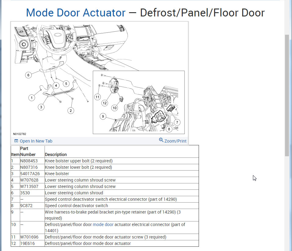

Welcome to 2CarPros.
The air flow directions is controlled by a component called a mode door actuator. When you select an air flow location, doors in the HVAC system change the direction of the air flow. Take a look through these two links:
https://www.2carpros.com/articles/low-or-no-air-flow-from-vents
Now I did a little research and found there are no technical service bulletins or recalls related to this problem. With that, I suspect the mode door actuator has failed.

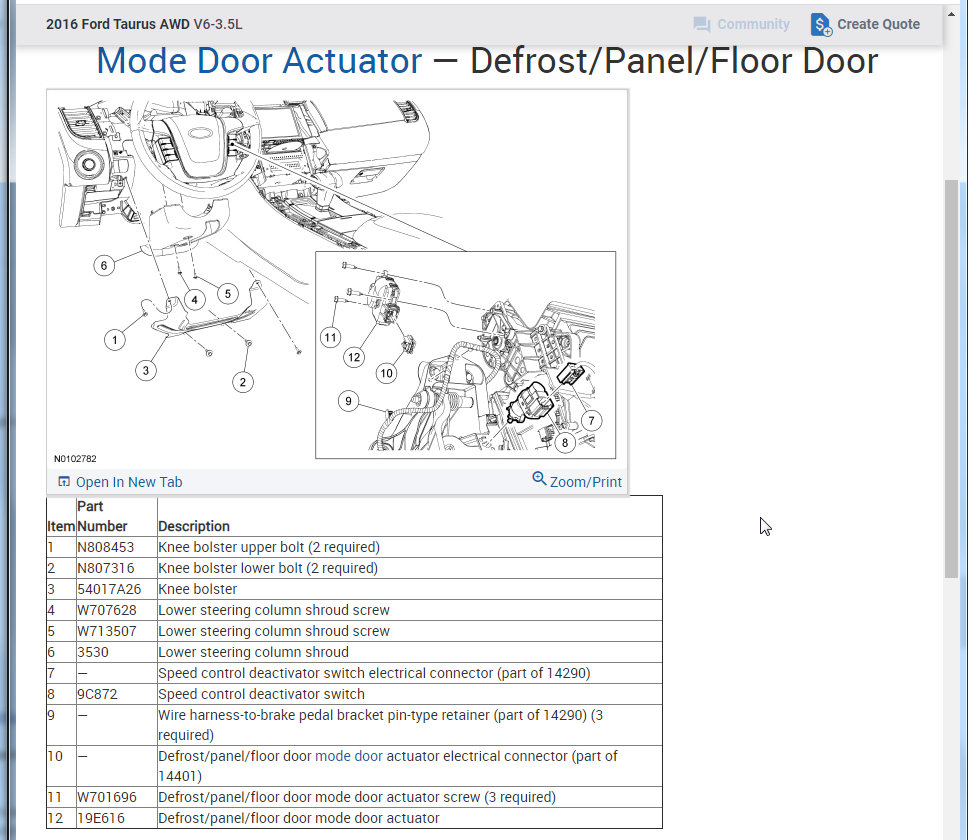

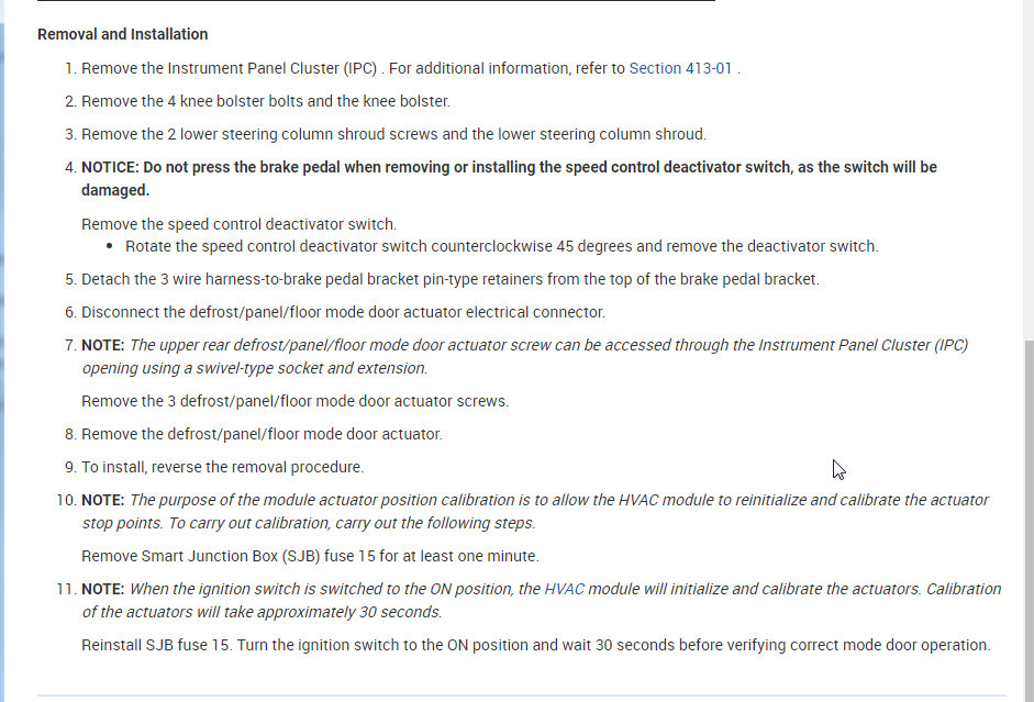

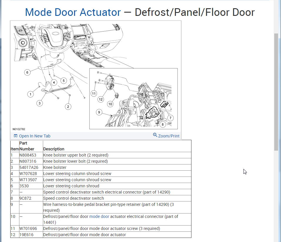

Here are the directions for replacement. It isn't the easiest job, but if you plan to do it yourself, if needed I will help you through it. The attached pictures correlate with the directions. In the last picture, picture 3, I highlighted the actuator.

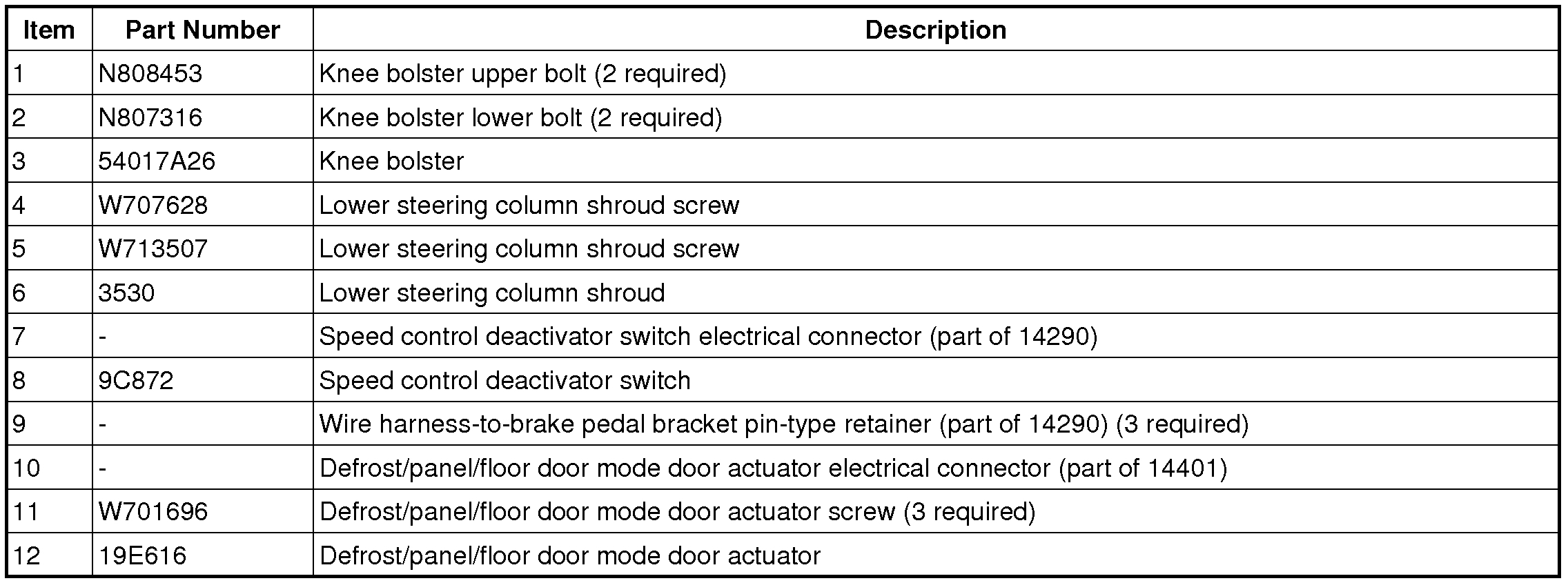

MODE DOOR ACTUATOR - DEFROST/PANEL/FLOOR DOOR
Mode Door Actuator - Defrost/Panel/Floor Door
pic 1
pic 2
1. Remove the Instrument Panel Cluster (IPC). For additional information, Refer to 413-01 .
2. Remove the 4 knee bolster bolts and the knee bolster.
3. Remove the 2 lower steering column shroud screws and the lower steering column shroud.
4. NOTICE: Do not press the brake pedal when removing or installing the speed control deactivator switch, as the switch will be damaged.
- Rotate the speed control deactivator switch counterclockwise 45 degrees and remove the deactivator switch.
5. Detach the 3 wire harness-to-brake pedal bracket pin-type retainers from the top of the brake pedal bracket.
6. Disconnect the defrost/panel/floor mode door actuator electrical connector.
7. NOTE: The upper rear defrost/panel/floor mode door actuator screw can be accessed through the Instrument Panel Cluster (IPC) opening using a swivel-type socket and extension.
8. Remove the defrost/panel/floor mode door actuator.
9. To install, reverse the removal procedure.
10. NOTE: The purpose of the module actuator position calibration is to allow the HVAC module to reinitialize and calibrate the actuator stop points. To carry out calibration, carry out the following steps.
11. NOTE: When the ignition switch is switched to the ON position, the HVAC module will initialize and calibrate the actuators. Calibration of the actuators will take approximately 30 seconds.
Reinstall SJB (Smart Junction Box) fuse 15. Turn the ignition switch to the ON position and wait 30 seconds before verifying correct mode door operation.

That’s what I was looking at but there is a large plastic divider blocking the whole side so I couldn’t see it. I figured by the picture it would be above the climate control and below the radio but couldn’t tell with everything being covered. Needing the car led me to reinstall everything, wish I had taken a picture though... all videos and advice for this is for the glove box one... need to make a video I guess lol. May go check junkyard to see if I can locate it on one that is salvage anyway for practice. Thank you for the assistance so far and will post pictures if I get any. Last question, I saw video where there was an actuator above the gas pedal. Are there 2 on the left and 2 on the right? (2 left ones are driver temp and air direction, 2 right ones are passenger temp and air recirculating) or does 1 actuator control both side temps making a total of 3 (2 right pass side and this 1 driver side?) hopefully that makes sense...

The only actuators are the ones I listed prior. I do believe there is one above the gas pedal. As far as the blend air door (temp) actuators, if you have dual zone HVAC, you will have two. As far as the mode door actuator, there should only be one. Then there is one for the fresh air / recirculate.

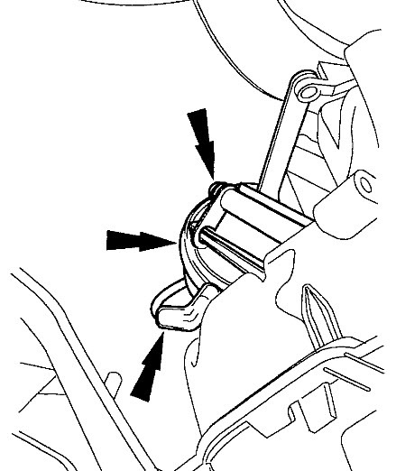

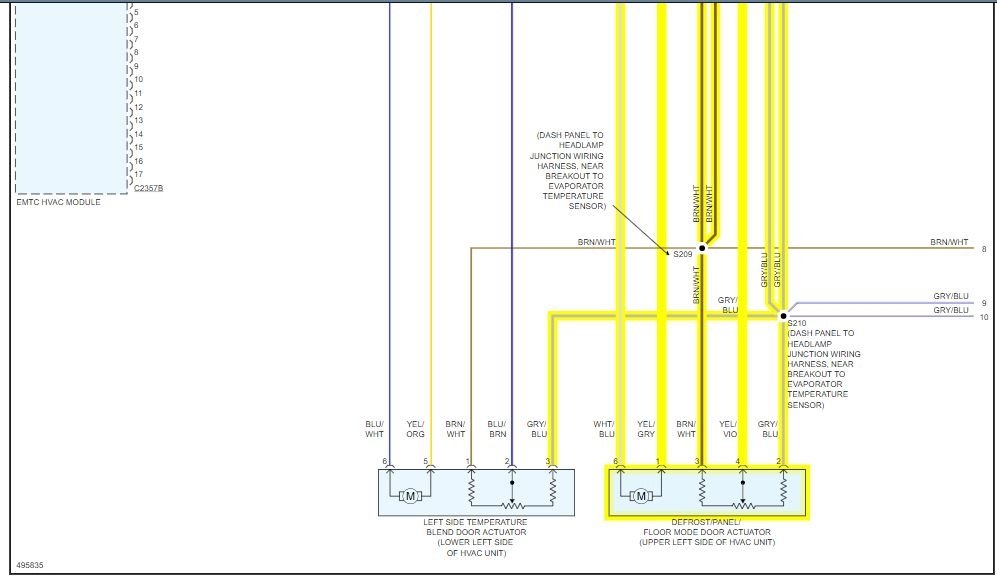

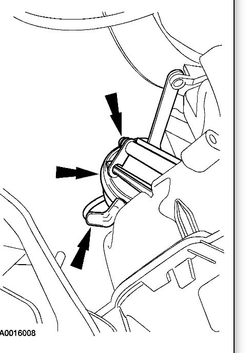

The mode door actuators are shown in the above picture. As far as the blend air door actuators, here are the directions with pictures of the locations:
Left side.
Change Vehicle Bookmarks Library Request Conversion Calculator Technician's Reference - Collision
air door
91
Community 9 Create Quote
2014 Ford Taurus FWD V6-3.5L
Temperature Blend Door Actuator - LH
Vehicle Heating and Air Conditioning Air Door Actuator / Motor Service and Repair Removal and Replacement Temperature Blend Door Actuator - LH
TEMPERATURE BLEND DOOR ACTUATOR - LH

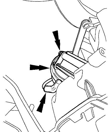

NOTE: The LH temperature blend door actuator can be accessed from below the LH side of the instrument panel.
1. Disconnect the LH temperature blend door actuator electrical connector, remove the 2 retainers and the LH temperature blend door actuator.
pic 1
2. To install, reverse the removal procedure.
3. NOTE: The purpose of the module actuator position calibration is to allow the HVAC module to reinitialize and calibrate the actuator stop points. To carry out calibration, carry out the following steps.
4. NOTE: When the ignition switch is switched to the ON position, the HVAC module will initialize and calibrate the actuators. Calibration of the actuators will take approximately 30 seconds.
Reinstall SJB (Smart Junction Box) fuse 15. Turn the ignition switch to the ON position and wait 30 seconds before verifying correct LH temperature blend door operation.
__________________________________________________
Temperature Blend Door Actuator - RH
1. Detach the glove compartment damper and lower the glove compartment.
pic 2
2. Working through the glove compartment opening, detach the instrument panel wire harness pin-type retainer from the heater core and evaporator core housing support.
pic 3
3. Remove the 2 RH temperature blend door actuator screws. Reposition the RH temperature blend door actuator to allow access to the electrical connector and disconnect the RH temperature blend door actuator electrical connector. Remove the RH temperature blend door actuator.
pic 4
4. To install, reverse the removal procedure.
5. NOTE: The purpose of the module actuator position calibration is to allow the HVAC module to reinitialize and calibrate the actuator stop points. To carry out calibration, carry out the following steps.
6. NOTE: When the ignition switch is switched to the ON position, the HVAC module will initialize and calibrate the actuators. Calibration of the actuators will take approximately 30 seconds.
Reinstall SJB (Smart Junction Box) fuse 15. Turn the ignition switch to the ON position and wait 30 seconds before verifying correct RH temperature blend door operation.

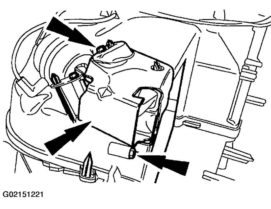

Mode Door Actuator - Air Inlet Door

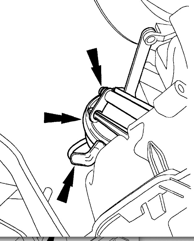

pic 5
2. Disconnect the air inlet door actuator electrical connector, remove the 2 retainers and the air inlet door actuator.
pic 6
3. To install, reverse the removal procedure.
Let me know if that helps.

There is a mode door actuator that controls this. It is above the fuel pedal and I attached a picture for you to view.
When you are done, remove the fuse for the A/C for 5 minutes.
Then reinstall and turn the key to on position and wait 5 minutes. The system will calibrate the actuators.
1. Remove the Instrument Panel Cluster (IPC). .
Jun 22, 2021 at 11:00 AM (Merged)
BBETNAR
Should there be two actuators on the drivers side? I have found one directly above the accelerator pedal,but after removing it and turning the door by hand it changed the air temperature on the drivers side.
Yes, there are 2. One for the blend door and one for the mode control. Look above it and toward the firewall.
Use a nice bright LED light to find it.

see if vacuum is going to motor in picture. it can be reached through driver's foot well. if it is the vacuum motor is bad, if not check for a vacuum leak at heater switch it may be leaking there.

No leak at heater switch, it appears to be no leak under the hood. I need a better pic of what the vacuum motor looks like. Pulled the radio again & new Acuator is doing what it is supposed to be doing. Question! If blend door is opening when turn controls from hot/cold, will it be quiet? I'm to the point where I feel that I'm going to have to sell a grandchild to get it fixed. Air is blowing cold, just need it to blow at me instead of front windshield. Perplexed in Houston, TX.
CJ MEDEVAC
  • 11,004 POSTS
Different feller
This may sorta be similar, had this pic on hand, I was not able to find yours, I dug, but not for more than 20 minutes
This on is for a VW
The Medic

No leak at heater switch, it appears to be no leak under the hood. I need a better picture of what the vacuum motor looks like. Pulled the radio again and new actuator is doing what it is supposed to be doing. Question? If blend door is opening when turn controls from hot/cold, will it be quiet? I am to the point where I feel that I am going to have to sell a grandchild to get it fixed. Air is blowing cold, just need it to blow at me instead of front windshield. Perplexed in Houston, TX.
HMAC300
  • 48,601 POSTS
the red arrow in picture shows what this looks like this is accessed through driver's foot-well. that means by the gas pedal. there is a shield that other arrows point to so it can be removed.
