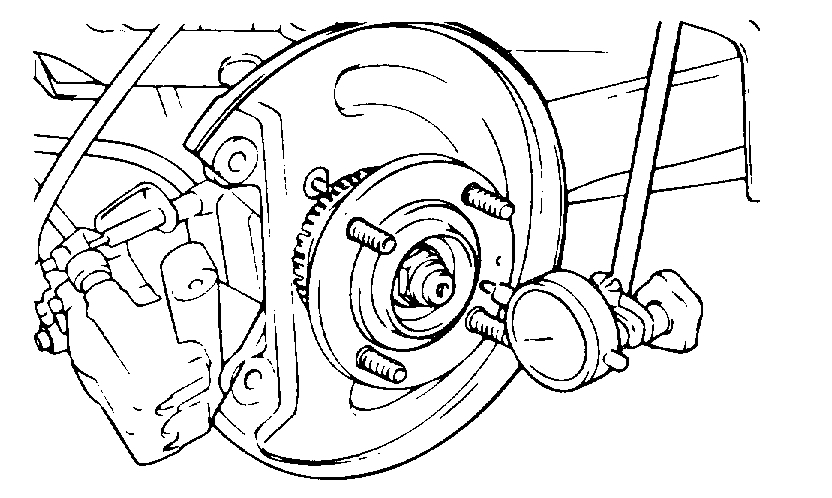

pic 1

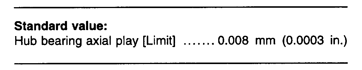

3. Check the bearing end play. Place a dial gauge against the hub surface, then move the hub in the axial direction and check whether or not there is end play.
Service limit mm (inch): 0.005 - 0.025 (0.0002 - 0.001 or less
4. If the end play exceeds the limit, the rear wheel bearing nut should be tightened to the specified torque and check the end play again.
5. Replace the rear hub bearing unit if an adjustment cannot be made to within the limit.

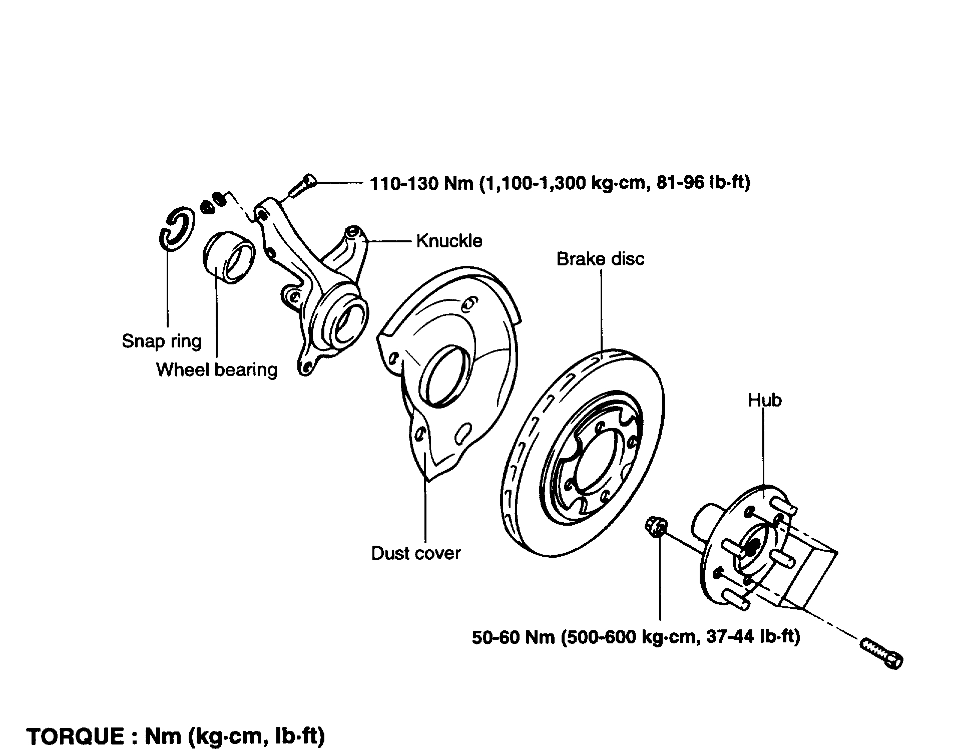

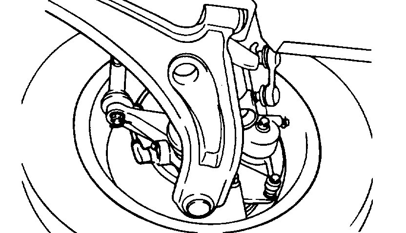

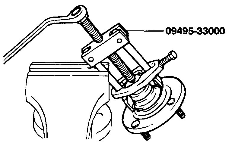

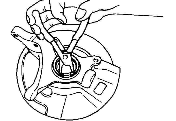

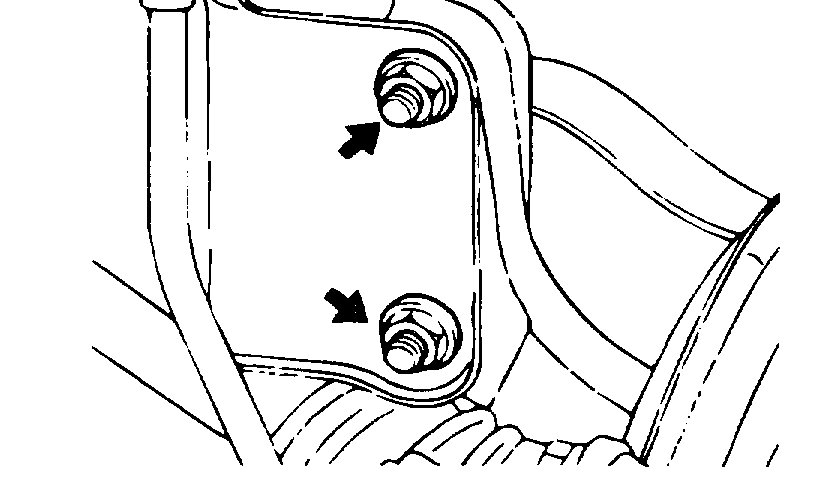

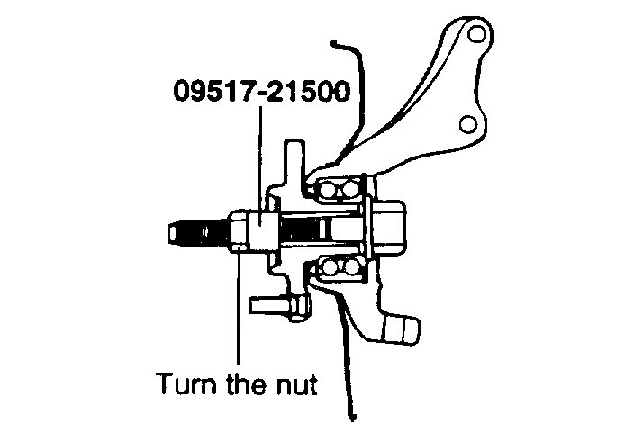

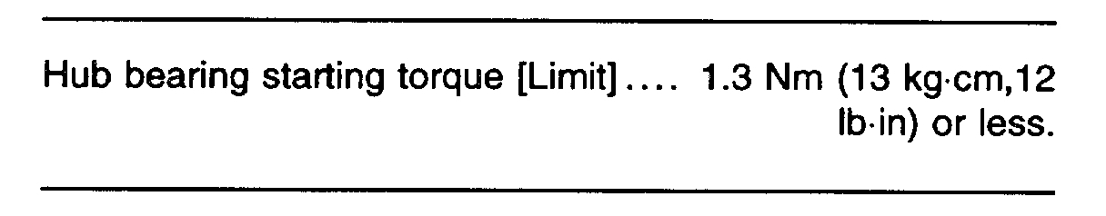

Chances are that is the problem. Here are the directions for replacement. The attached pics correlate with the directions.
___________________________________________
FRONT
pic 1
REMOVAL
1. Remove the wheel and tire.

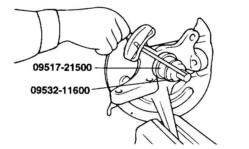

pic 2
2. Remove the drive shaft nut.
3. Remove the vehicle speed sensor from the axle assembly.
pic 3
4. Remove the front brake assembly from the knuckle and suspend with a wire.
NOTE: Brake hose does not need to be disconnected from brake caliper. Be careful not to depress brake pedal, or piston will pop out.

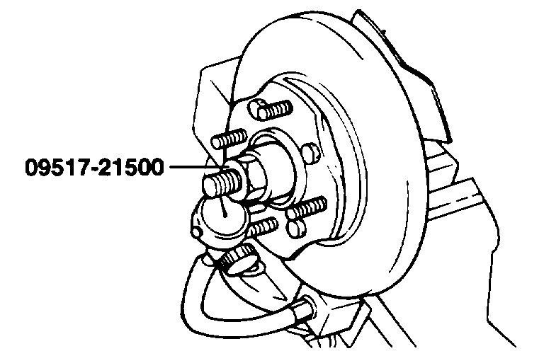

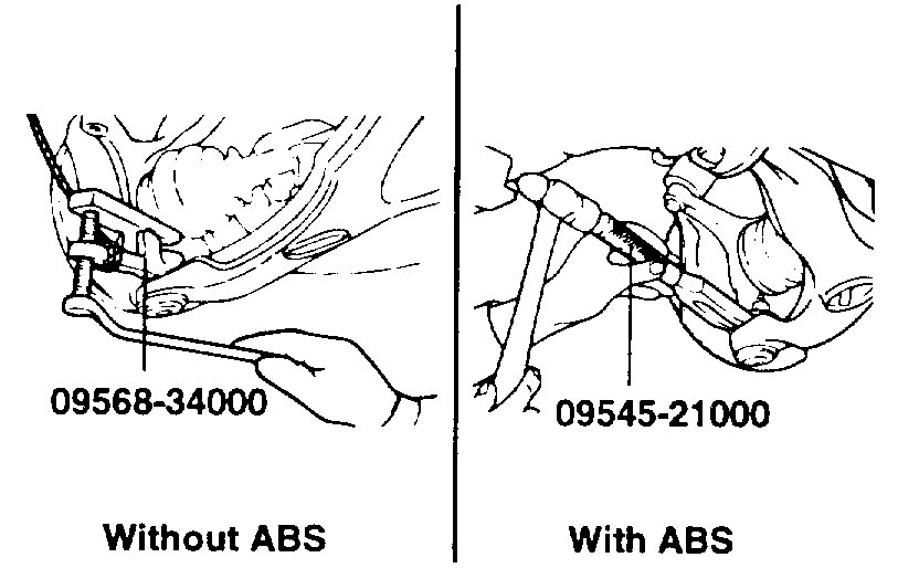

5. Disconnect the lower arm ball joint from the knuckle using the special tool.

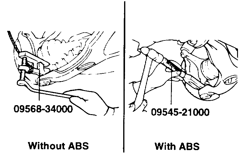

pic 4
6. Disconnect the tie rod and ball joint from the knuckle using the special tool.
NOTE:
1) Be sure to tie a cord to the special tool and to a nearby part.
2) Loosen the nut but do not remove it.

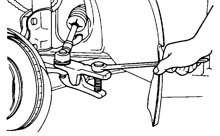

pic 5
7. Disconnect the drive shaft from the hub using the special tool.

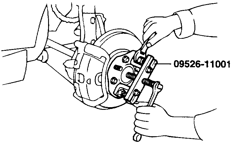

pic 6
8. Remove the hub and knuckle as an assembly from the strut.

DISASSEMBLY
pic 7
1. Remove the snap ring.

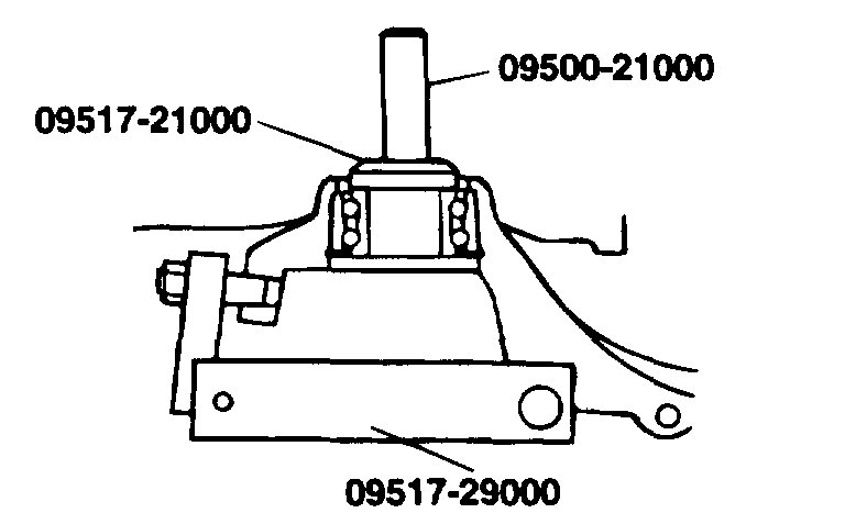

2. Attach the special tools to the knuckle and hub.
3. Secure the knuckle in a vise.
4. Tighten the nut of the special tool and remove the hub from the knuckle.
NOTE: When removing wheel hub or wheel bearing from knuckle, replace wheel bearing assembly (outer race, inner races and grease seals) with a new one.

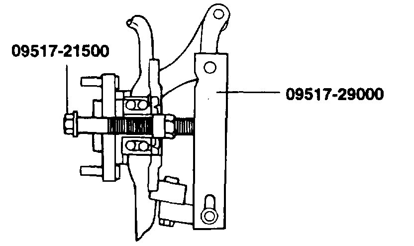

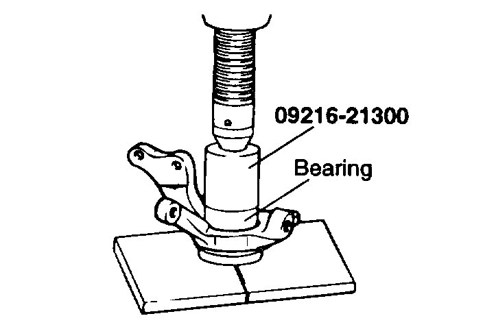

pic 11
3. Press-in the bearing by using the special tool.

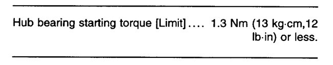

5. Measure the hub bearing starting torque.
pic 15

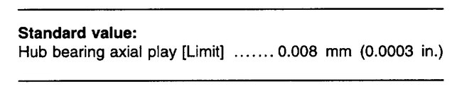

6. If the starting torque is 0 Nm (0 inch lbs.), measure the hub bearing axial play.
pic 16
7. If the hub axial play exceeds the limit while the nut is tightened to 200 - 260 Nm (2,000 - 2,600 kg-cm, 148 - 192 ft. lbs.), the bearing, hub and knuckle have not been install correctly.
