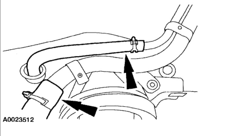

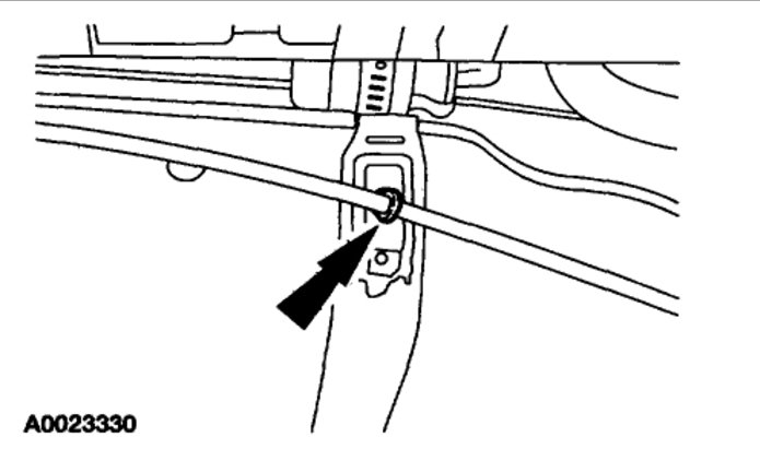

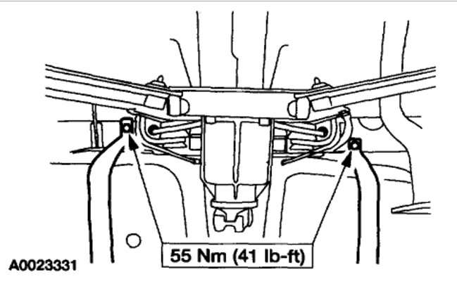

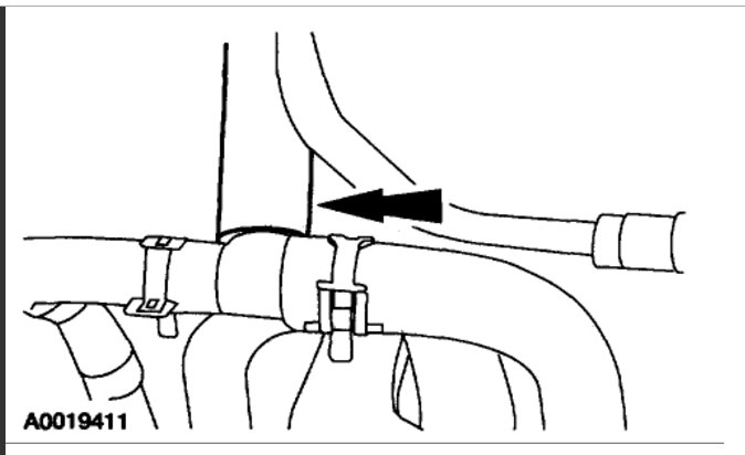

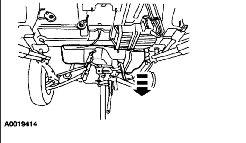

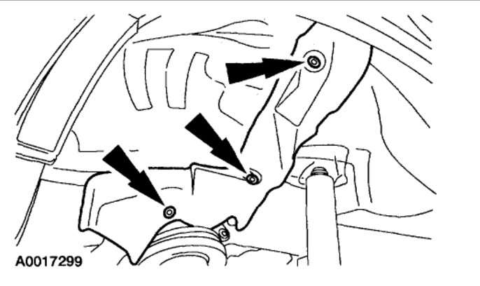

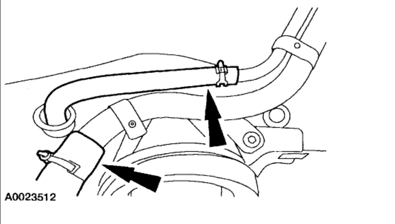

This is a common problem when the fuel pump is starting to go out.
Here is a guide and some diagrams (below) that will show you what is needed to replace the fuel pump:
Here is a video of the job being done on a similar car:
https://youtu.be/D1AyqeftAmA
Here is what you need to do on your car:

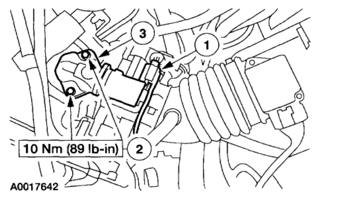

I have seen this problem before its the idle air control valve making it stall at idle and it is making the noise.
Here is a guide that will help.
https://www.2carpros.com/articles/how-to-replace-an-idle-speed-control-motor-iac
