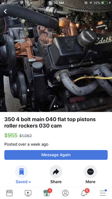

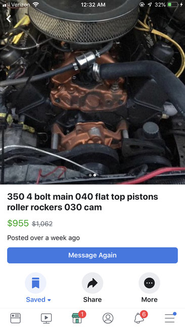

That is good. Can you snap a picture of the engine for me to view?
Dec 3, 2018 at 4:18 AM
DALTON SIGMON
MEMBER
33 POSTS
There is two.
Dec 3, 2018 at 4:25 AM
CERTIFIED EXPERT
52,796 POSTS
It looks good. The fact that it is black tells me it is a GM target motor.

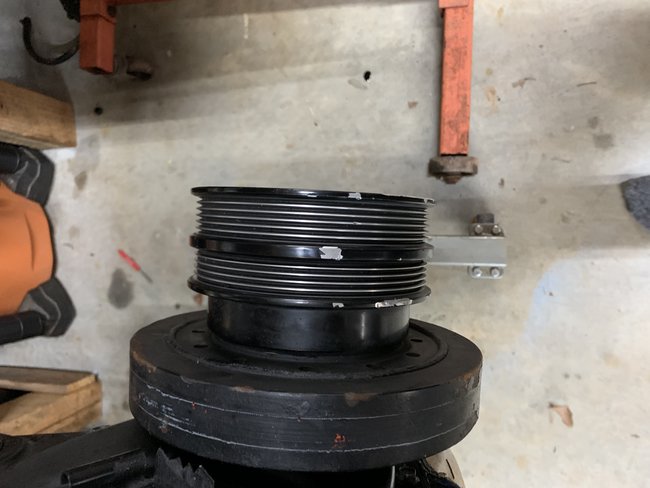

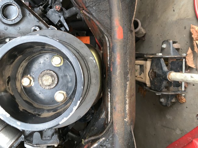

As you can see this engine has a double groove pulley, does that mean it came out of a vehicle with power steering, and if so what all do I need to put power steering on it
Image (Click to enlarge)
Jan 27, 2019 at 10:43 AM
CERTIFIED EXPERT
52,796 POSTS
No, not at all. You can leave it like this and just not use that part of the pulley.

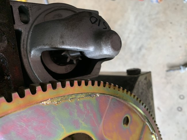

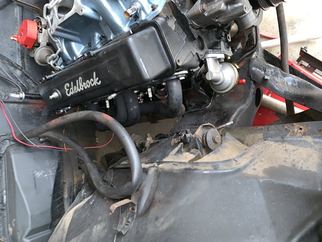

I’m pretty sure I need to buy a bigger flex plate ,but was just going to make sure if this one would work or not because I have searched everywhere and I can’t find a perfect fit.
Feb 6, 2019 at 12:38 PM
CERTIFIED EXPERT
52,796 POSTS
What about the old one on the old engine?
Feb 6, 2019 at 1:44 PM
DALTON SIGMON
MEMBER
33 POSTS
Too small.

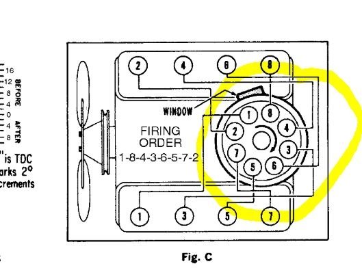

How do I set the park plugs?
Feb 9, 2019 at 1:24 PM
DALTON SIGMON
MEMBER
33 POSTS
The wires specifically.
CERTIFIED EXPERT
52,796 POSTS
The plugs gt gaped at .035. Use a spark plug gapper.
Wires and the cap setting attached.

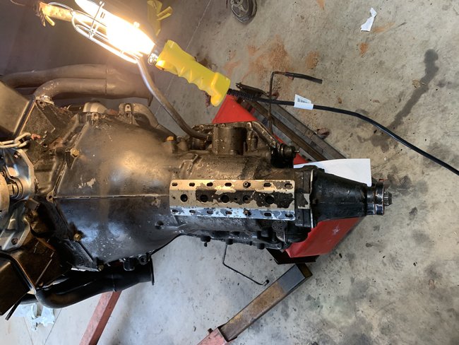

Might be a long shot but I’m putting this 350 turbo transmission on but don’t know anything about the linkages. is there anything I need to buy new? not sure what the old transmission was but I know the dipstick doesn’t fit.
Feb 9, 2019 at 2:34 PM
CERTIFIED EXPERT
52,796 POSTS
You had a powerglide.
You now have the turbo 350.
You need the correct dipstick for that transmission.

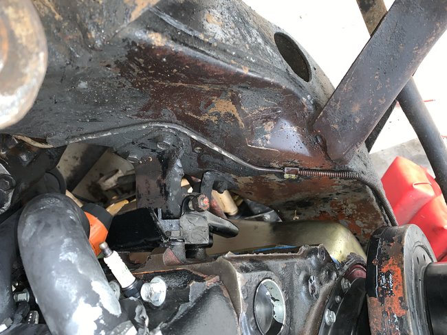

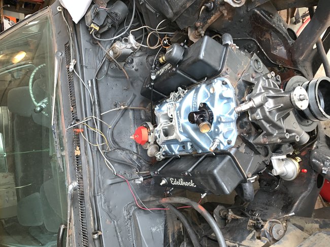

I don’t think it’s just me but it looks as if my engine is sitting too low, what should I do about this?
