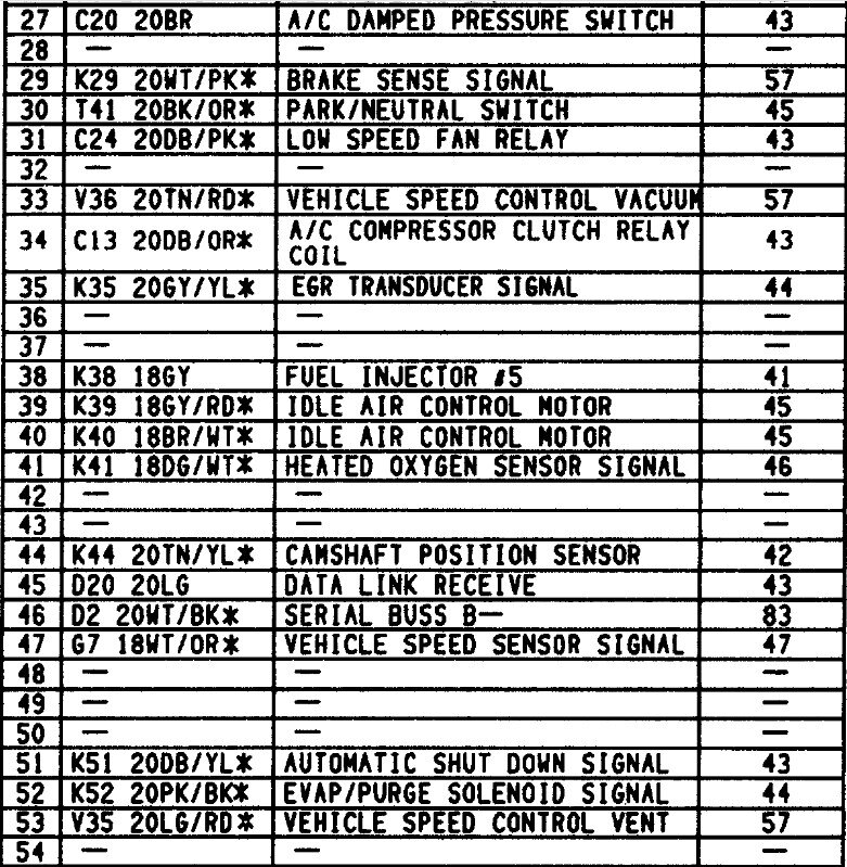

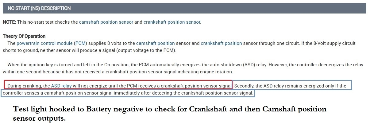

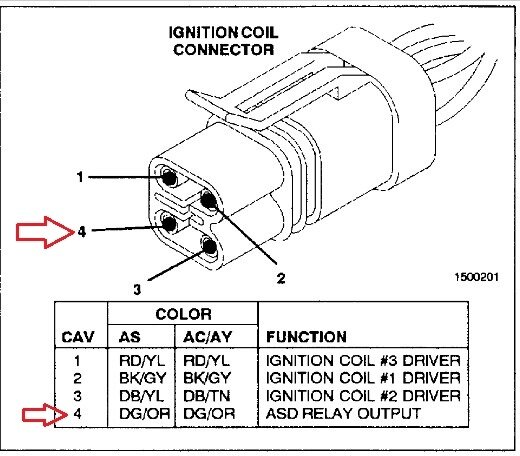

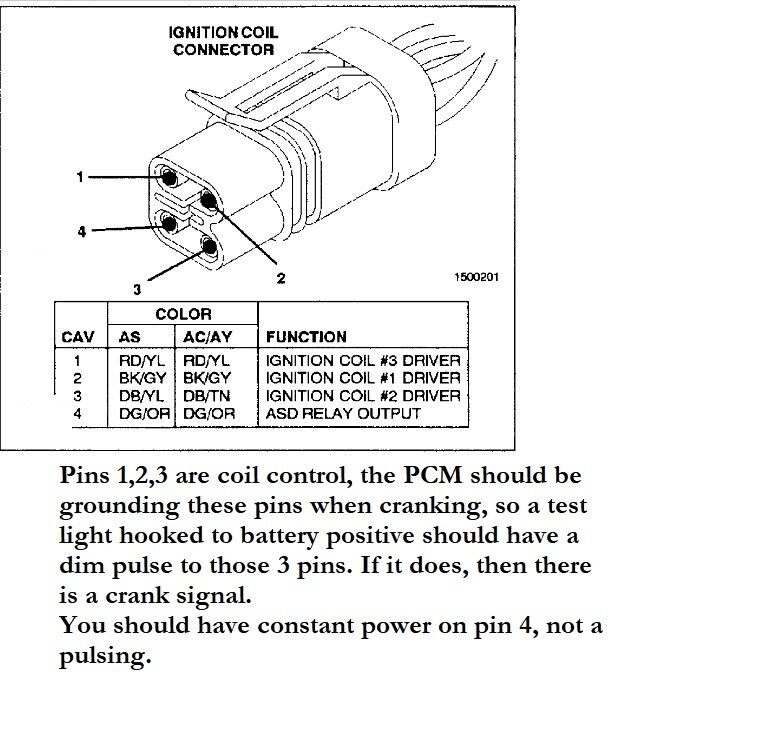

Heres the testing of the cam and crankshaft position sensors using a test light and the ignition coil power feed, if you dont want to check for spark, theyre having you check for power remaining on the coil power wire while cranking, if theres no crank or cam signal the power will shut off from the coil, because the PCM will power down the ASD relay if it doesnt see both cam and crank signals, or just watch the video below and check for spark,
Watch this video, go right to 9min 35seconds in the video, he does a spark check using a test light to check that the coil has good output.

Okay, so, i did this test. the test light flashed once when the key was turned on. when cranking it over it was flashing. then i disconnected the camshaft sensor i checked it for voltage. It had 8 volts. then tried cranking it over again. the test light didn't do anything i tried to check it for codes again and my scanner didn't show any fault codes.

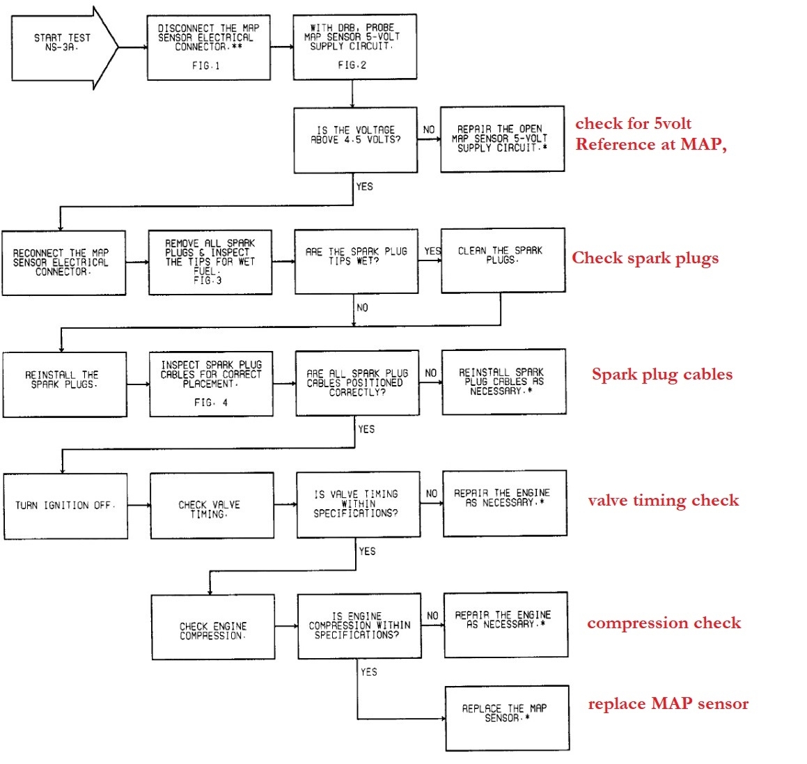

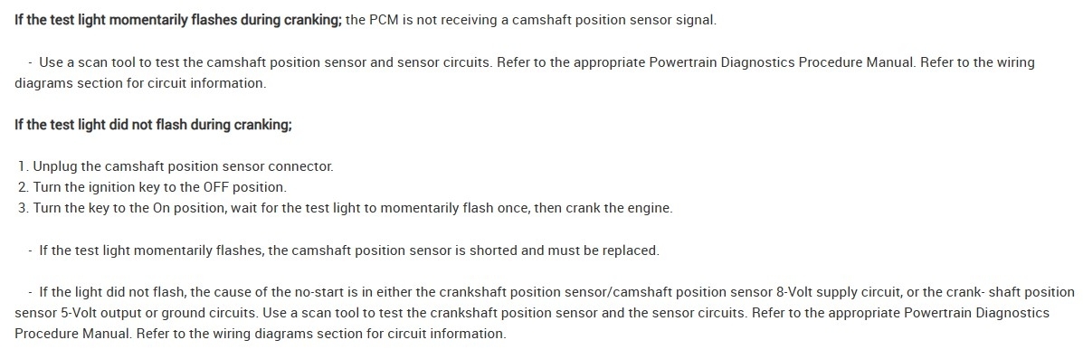

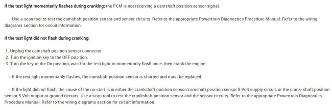

So, since your test results are kind of reverse of what they are stating here, they are saying you will only get the one second power on for the ASD circuit if there are no cam/crank signals. And then it should only be a momentary flash. Then the PCM de-energizes the ASD circuit due to no cam/crank signals,
If we were to follow the flow chart here, with the cam sensor unplugged and not flashing of the ASD power feed, their diagnosis is a bad cam or crank position sensor. Or the signal for those sensors is not making it all the way to the PCM, at this point, you can try replacing those sensors.

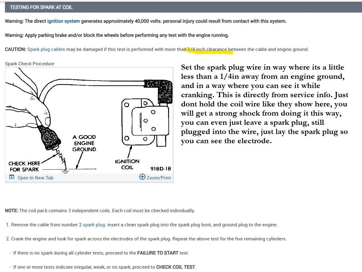

But you really should check for spark here, you're not going to hurt the PCM, we check spark all the time, whether you use a spark check tool or a test light it doesn't matter, we need to know if the coil is outputting any spark.
I've added the spark check from service info as well, since the spark plugs are coming out wet with fuel, it sounds like the injectors are firing, check the oil too, see if it smells like there's gas it in, it's probably completely contaminated with fuel by now.
You can see in the video I posted of him checking for spark with a test light, he is a teacher at a college, teaching automotive diagnostic testing and one of the best. He wouldn't be checking spark like that if it wasn't safe for the PCM. I do the same testing as well. Since the crank and cam shaft position sensor signals are only a 5-volt output, you won't be able to see it with a test light. You need an oscilloscope to see those signals.

Okay, A, l i checked for spark and i was getting spark. did i see somewhere its supposed to be blue ? is that for every make and model ?and i checked for compression on the front 3 cylinders. it was 150-160lbs it would of been higher if i could tighten the fitting more but i couldnt get a wrench in there to tighten it. so i dont have a wiring diagram for the cam and crank circuit. so how can i figure out if the voltage goes to the crank sensor first before going to the cam sensor. the instructions didnt say i should disconnect the crank sensor at all and check it. so?

Did you have spark on the front 3 spark plug wires and did it jump at least 1/4in?

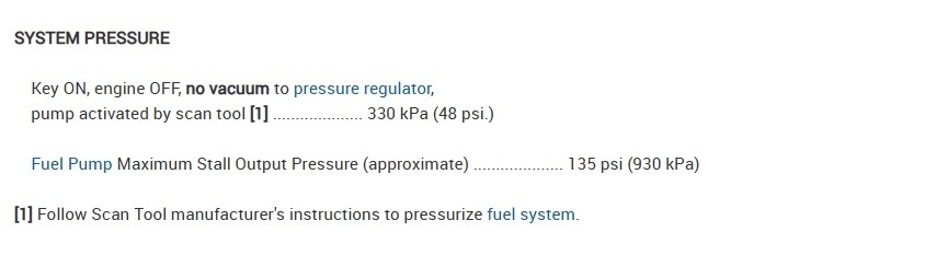

You have spark, you said you had an injector pulse, your fuel pressure is low (should be at least 48psi), you mentioned it might have bad gas, you have plenty of compression, so either something was missed or the exhaust is restricted.

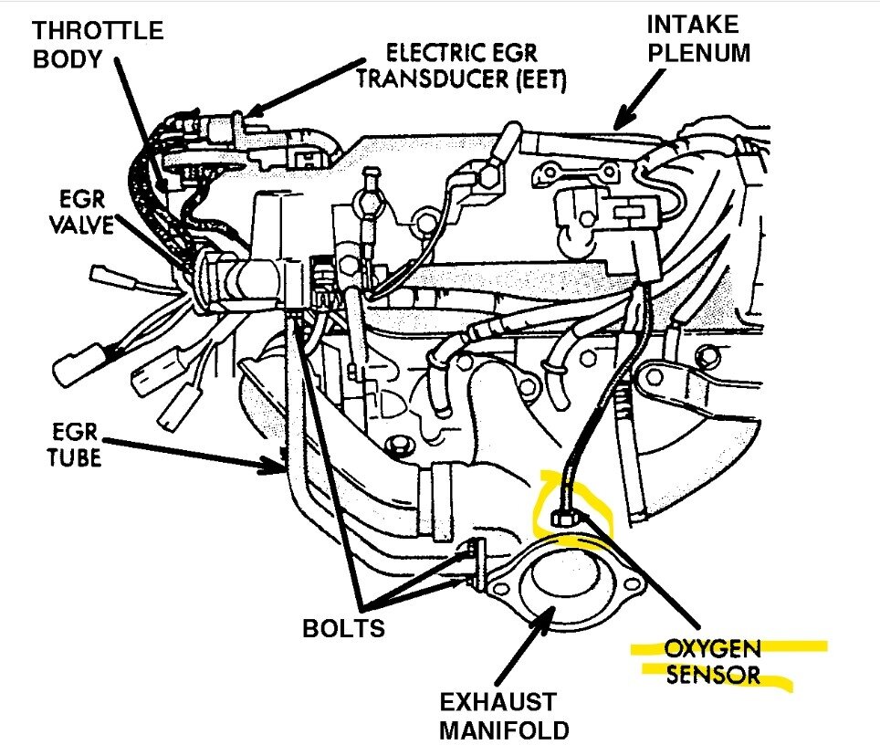

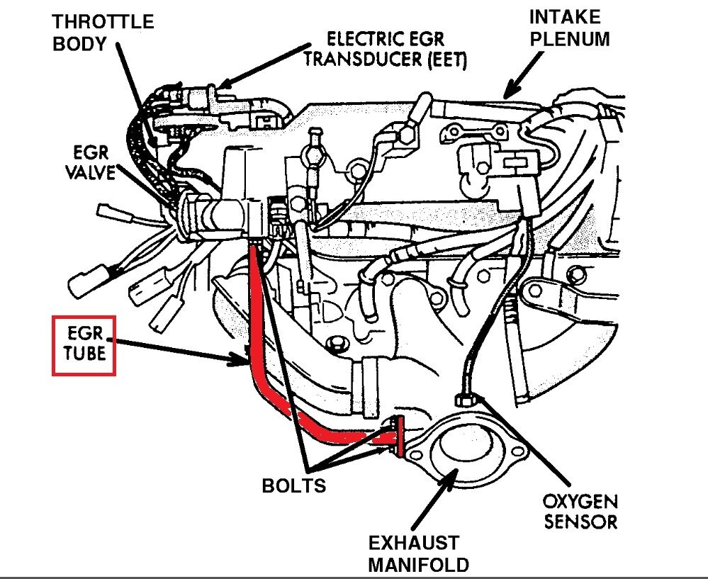

It looks like this vehicle only has one Oxygen sensor in front of the Catalytic Converter, on the back of the engine where the two exhaust manifolds meet and there is the one exhaust pipe going to the Converter.
To check for a Failed Cat, you would need either unbolt the front of the Cat to allow exhaust to escape or to remove the Oxygen sensor and crank the engine, with the sensor removed it also gives the exhaust a place to escape and the engine should try to start.

In the diagram it shows where the front Oxygen sensor is located on the back of the engine. Hopefully it comes out easy, but dont force it or you'll stripe the threads out.
You could even check back pressure at the EGR tube coming off the exhaust pipe if its before the Cat, that might be easier, just do not leave the gauge on there long, I have seen people melt the hose and gauge from leaving it on the exhaust too long, but this is a no start condition so you should be ok. I marked the EGR tube in red on the 2nd diagram, if you cant remove the Oxygen sensor, or unbolt the exhaust at the manifold here, the EGR tube would be much easier to get to.

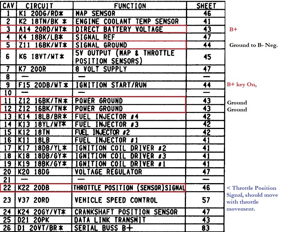

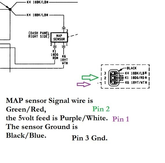

You also mentioned the MAP sensor was not properly installed at one point, I assume you got that put in correctly, I would be curious to see what the MAP sensor signal does during cranking. The engine should produce some vacuum during cranking so the MAP sensor voltage signal should drop somewhat during cranking, Lets check that as well since we are checking everything else.
The Signal wire is Green/Red pin 2(middle pin), the 5volt feed is Purple/White Pin1,
and sensor Ground is Black/Blue pin 3.
Signal should be near 4.5volts key On, and drop a little while cranking.
This is the MAP sensor flow chart if you have good spark, good fuel pressure, good compression and timing, and a 5volt feed to the MAP sensor, they have just replace it.
Which Im not against at this point, starting to change some parts is not the correct way, but we have been at this too long,

oh i forgot the flow chart says check timing ? how am i supposed to do that ? 3.3

Okay, the reason you didn't see any power to the coil with the cam sensor unplugged is because the PCM will de-energize the ASD relay if it does not see a cam signal directly after the crank signal, so that means that those signals are okay, and all the more so since you have replaced the sensors already. Having to pump the gas pedal to keep it running or try to run, it sounds like you are running out of fuel.

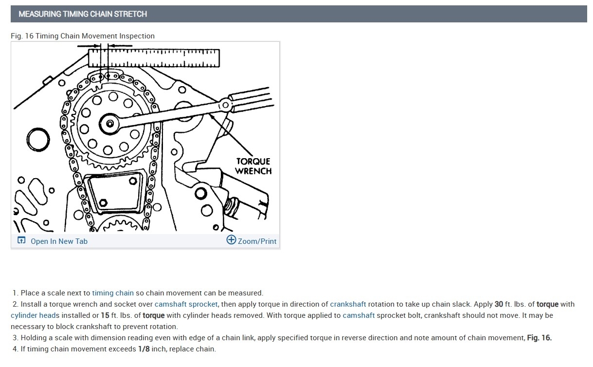

The timing chain could be stretched, but to check it you need to pull everything apart and get all the way down to the timing chain itself. You would have to pull the timing cover; this is what they want you to do to measure the timing chain stretch (diagram 1 below). You might as well just replace the engine if you're going to go this far, because the engine is old and has high mileage.

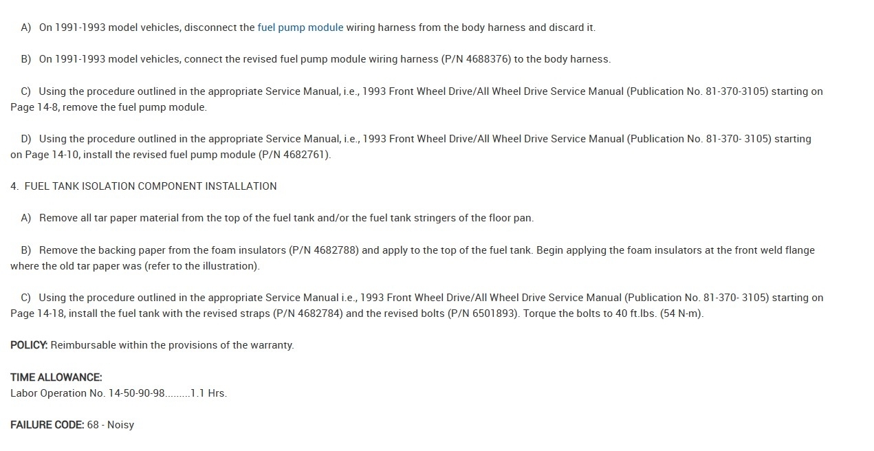

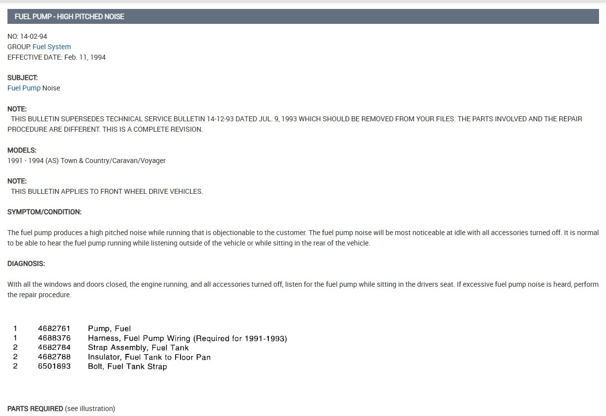

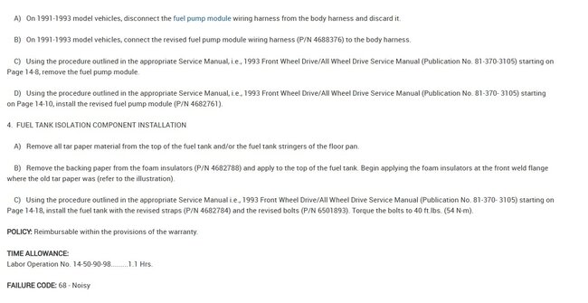

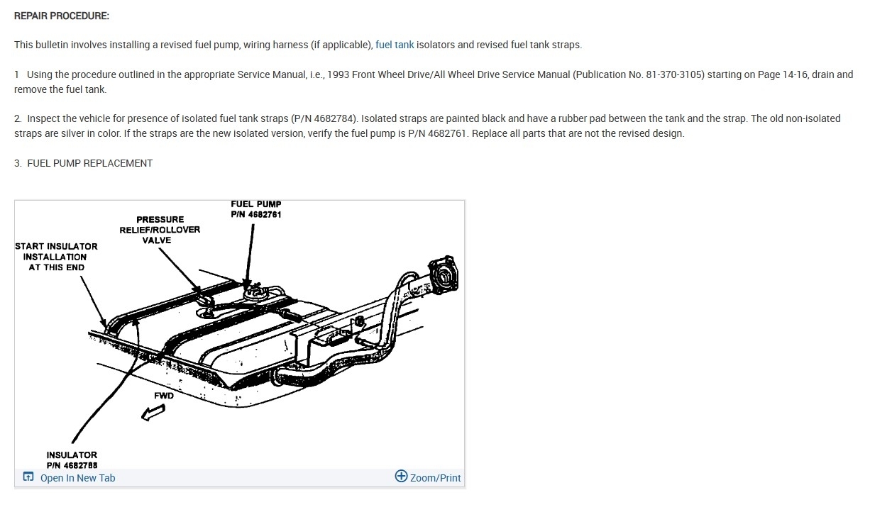

Looking through all the technical service bulletins, there is an old one for a revised fuel pump along with fuel tank straps. Looks like a high pitch noise can be heard from the pump in some cases.

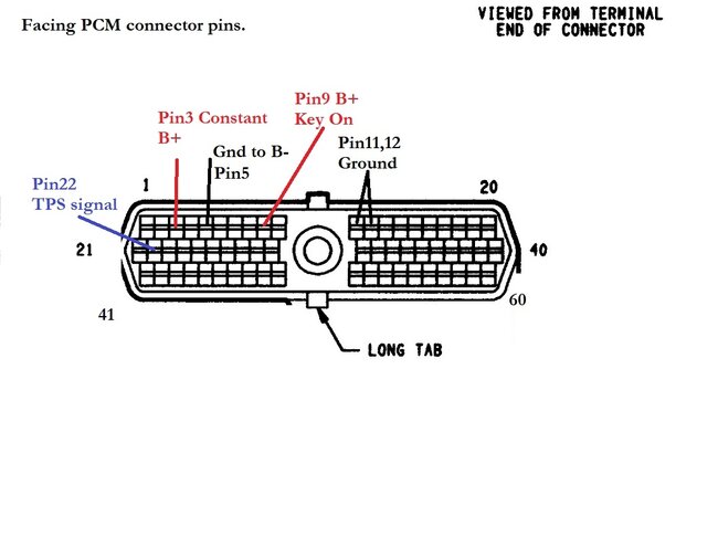

Do a couple other checks with your multimeter set on DC volts, with the key On, check the voltage level from Battery Negative to the engine block, and then Battery Negative to the Body/Frame, it should read close to zero volts, this test really should be done running, but with the key On, if there's excessive voltage drop to the battery you should see something above 1 volt.

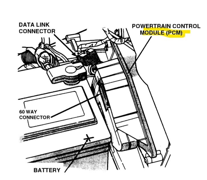

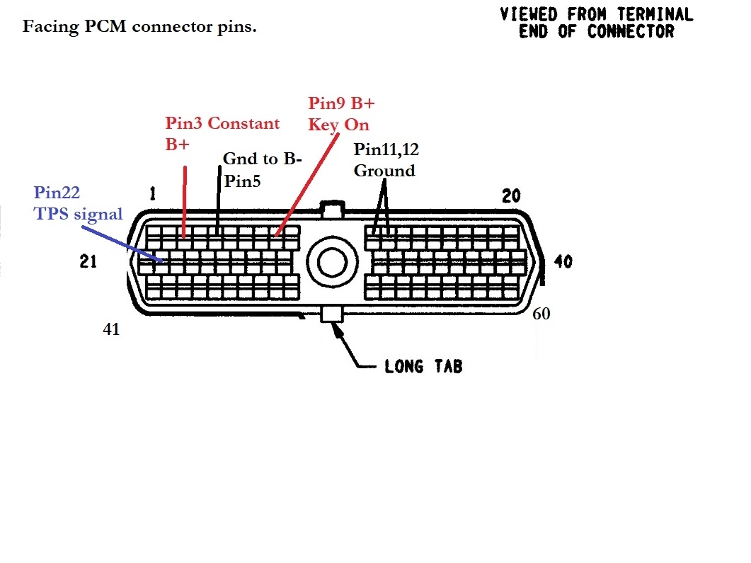

I see the PCM is right next to the Battery here. If you want to check the PCM connector for any corrosion or pin issues, here's the pinout for that if necessary. Just things to check,

Okay, i checked the map sensor again 5 volts before then cranking no change in voltage it stayed constant. and no i didnt get gas any where different. you didnt comment on the blue spark ? though on back pressure in exhaust even with the bad donut ring. thanks

i checked fuel pressure again. i don't get it this time, it was about 20lbs with key on and when cranking it went to about 50lbs. and i did a ground check from battery ground to engine block it didn't show any drain.

If the spark is jumping 1/4in that should be fine, are you checking the MAP sensor signal wire, not the 5volt feed. You should see a lower number than 5 volts on the signal wire, even at key On, it should be lower than 5volts, 4.5v range. And the fuel pressure is an issue, if there are sections of the windings on the fuel pump that are bad, then the pump is not putting out what it should be, or you have a wiring issue to it. It should go right to at least 48 PSI with the 2 second key on prime, not 20 PSI.
The MAP signal wire is the center wire on the connector, green/red wire. Pin 1 should be the 5volt feed, Violet/White (purple/white). The last wire should be the sensor ground, black/blue wire. If the signal wire is not changing at all when cranking, that's also an issue.
That means there is no pressure changing in the intake manifold during cranking, you should be able to put a vacuum gauge on the intake and see a change during cranking, but a clogged cat will affect that reading too. If nothing is going out the exhaust no air can come into the engine. So, you either have multiple issues going on or a bad wiring problem. You should see around 5in Hg of vacuum during cranking with a vacuum gauge on the intake.
