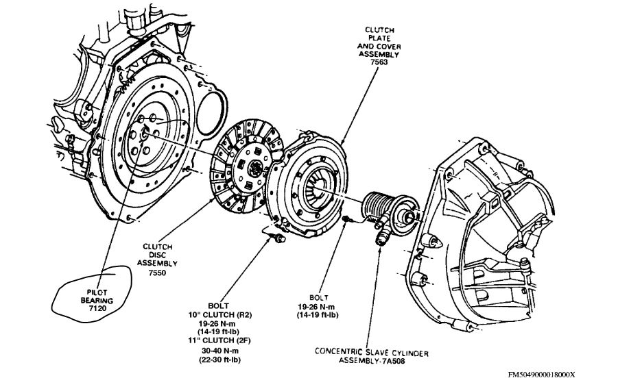

1987 Ford F150 straight 6 blown engine so I bought a 1995 Ford F150 straight 6 for the engine. mine was a automatic the new engine was a stick shift. what do I need to make the new engine connect with the new engine block? please help
Feb 9, 2021 at 2:29 PM
(Merged)
Good morning,
When you remove the donor engine, you will need to remove the clutch and flywheel. Then the pilot bushing inside the crank has to be removed as well. Then you can bolt up the automatic flywheel from your engine to the donor motor.
