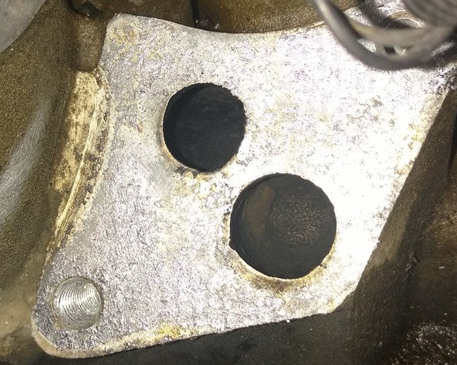

Mar 28, 2018 at 1:04 PM
yes, once you remove the EGR then you need to clean the passage to the exhaust manifold from the EGR port.
can you post a picture of what you see?
Mar 28, 2018 at 1:08 PM
TMINER
  • 49 POSTS
Here is the EGR ports. Which hole do I clean out with a cable, etc? I cannot see the hole in the throttle body yet. Is a speedometer cable best to use in a drill?
Mar 28, 2018 at 4:54 PM
Both holes, they are completely clogged.
Mar 28, 2018 at 10:59 PM
TMINER
  • 49 POSTS
I've done some "drilling" with a speedometer cable on both sides but when running truck with no EGR it will run rough like it's going to die then come up in rpm and keep cycling like that. It does seem slightly louder now but I think there's still gunk in both the intake and exhaust valve of the engine EGR ports. I may need some more tips to get the carbon out. I still can't see where the carbon is in throttle body.
