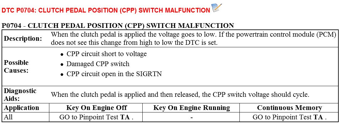

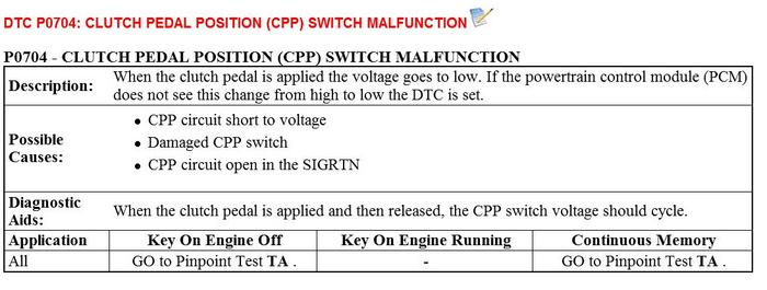

finally had scan and the code is po704. Now this is a sensor, what does it do, where is located, and what would be the cost?
